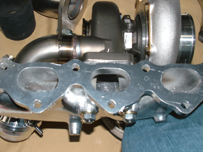

Here is a pic of inside the manifold that comes with the kit. Install is a bit slow since its the weekend And as we all know when they say its "bolt on", is bit of a misnomer. That being said its going fine. I would expect to see this car out next weekend at the track. I'll be posting pics in here periodically.

Nice looking set up. That radiator is NICE looking too..
