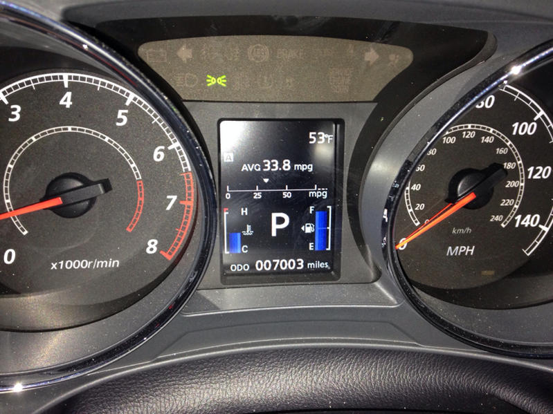

The trick with the shifters is to feather off the throttle as you approach your target speed. MPG will drop but less than you see. Mistu's fuel computers aren't great so your MPG loss is less than displayed. You can make the loss up in a few miles.
You really have to wait it out. The car WILL come around at an arbitrary mileage between 3500 and 7000. Mine gave me good MPGs once or twice but now I'm consistent at 28 to 30. The photo attached is my drive home yesterday. 33.8 when the car is templated for 29 highway. As you see I just broke 7K but my CVT is much smoother and the shifting is better. It will break in when it wants to. Give it time.

WTF!!?? How is this possible? You are like the 97th person I have seen get MPG like that. I am a veteran high MPG driver. I consider myself a hypermilling master. I had the first Honda Insight (AVG 58.2 MPG) and the new Honda Insight (AVG 52.1 MPG). I am very familiar with how to drive to get great MPG. The highest I have gotten in this car is 25. Is there something wrong? I never go into AWD. I use 87 octane. I have 37k miles now. Area is pretty much all level. Driving steady 65mph, instant MPG is around 27. It does go up to 33 but I think of touching the accelerator and it drops to 22. Is my CVT screwed? Aside from it being noisy and having a mind of its own, it appears to drive OK.

Don't go over 55 for highway and don't stay near 2,000 rpm for too long when gaining speed. Sometimes staying by 2k rpm is worse than going up to almost 3k rpm to get to speed.

The CVT is a whole different animal. It really takes some fineness to start seeing MPG gains
