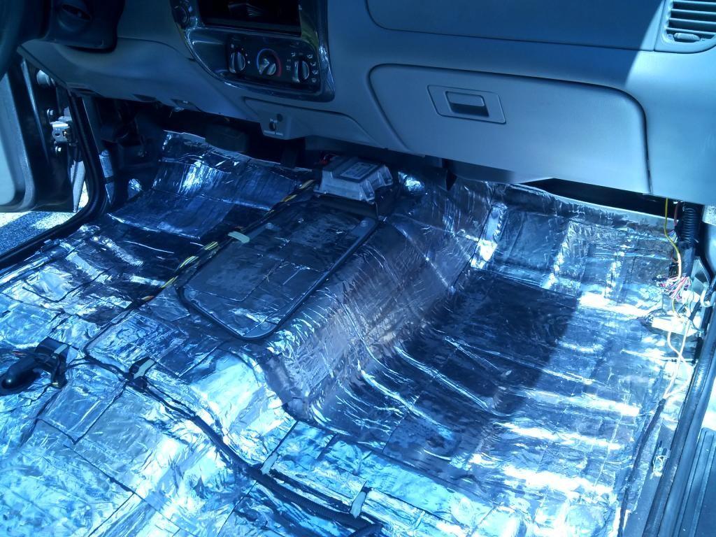

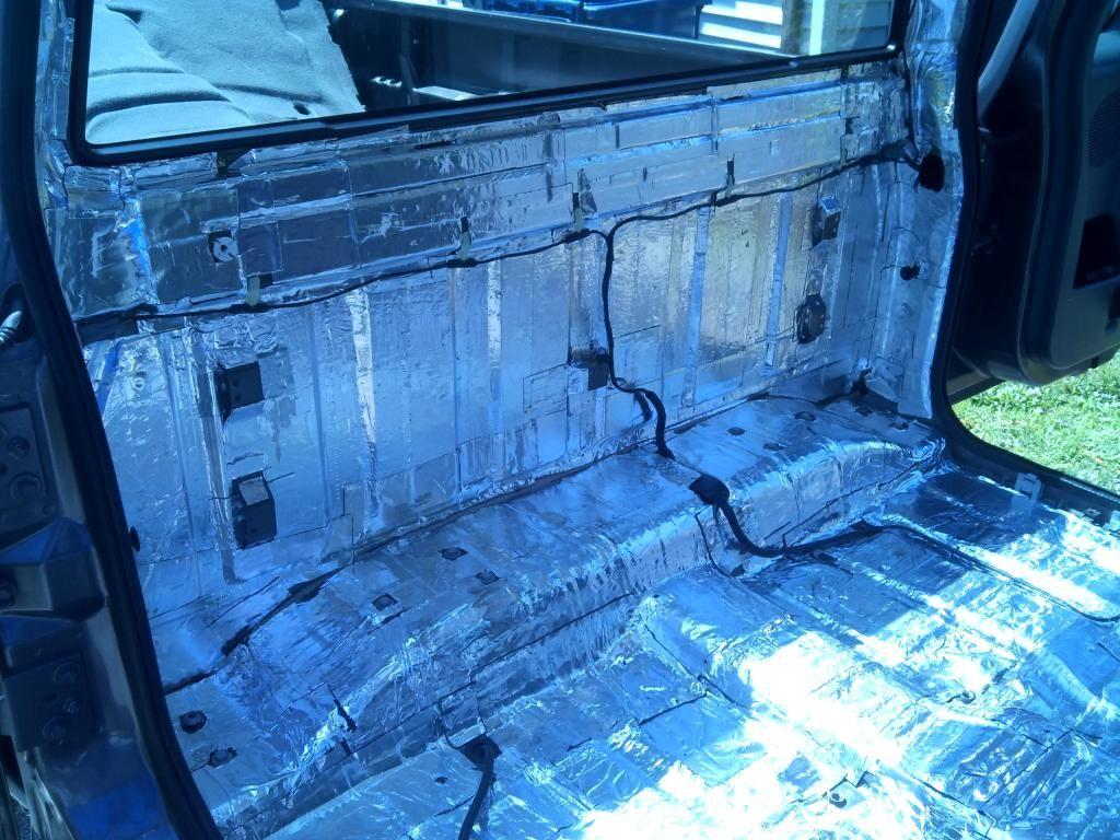

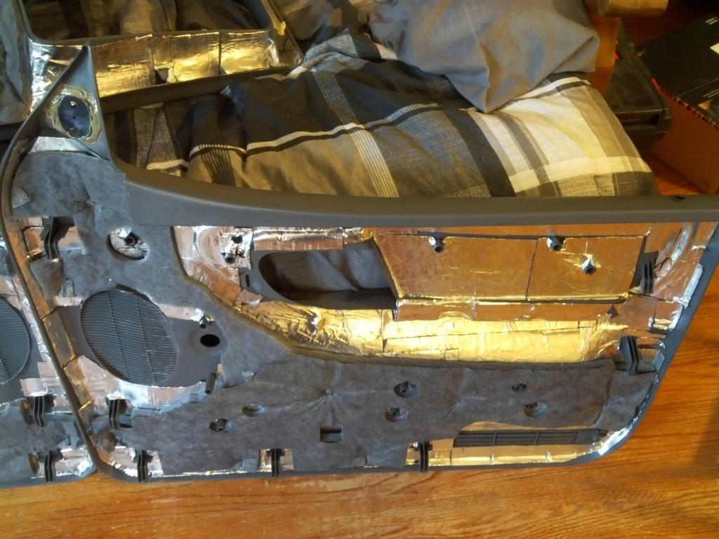

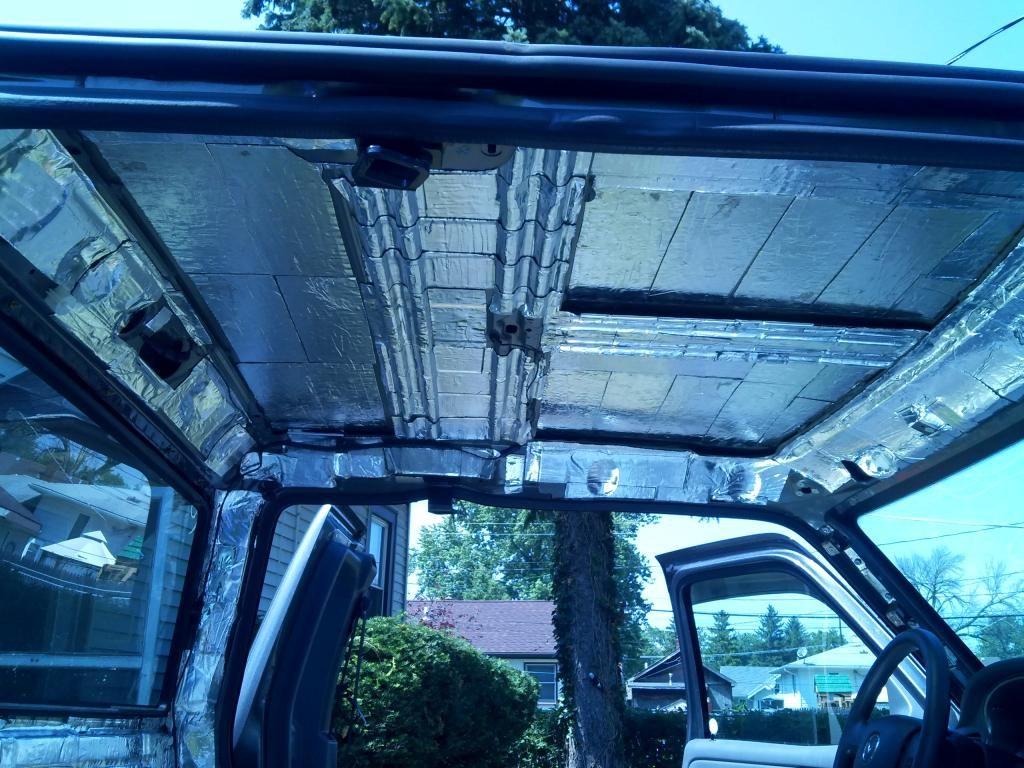

I have stripped entire interiors, multiple times - and dynamatted everything... anytime I do a big soundsystem this is my standard process...

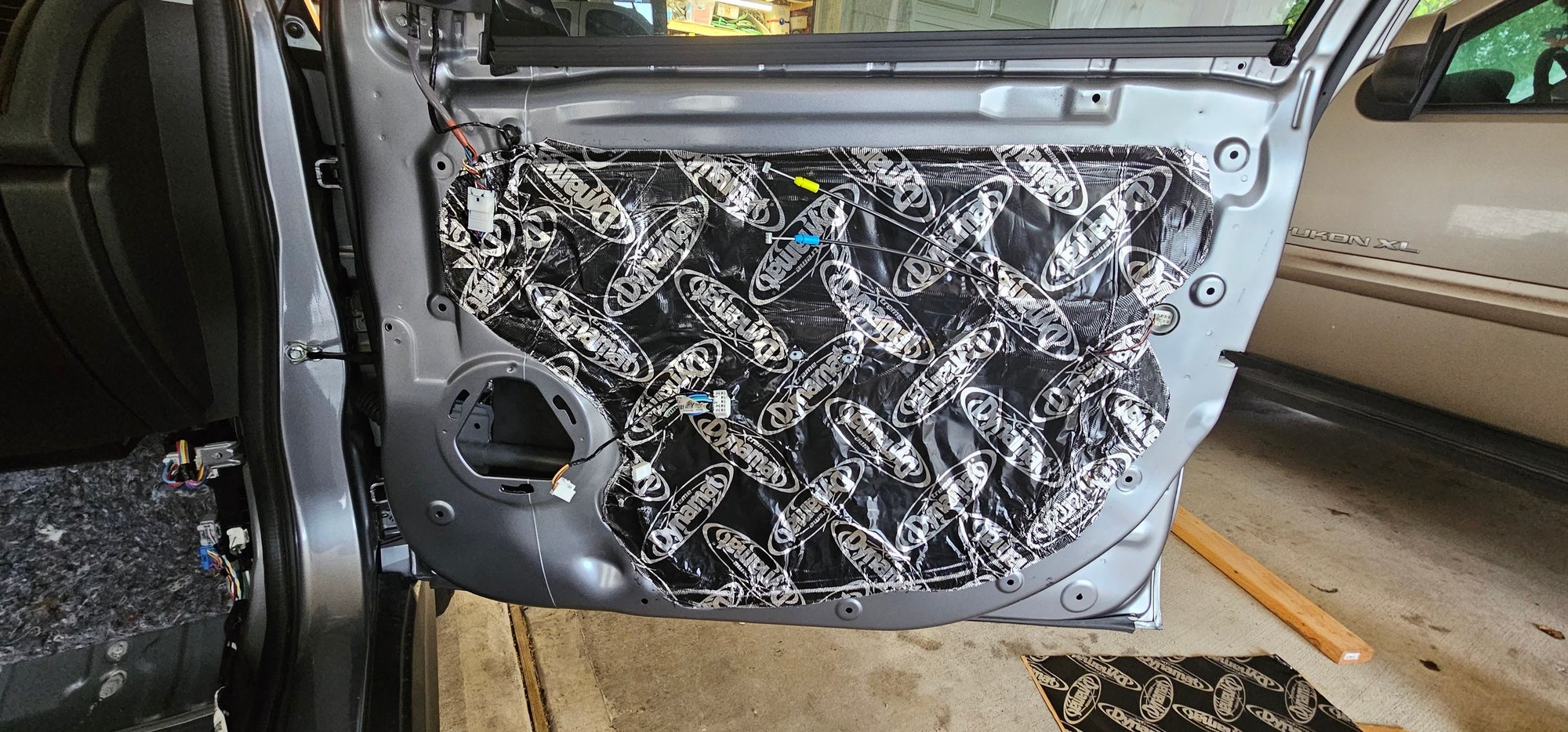

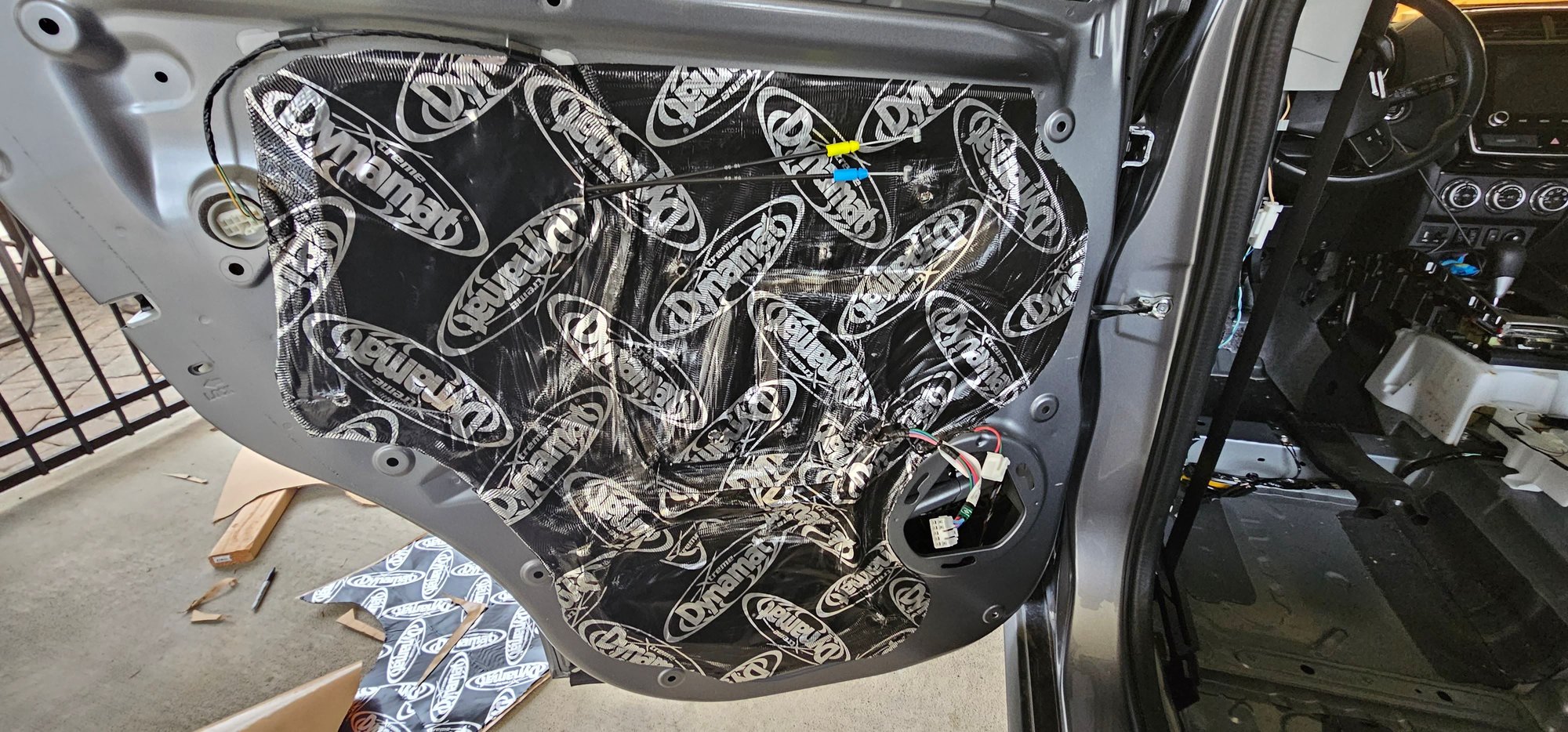

Damn! That looks very similar to what I did. I put down a layer of the dynamat extreme. and then put the closed cell foam over that. You did an incredible job of piecing all of the foam together... looks much prettier than mine, but once I got it back together it looks OEM... other than the nice solid "THUD" when you close the door now. This was my first vehicle to venture into the world of sound deadening, but it really did make an incredible difference. I closed up the holes on the doors to provide a vapor barrier, as well as try and minimize any noise from the outside of the vehicle. Just ran out of time and material... the only thing I have left is the back hatch and the roof. The closed cell foam I used was a little thick (394 mil):
https://a.co/d/esFKSLO https://a.co/d/esFKSLO
... You could go with something a little thinner and probably have a little easier time fitting the plastic panels back on, but with a little trimming and some persistence, it has filled the gap between the panel and the door very well. The foam is very light, but kills a considerable amount of outside noise.
