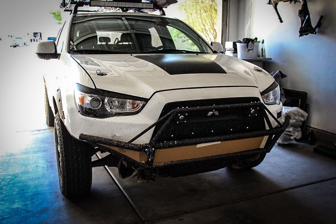

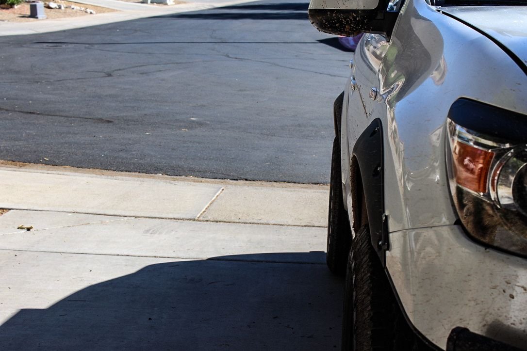

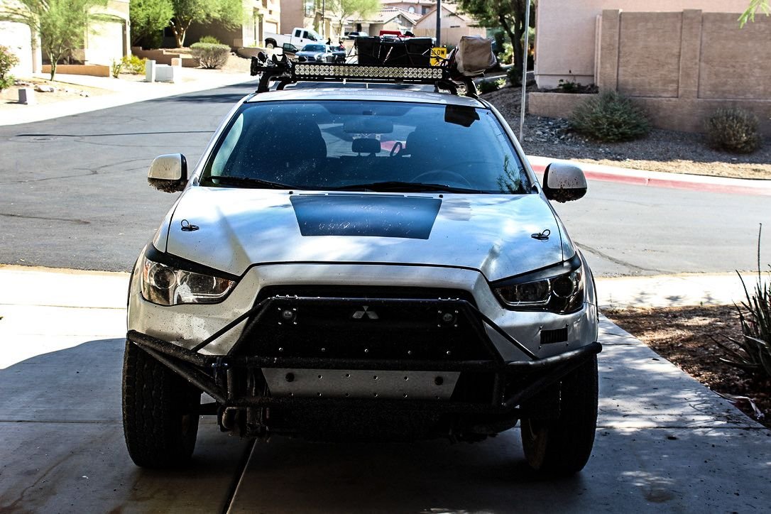

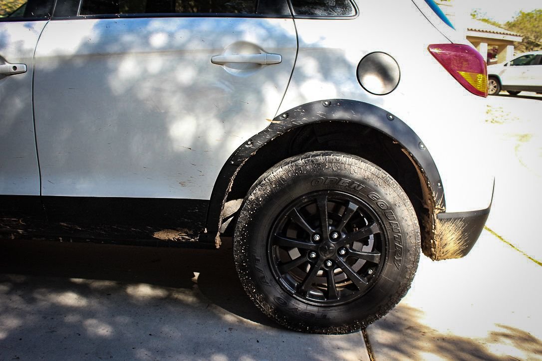

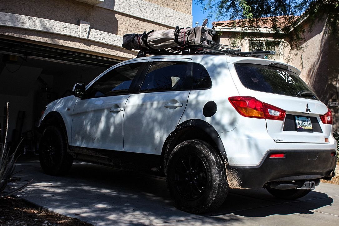

Ok, finally some pictures. Sorry for the mud, had to test out the flares I beefed up the bumper yesterday and will be adding some sheet steel where the cardboard mock ups are. and not sure if I will do a winch, or a small light bar down there yet. I put some vinyl on the rear hatch to break up the white a bit more and gives it a unique look along with vinyl on the hood to reduce some hood glare. Only thing left really is a 2" lift, tires, relocate my oil cooler. I want to make an aluminum guard for around the serpentine belt area on the right side of the motor as it is just plastic now and kind of exposed.....then possibly onto some performance stuff. I think the snorkel is a no go, it is not needed and would have been just for looks...maybe one day?
new bumper and cardboard mock up
rear flares cut around door
new front bumper and light bar
rear flare shot
flare shot
rear vinyl and shovel mount

left rear

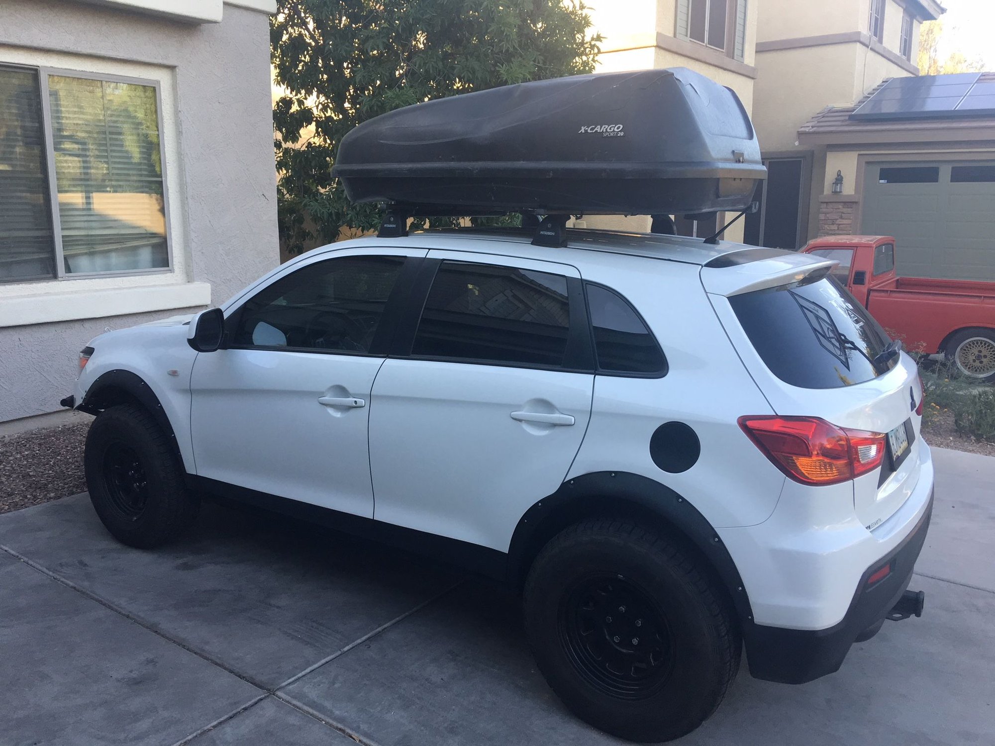

Here is a crappy pic of the new wheels and tires. 235.75-15's. I also picked up a giant 20 cubic foot roof rack cargo box. Gonna pack that thing full for the trip back to WA. I am sure it will help my MPG immensely. We are packing very very light and pulling a small 4x8 utility trailer and gonna hit HWY 1 and do some camping for about a week. SOOOO EXCITED. I will have more pics to come. Taking the car in this week for 5 recalls and fresh CVT oil.
