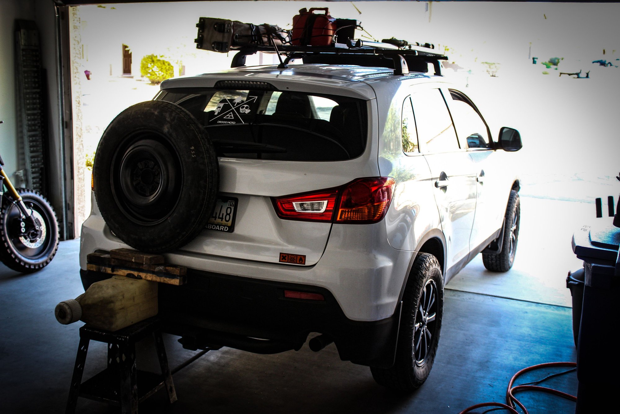

Ok so the front is almost done, just a bit more sheet work to do. I am off to the rear now Tube bumper tire/rotopax carrier! Ive got a bit of 1.5" tubing left over. I am going to weld/bolt it onto the rear bumper that bolts to the actual frame. I am going to go through the plastic bumper cover with some holes that will hug the tubing. I made a bumper on my Xterra that held up a 35" MT tire so this won't need as much support but still want it safe/functional. I am going to order a pivot/bearing from A to Z fabrication. They have a standard and heavy duty kit for like $50 that gets welded to the tubing and then another pivot arm gets welded to that so it swings out and away! Here is where I am thinking of location to swing away from traffic. It will swing to the right. You can't see it, but the left light is not covered. Just the part on the hatch, but I don't think that does anything except for the reverse light which the right side is still fully visible....Oh, and relocate the plate to somewhere else of course
OS tire carrier
OS tire carrier
