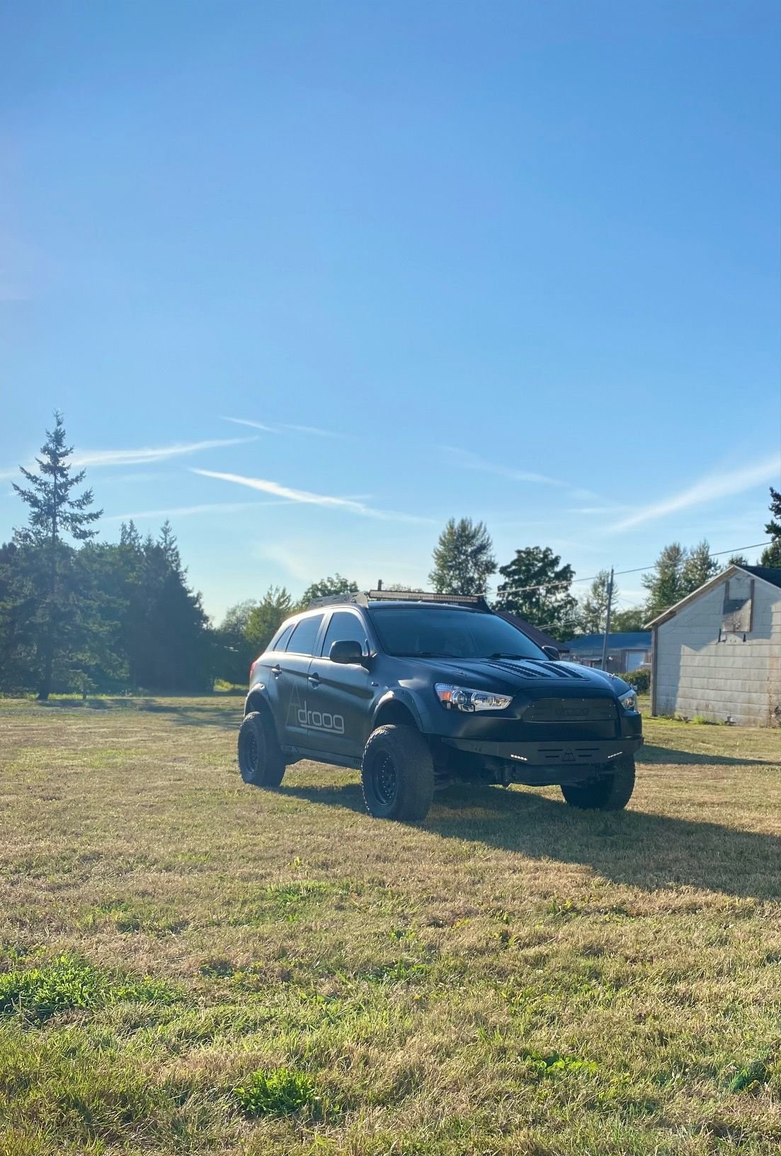

Pic updates! Since the last post, new cnc cut front/rear bumpers and new aluminum light-bar roof rack rails. CNC cut in my shop with 1/8" aluminum. I am (thinking) about making these available for purchase for OS owners.
The problem is, most people front want to cut/move/alter things on there rigs, which I totally get. I receive a ton of DM's and messages about how did I do something and what can they do. If you are NOT willing to cut, remove and relocate things on your OS then really....you can't. So, the roof rack rails are pretty straight forward. I do not know about OS's with pre-existing rails but if you don't not have anything currently there should be some mounts under the roofs black weather striping. May have to pull them back to see. one per corner of the car and there are two mounting bolts per corner.

Droog Manufacturering
Is there a possibility to turn your rooftop panels into a low profile roof basket? It appears to have a few crossbars. I have the OEM Mitsubishi roof rack and it's super tall at least 5 inches. Then you add a roof basket on top and it almost looks unsightly. Looking for something a little bit more low profile.
Any pictures of how it's mounted it to your Outlander?
Yeah you for sure could fab up some low profile boxes if you will. I had a 2006 Nissan Xterra and one of my favorite features with the built in roof rack wet box for gear/straps, etc...It had a cover with struts that could lock as well. Awesome feature.
I currently have two big openings on the roof rack in-between the cross bars that could hold to low pro cargo boxes. Roughly 3" deep. You could do one big cargo section or break it up into whatever you'd like.
The side panels are 1/8 aluminum. They are the held in place by 4 CNC cut L bent brackets that bolt onto the existing roof rack mount holes. There are two screws per corner, it is very well mounted and sturdy. I've had plywood and other materials up there in the past. It is kind of a pain to install but that is why I went with the 1/8" material as it is a bit thinner and slides down in-between the L bracket and roof bend area. It is slightly wavy looking at it from the back but not a big deal. With some cargo boxes and more roof slats it could be straightened out for sure. The light bar up front helps a ton as well. I suppose if you don't want a light setup you could just do more slats and then like an air dam or something as well.
