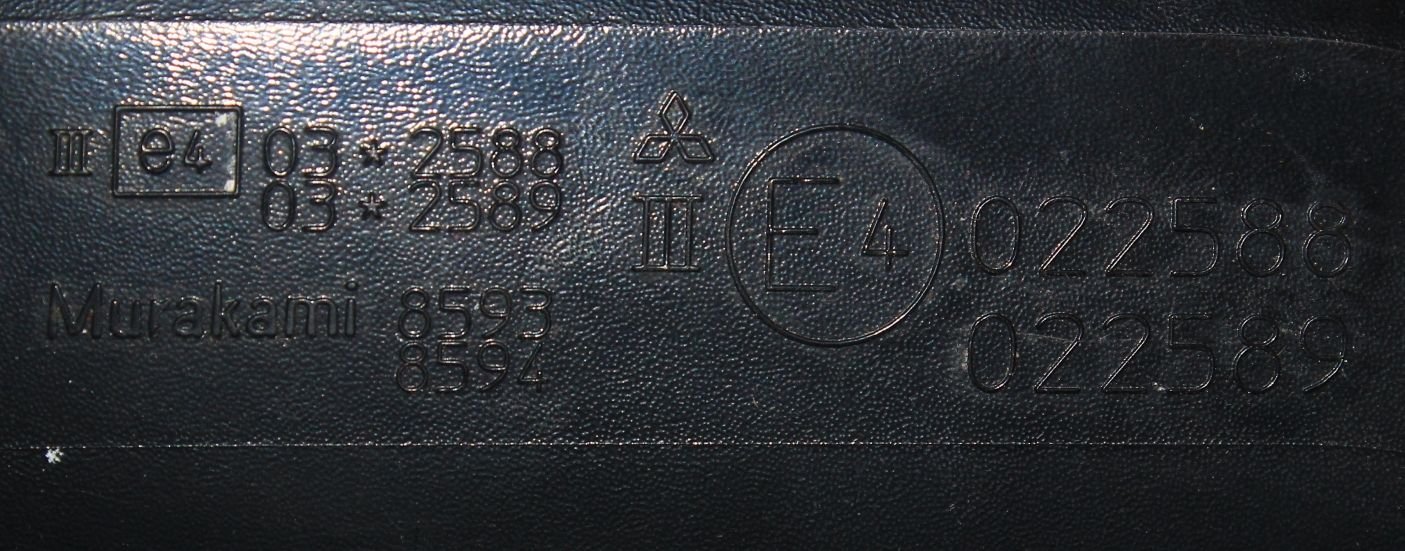

This is mine

Thanks. It is interesting that the label is the same. Murakami is a Japanese city and I suspect this is where the mirrors were supposedly made.I doubt that they were shipped all the way from there to Normal, IL.
