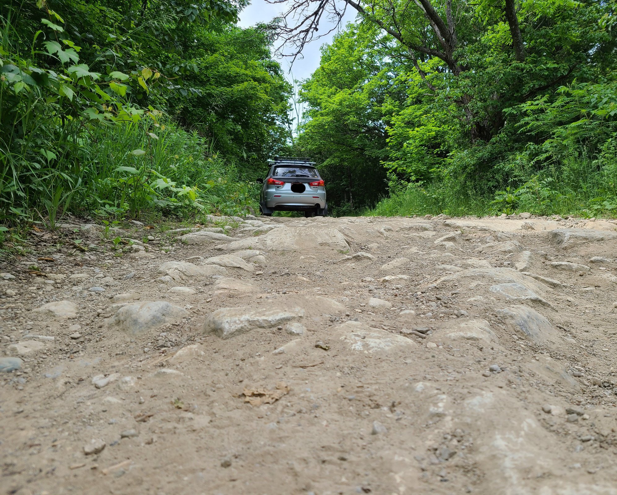

Here's a few photos with the basket on it...took it out for some wheeling last weekend. Unfortunately still waiting on the parts for the lift kit to ship..very excited to have that extra clearance however as these little cars are surprisingly capable with 4wd Lock engaged.
Have fun with that! They're definitely a niche vehicle in the modding community (outside of Australia anyways), but with a few accessories (and some loud tires) it sure turns heads. If you're looking to lift it, I ordered Moog adjustable rear upper control arms and a 40mm lift from anderson design fabrication; will post photos of that when it's installed. Lead times are insane with everything right now.
Will update again in a few weeks when its a little taller.
