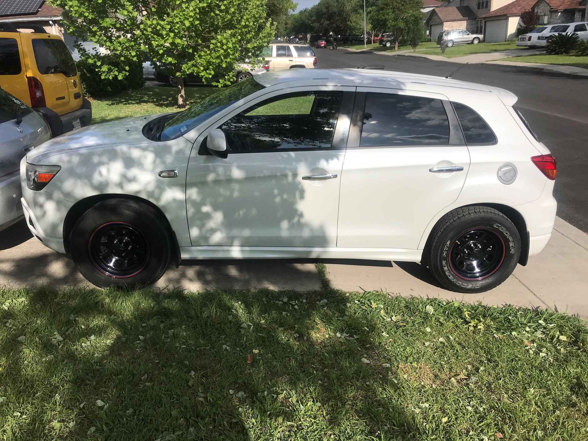

here is about a year ago on the old struts for comparison.

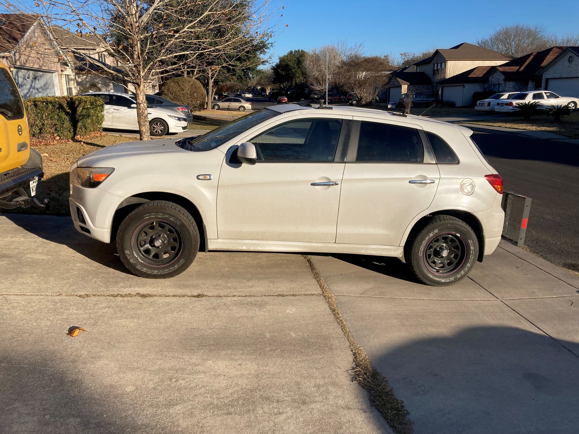

Update if anyone cares. How she sits after 4 months on new struts.
