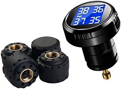

i used these when i had my Evo, and will be using them in my wife's OS when i use it for winter duty and put a set of snow tires on it that don't have TPMS sensors.
the display plugs in to the 12V cig lighter port.
Amazon Amazon

No, no, you misunderstood. I mean how the signal of the tire pressure sensor of the original car is realized on the instrument! It's not an external screen.

All, the OP is looking to have the dash display the actual pressure and temperature values from the TPMS sensors. This cannot be done- needs an external display from an aftermarket manufacturer.
