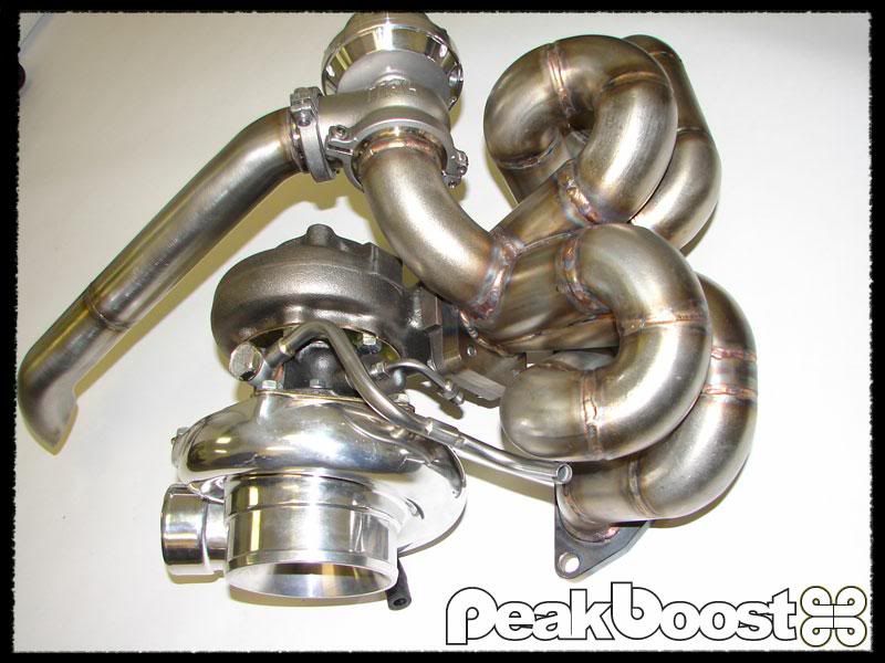

I have a question about the FF header. Does going from a shorty header to your FF increase power everywhere? Or just topend increase. My power seems to fall off a little early but im not sure i wanna change cams. The bf272's have sick torque, i like it. My power peak is at 7400 now.
I don't know what a "shorty header is" I mean I know what you are asking but don't know how short or runner diameter either. The FF header from the testing I have done, makes the most power of any header design I have seen. NOW, turbine housing is critical to that statement and I went through a lot of header building and testing on this car and later found out that all turbine housing manufacturers are not created equal. Must of my testing was re-done because of that. That is some of the testing I have done that never made it to the public eye either. Our header/turbo kits are now based on fitting and working correctly using either the Garrett GT turbine housings OR the Tial V-band, which was based on the GT housing in the first place.

I see... is my hta 86 a gt style housing? If not what you saying is i need to swap to a tial v band to work correctly with your FF header?

The picture of that turbo is not the GT housing.

I dont have that turbo, just the manifold. I have an fp hta 86 with 4 bolt outlet. Do you need a pic of my turbo?
Its not the housing with the outlet bell. Mine is the 4 bolt that is close to the turbine.

Derek, sounds like you have the GT housing then.
