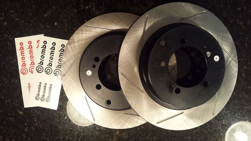

Mail day
A piece of the motor mount arrived today.
A few more items arrived as well. Stay tuned for a very nice before/after pic *fingers crossed*
