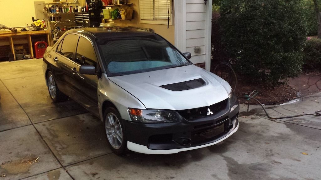

Here is Frankenstein currently demonstrating parts from 7 different Evos. I finally have replaced all the body pieces . The original side-skirts are on my back porch and didn't make it on the car for the pic.

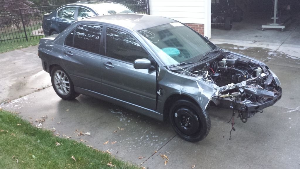

The side that was hit
