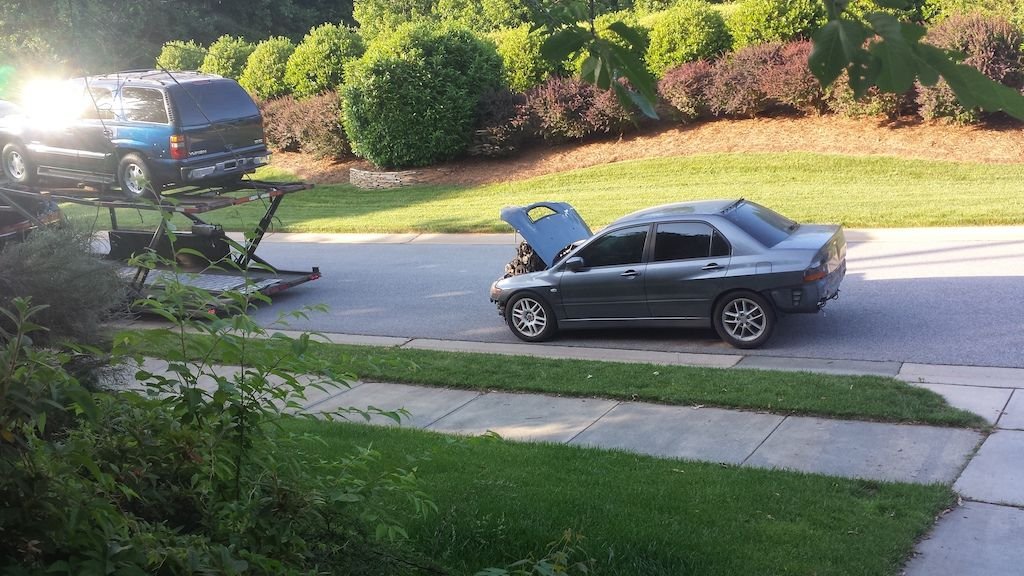

Its arrival
An abused 2005 GG MR
What is that under the hood?
Well it appears to be a Honda SOHC POS, what a surprise!

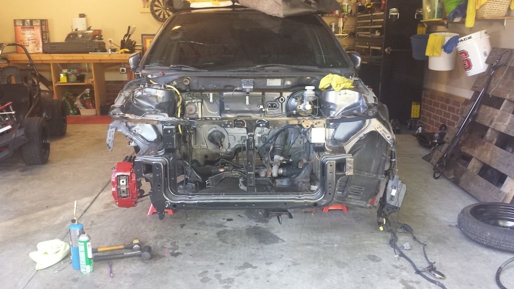

Its twisted
Passenger frame rail bent about 1" up, in front of the strut tower thankfully.
Physics can be fun!
10,000psi of ramming, days of hammering and a bottle's worth of propane torching later...
Next step is to remove that nasty radiator support.

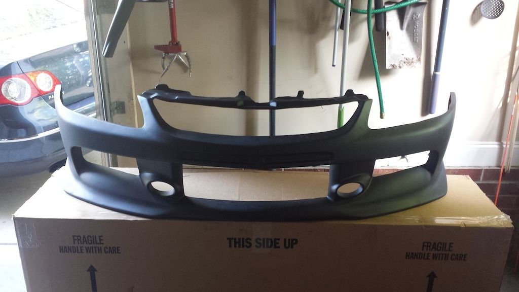

Parts influx
Ever wonder what those super cheap (~$190) FRP OEM replacement bumper covers from Extreme Dimensions actually look like? I hesitate to call it an OEM replacement. It is more like an 'OEM inspired' replacement.
There are no mounting holes, none. The two slits above the main FMIC inlet are not inlets they are depressions and the 'high quality' mesh that came with the piece was very optimistically attempting to redefine the term 'high quality,' so I ditched it.
On the positive side, it does look just like an evo 9 front bumper cover from about 10 feet away. It is MUCH more flexible and resilient than fiberglass and about 30% the cost of a urethane polymer variant.
