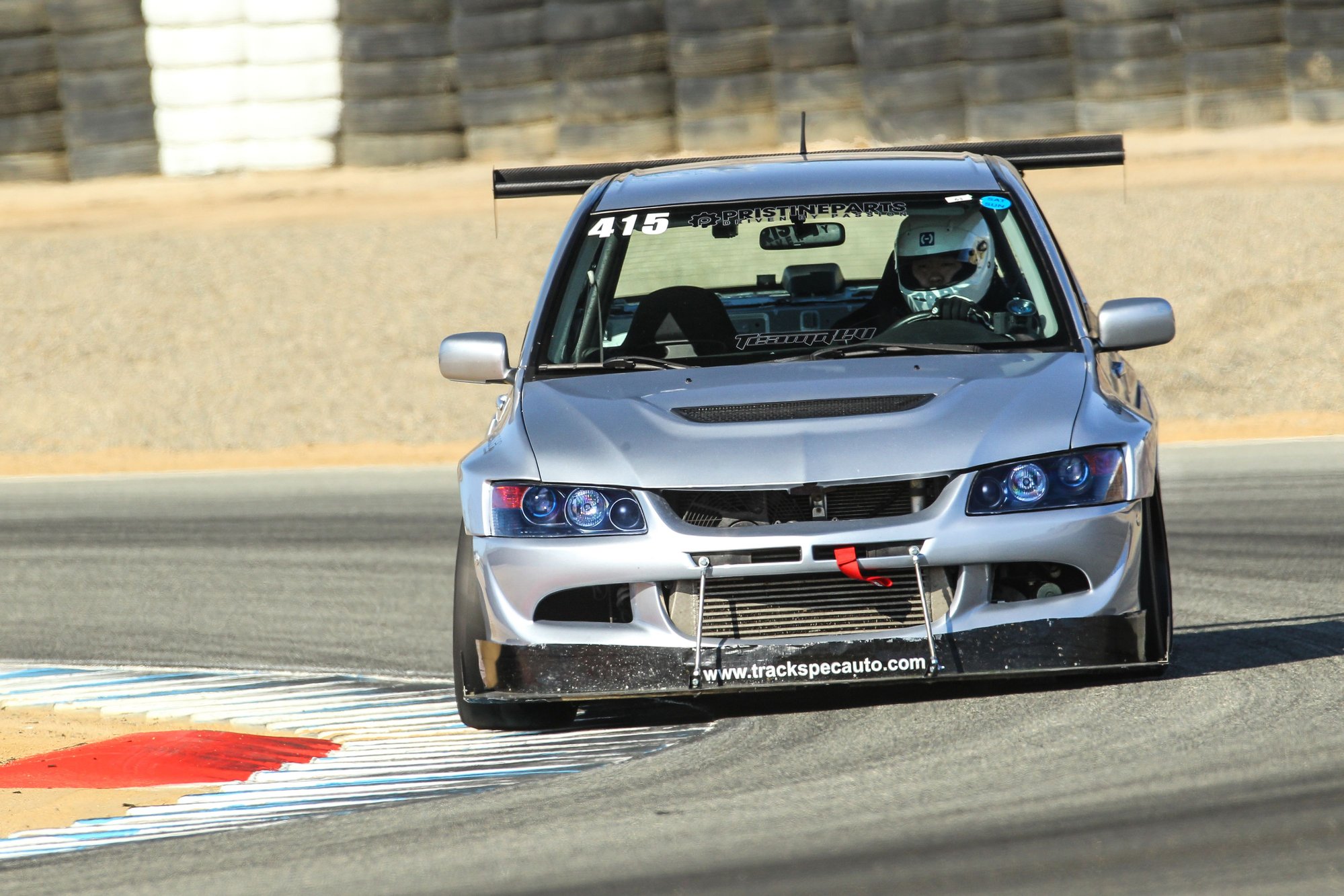

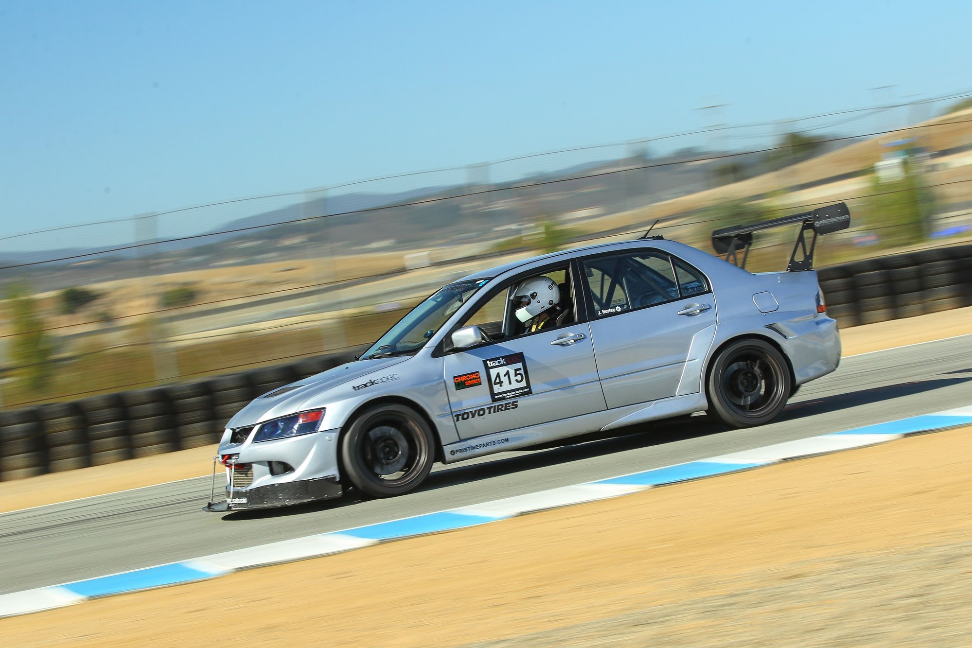

Car as it sits now:

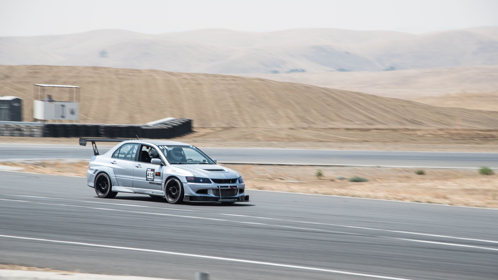

Thunderhill West:
https://www.youtube.com/watch?v=y0kwunOW4KU
