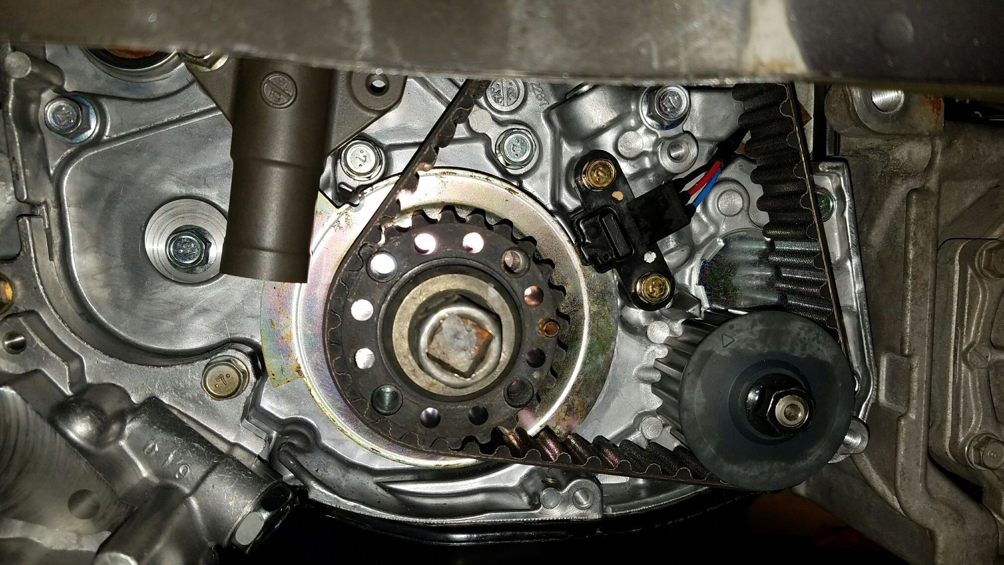

So,
can anyone take a look at the pics below and tell me that my front main seal is actually leaking? Those pictures were taken before I cleaned anything. Honestly, it doesn't appear to be leaking but because I already bought a new one, I am going to replace it. My concern is that if it is not the cause of the dirtiness around there, then what is it or could it be?
Thanks in advance!

Originally Posted by RelentlessEVO
So,
Thanks in advance!
It actually does not look like your front main seal is leaking from that picture. As the timing belt wears, you can get a faint black residue that comes off of it, but not like what we are seeing here. That's grime at the bottom of your front case. Is it possible for all that to get past the timing belt cover? It should be fairly weather tight. Is that oil under the lowest CPS bolt ? I hope it's not the oil pump gear seal.
-pal215
-pal215
I'm thinking it might be coming from the balance shaft seal, or possibly even further up on the motor? Perhaps a cam seal or valve cover was leaking and it leaked down and collected at the bottom there? I'm not sure what to do.
