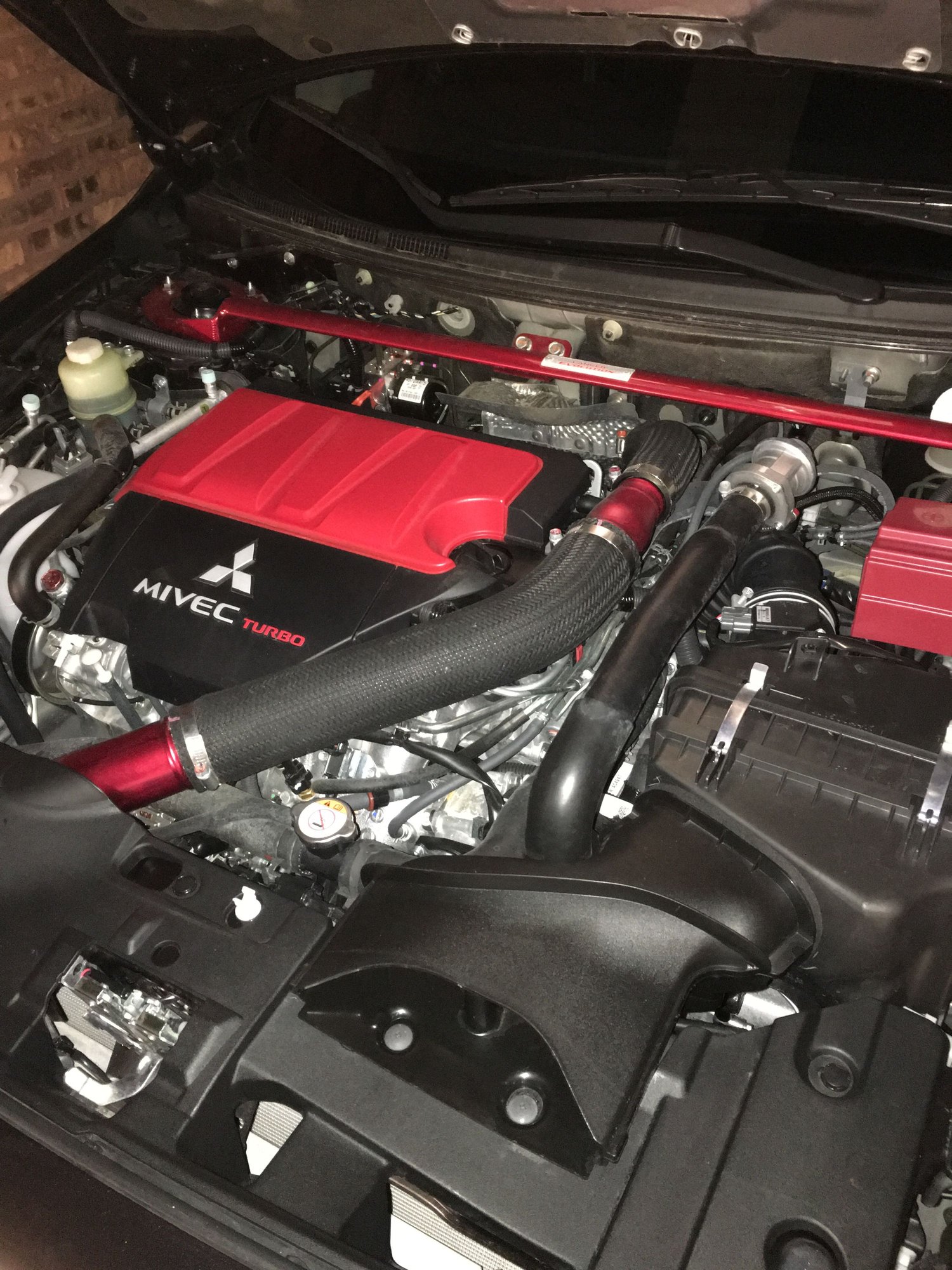

Here are the results, like I said I'm very pleased and had a great experience and the car is amazing! The ATP GTX3076R is a great turbo and it has more left in it for sure. I'll try and keep this as updated with track results when the season begins in a few months. If you have any questions feel free to ask me!

Nice setup. How much boost are you running on E85?
Thanks man!
27-28 psi at peak, the cold weather made it spike to 31 psi last night though after the tune was finished.

In case anyone wanted to know I'm at 21 psi on the low boost 93 octane tune. I'm primarily going to run e85 thanks to a good selection of e85 stations in my area, 93 map is more for long trips or to switch out e85 for a tank etc.
