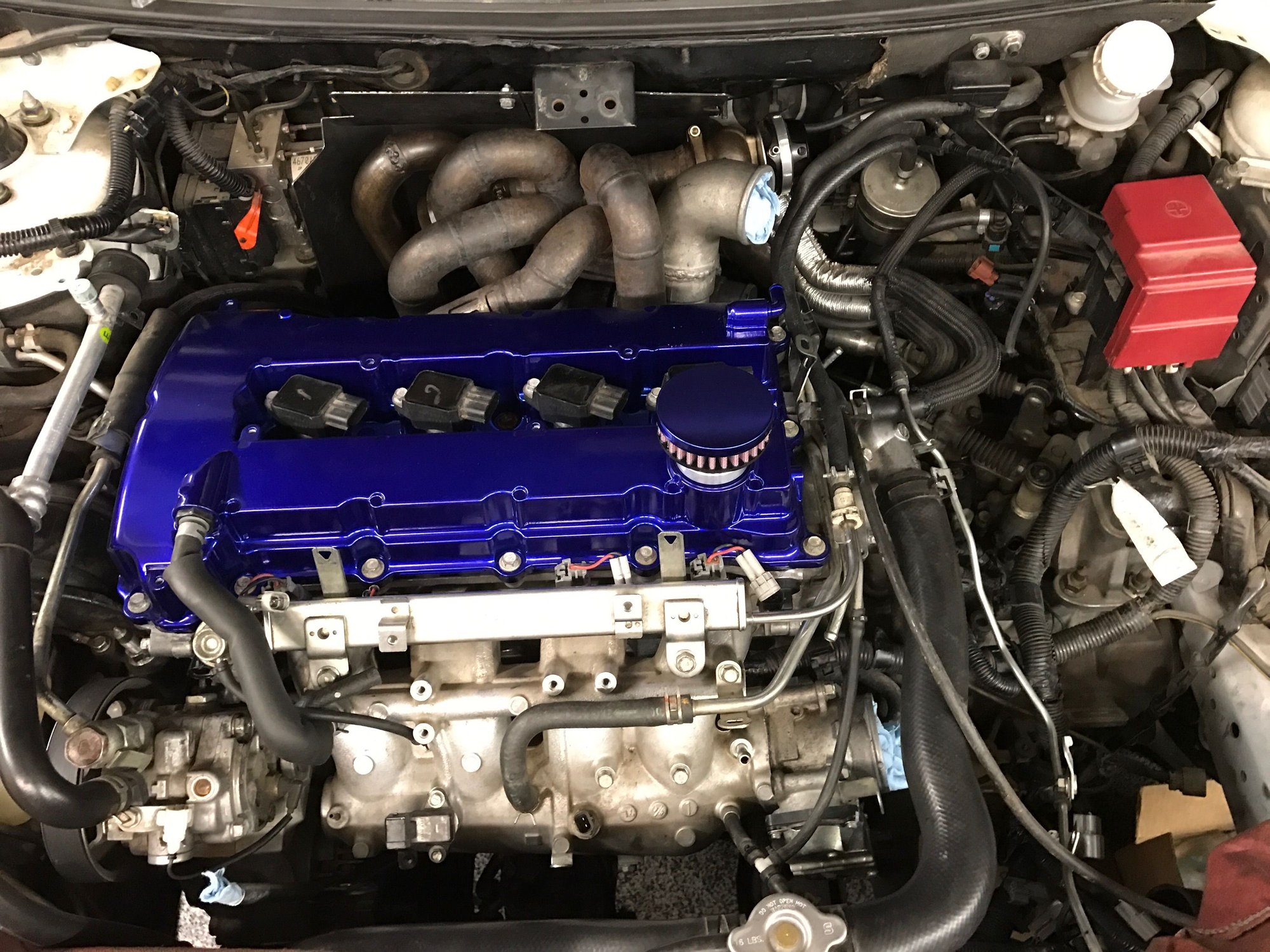

Evo X 2.4L HTA3586r

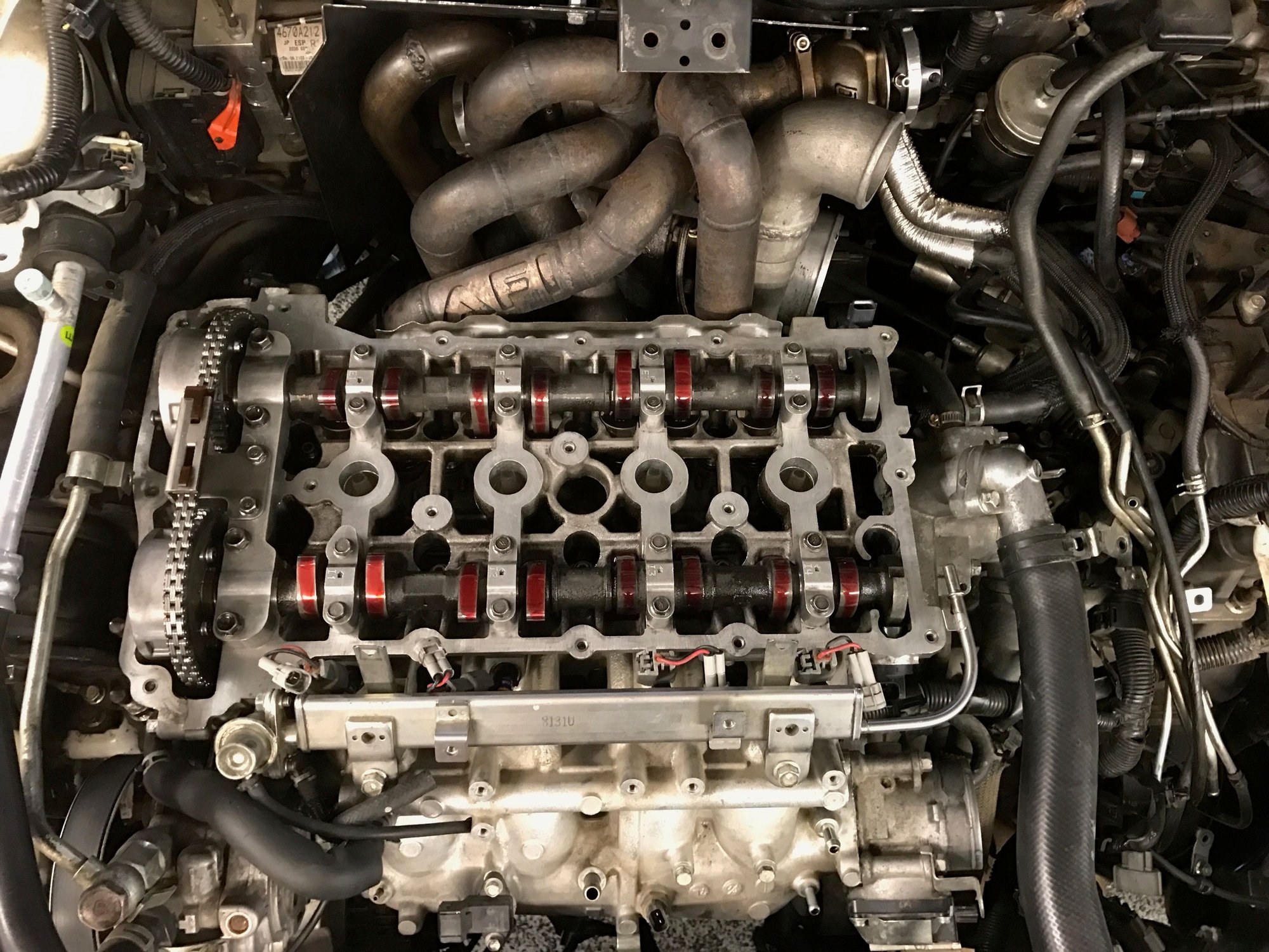

Evo X Build:
Block

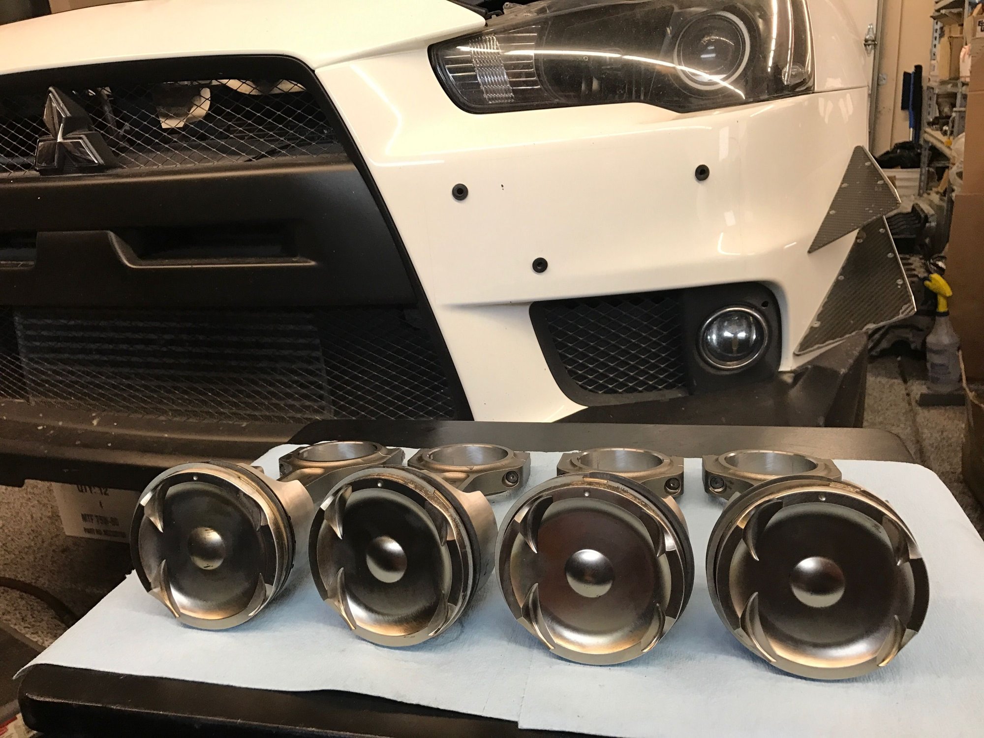

Wingz Performance built 2.4L stroker
Manley turbo tuff rods w/arp 625+ rod bolts
Weisco pistons
MAP H11 head studs
Darton Sleeved block
Cosworth headgasket

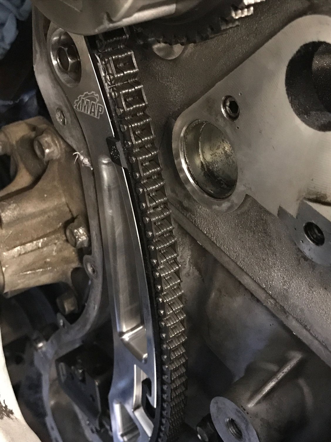

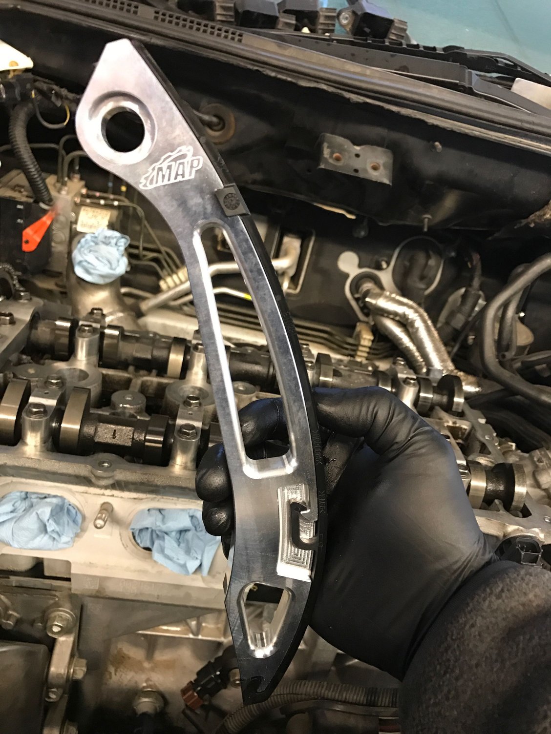

Map billet tensioner and timing chain
Head

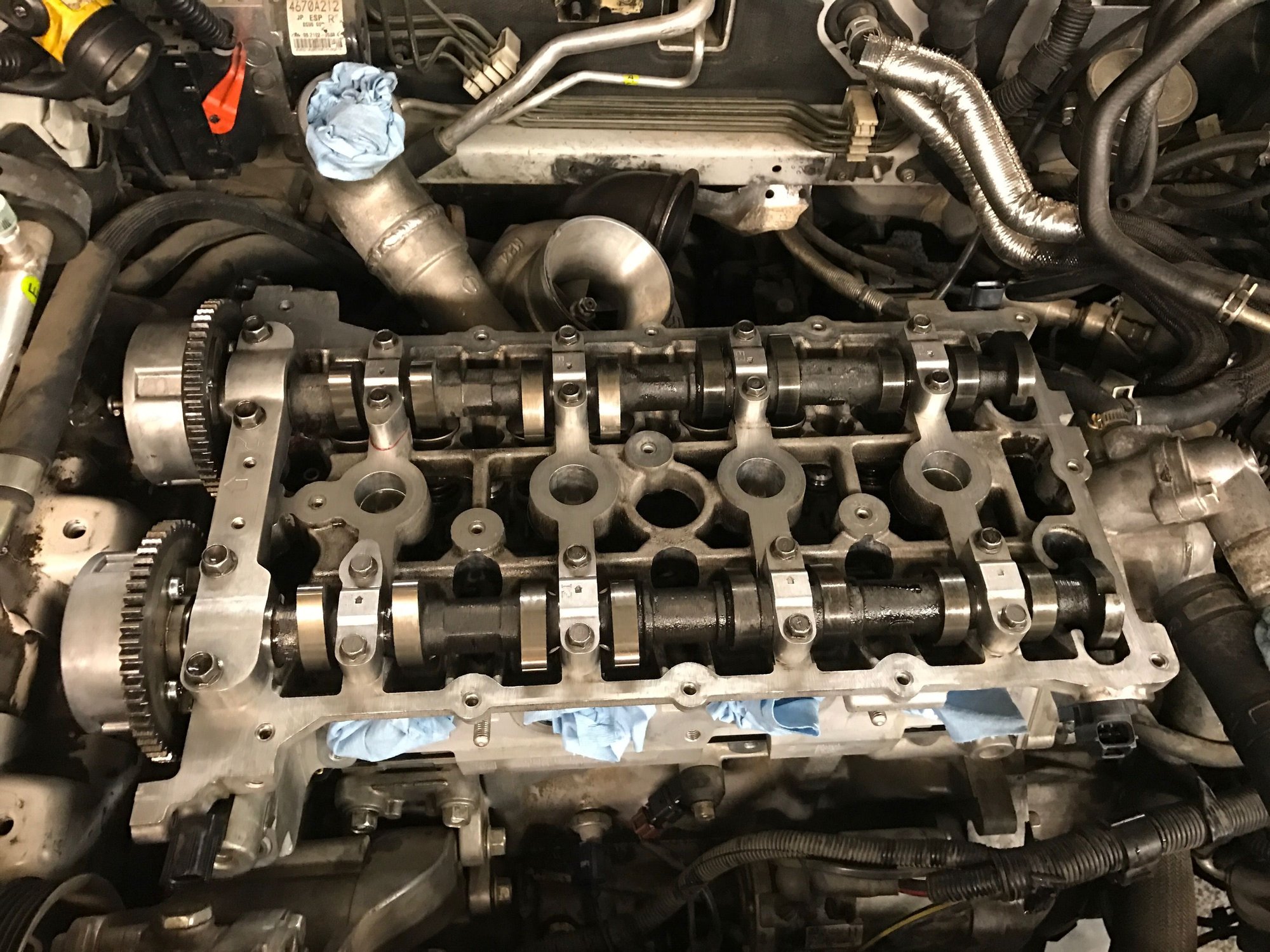

GSC S2 Cams
Brian Crower springs and retainers

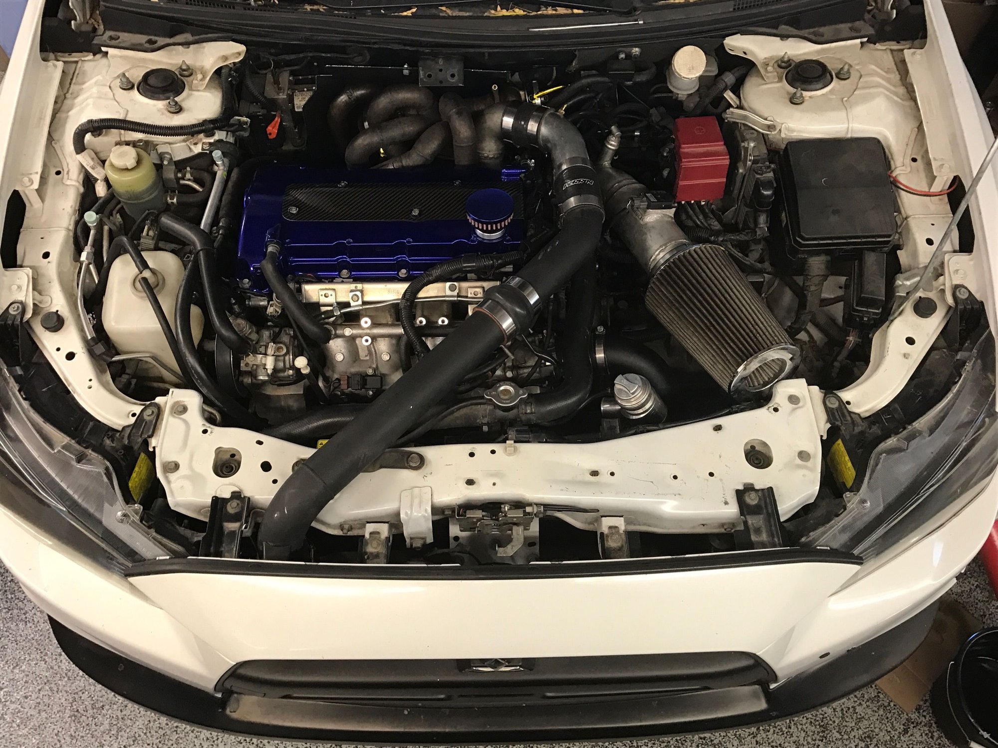

Turbo kit

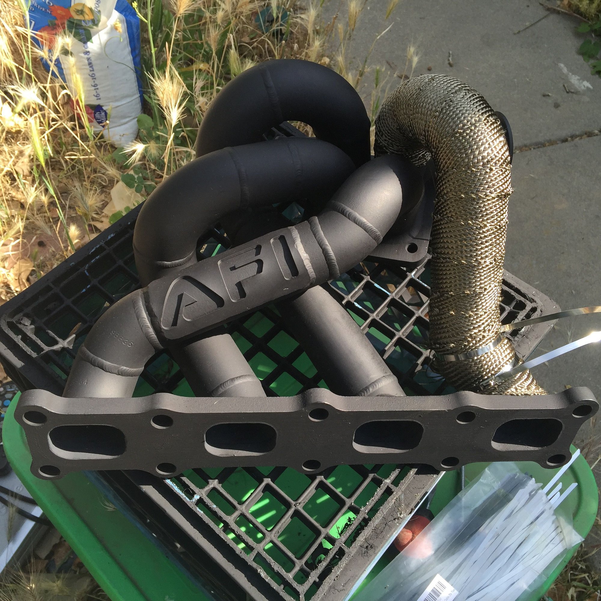

AFI T4 Twinscroll Manifold
HTA3586r 1.06a/r
Dual turbosmart comp40 wastegates
AMS 3.5 intercooler
Custom 4in intake
Fuel System
FIC2150 injectors
Buschur double pumper twin 255
AMS fuel rail w/damper
Fuelab fuel pressure regulator
Flex fuel Kit
Transmission
Quartermaster 8leg twin disc
Interior
A pillar gauge pod
Aem AFR wideband
Tanabe boost gauge
AMS carbon fiber shift knob
Goal is to hit 750whp on E85 and run 10's, custom hood exit, ic pipes and 5in intercooler on the way. Will post dyno results when it's done being tuned!

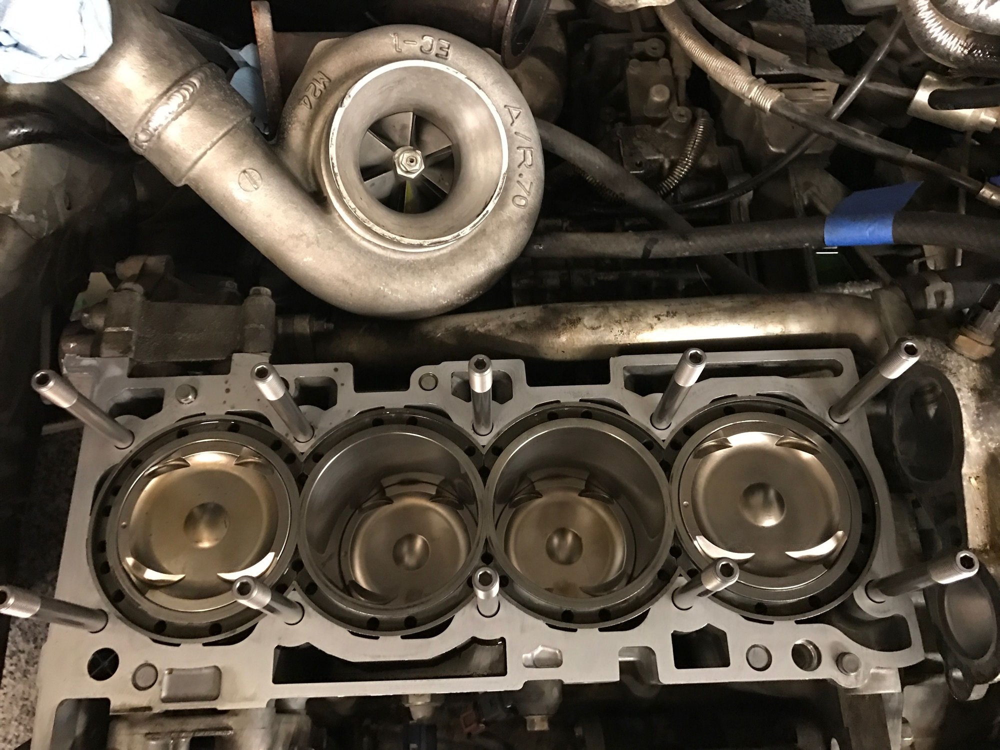

Looks like a solid build. Are you gonna o-ring the block? What is the max boost your gonna allow?
Old Nov 28, 2016 | 07:19 AM
BRANDONBALDY's Avatar
Joined: Mar 2016
Posts: 19
From: Chandler
Probably not gonna o ring, max psi will probably be somewhere around 40-43psi.
Old Nov 28, 2016 | 10:14 AM
4b11slayer's Avatar
Joined: Nov 2015
Posts: 1,787
Likes: 89
From: Santa Ana
I follow a guy who did a 2.2 4b11 with a 6466 and experienced head lift at 40 psi. Just a heads up. He has the best head studs also. I follow him on Socal Evo on Facebook.
Just throwing it out there.
Sick build though should be a torque monster.
Old Nov 28, 2016 | 10:19 AM
4b11slayer's Avatar
Joined: Nov 2015
Posts: 1,787
Likes: 89
From: Santa Ana
Yes so i just double checked. It is a darton 2.2 w 6466. Head lift at 40 psi upwards of 700 hp on e85.
He just finished build and head lifted on dyno, he now pulled head to oring it.
Old Nov 28, 2016 | 10:46 AM
Facepuke's Avatar
Joined: Nov 2016
Posts: 16
From: Oklahoma
I don't think you're going to have any problems hitting 10's with that kind of power!
Old Nov 28, 2016 | 11:11 AM
Joined: Mar 2016
Posts: 19
From: Chandler
Hopefully I have better luck! 😬 Definitely have the power for high 10's need some better tires to really get a good 60'ft
