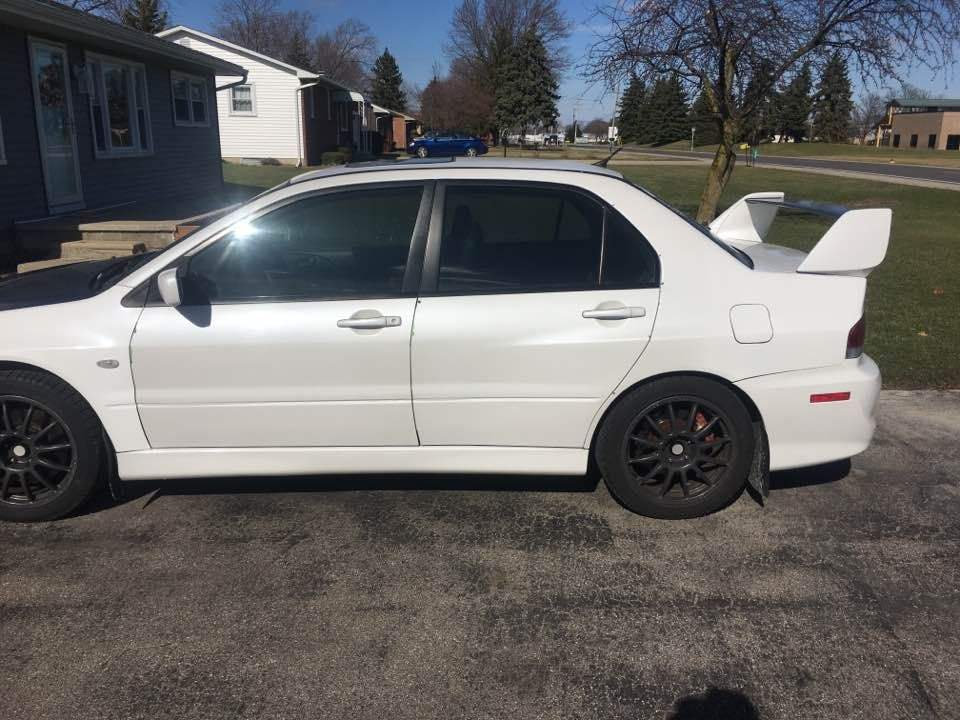

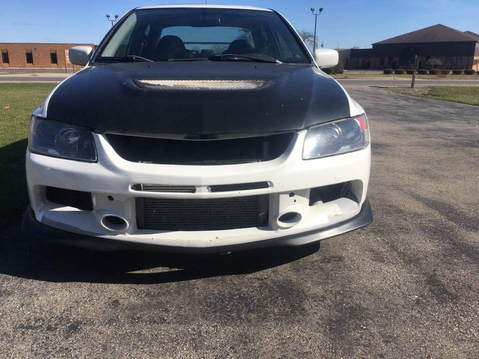

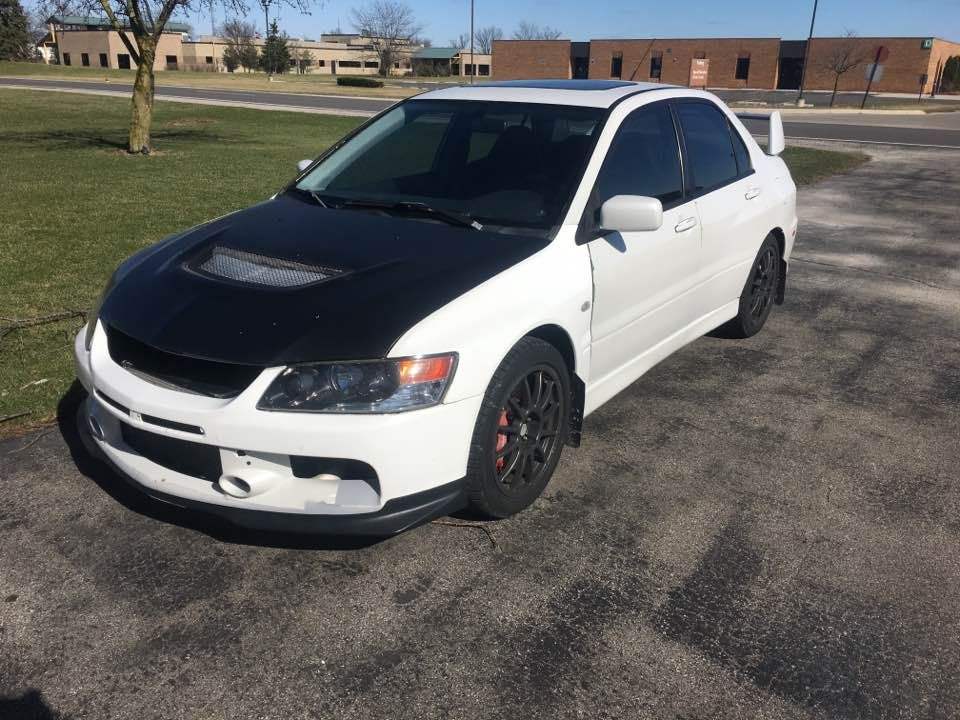

                                        So without further ado, I present... The Ugly Duckling . I will update with more pictures soon, but it is like 10 degrees out and I am cold.
                                        Got to love 4 different colors

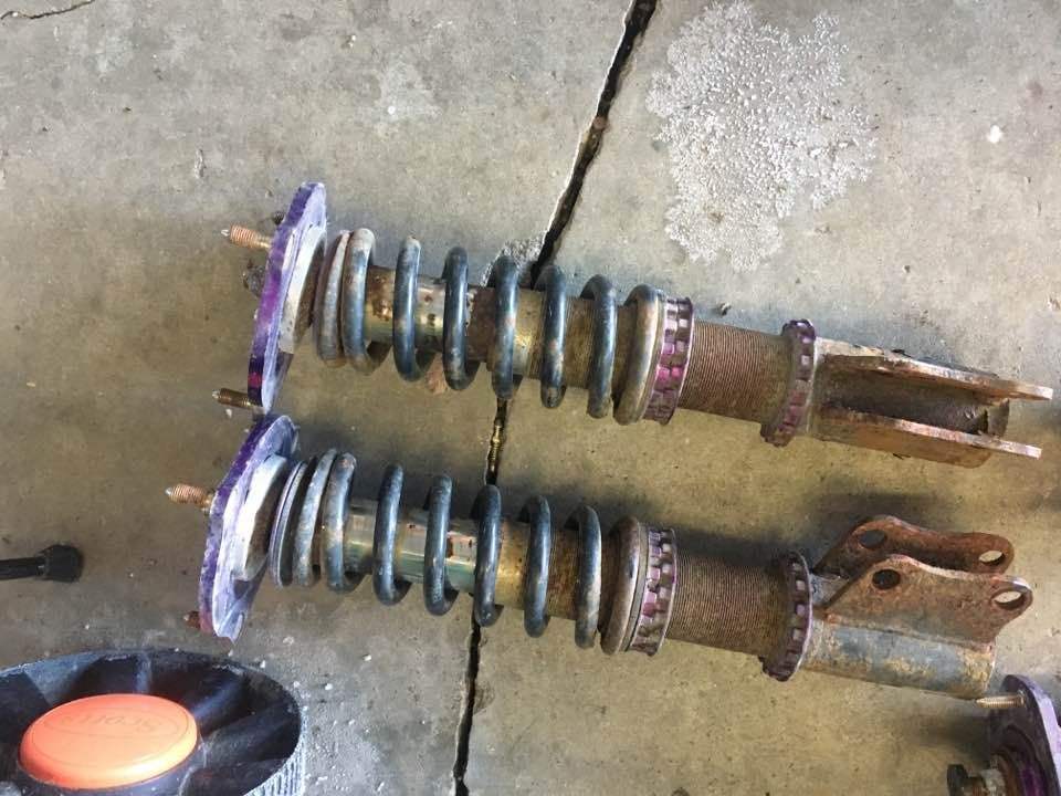

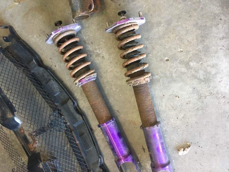

                                        Pictures of the D2 Coilovers that I might have rebuilt:

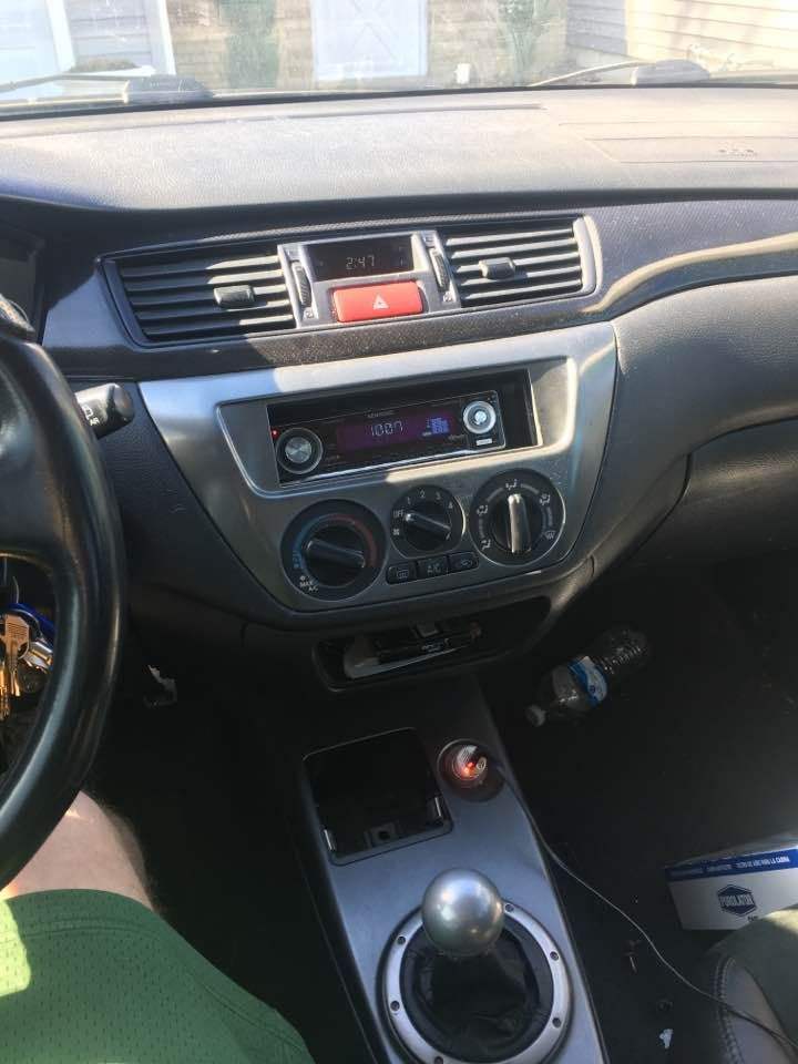

                                        And the busted radio bracket:

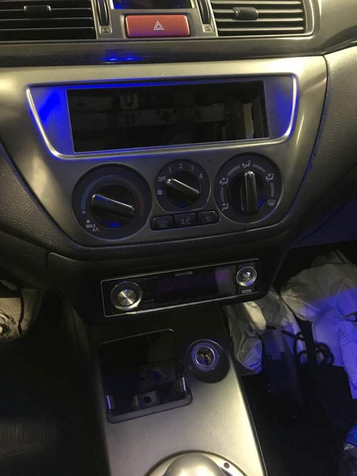

                                        So I had a little bit of time this weekend to button up a couple small items.
                                        I was able to get the OEM UICP and BOV installed, relocated the radio to prepare for the gauge and also started pulling the rat's nest of wiring from the prior owner's audio system.
                                        The car seems to run smoother with the recirc'd BOV but it is still breaking up in the upper RPM range. Will have to pull the plugs and see how they look even though they are less than a month or two old.
                                        Fluids and gauges supposedly being delivered tomorrow so hopefully next weekend I can flush the whole car and get some electronics installed.
