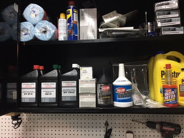

Not too much to update on. Had a professional detail yesterday, he spent 7 solid hours on it. The interior looks brand new! I was stoked to see it when I got back after work. 405 Mobile Detailing for those in the Inland Empire, CA.
Will get some proper photos this weekend with my camera but this was what it now looks like after a combined 13hrs worth of detailing in a week.
More of my fluids and filters showed up for me too. Will keep me busy this weekend!
OEM Galore!
Replacing the following:
Fuel filter
Cabin filter
Thermostat and gasket
Transmission + T case
Brake + clutch flush and bleed
Coolant flush and replacement
Diff (will restack and replace bushings at same time)
My fuse connector will show up today, so before I go and get Saint Patrick's Day Hammered, I hope I can sneak home and replace that!
Have also started to organize new shoes too. Of course, RPF1s wrapped in Nitto NT05's.
My next little project will be replacing the front lip, repainting brake calipers and valve cover, and tidying up the little ****. Hope to hit a track in April/May.
