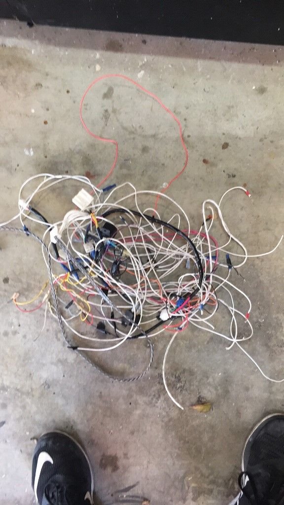

No massive updates so far apart from it getting a new Viper Python alarm system installed with 4 auto doorlocks for extra safety!
Had it professionally installed as I wanted him to go through and pull out any old wiring, and check things out generally electrically. Glad I did cause he found this lovely bird nest under the dash waiting to just cause trouble!
What was pulled out. Mostly old gauge wiring, stereo and other random relays and a switch
