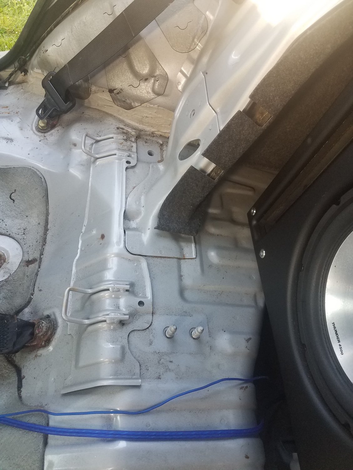

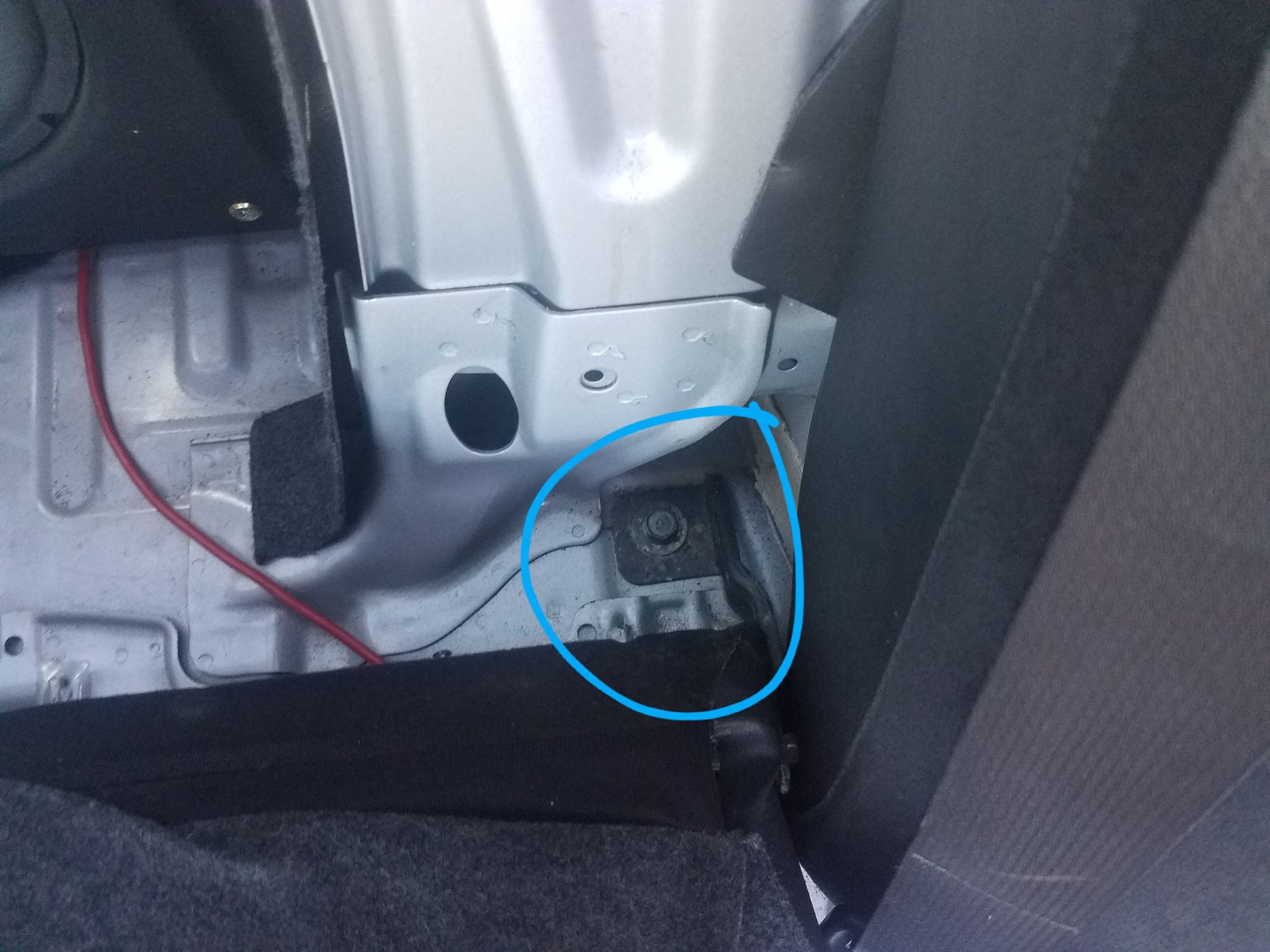

So i got around to swapping the carpet and seats yesterday. Didnt finish until it was already dark so i was pretty tired and called it a day. That was my one day off so i was glad i got that much done. It did take a little bit of custom fabrication to make the ES interior fit properly into the OZ body. But its going to take more work to make the OZ back seats fit the ES body. And heres why... Top picture.. you can see the latches that the folding seats grab on to and the middle does NOT have a hook to hold the solid back seat in the top center..
Bottom picture.. no hooks for the folding seats. And no threads for them either although the mounting holes are still there. Also you can kind of see the middle hook i was referring to that the top picture doesnt have.
Besides that hook the plastics from the OZ will pop into place on the ES just fine. All those holes are the same. I drilled that hook out of the red one and welded it into the silver lancer. But now i will show you why the folding seats from the OZ will take a bit more work to install into the ES. First two pictures are outlined to show the bolts mounting location and the lack of it in the red ES. Bottom pictures should be obvious enough lol.

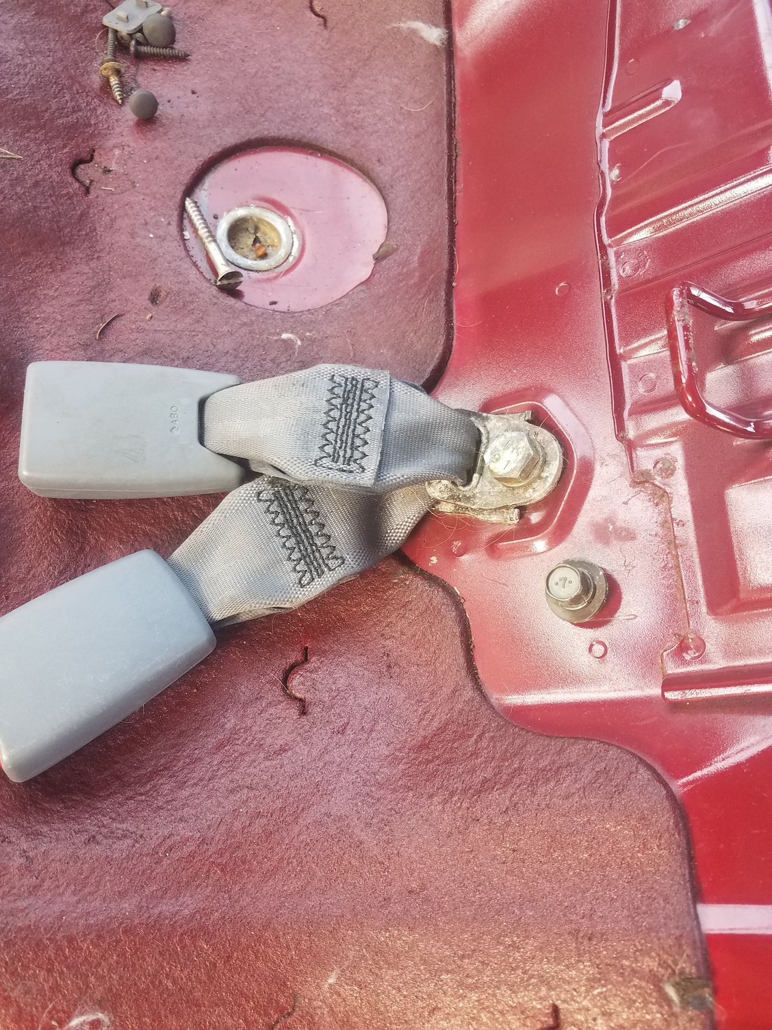

These were the initial issues we ran into when trying to swap everything over. Not too bad to fix bit it does take some fabricating to make it all work. Only other difference we found first day was a single bolt. This is just to mount the bottom middle of the solid seat into place, as you can see the OZ still has the spot marked for it. I personally didnt bother with this bolt. I figured the bottom seat will hold the back in good enough with the outside 2 bolts as well. So, after i called it a night i parked both cars and went to sleep. Got up for work the next morning and as i was about to leave i find out the seat belt latches from the OZ to the ES arent compatible eith each other. My seat belt wont latch and i dont have time to fix it. So i drove around today basically without a seat belt. I ran it across my body like normal but i had to sit on it instead of buckling it so i wouldnt get pulled over. So once i got home i went to swap out the seat belts and have the black clips in the red lancer with the black interior. The plugs are different as well so i have to swap the latches over from the black and grey seats. Simple fix for now since it was late.. I just swapped the whole damn seat for now.. i will get around to changing the buckles nezt time i dont have work. This is my fix for now. Passenger seat still wont buckle but i dont need to drive anybody around anyway. In an emergency i will tell them to get in the back. But so far these are the issues i have come across trying to swap interiors between OZ and ES models. If anybody else is interested in trying this now you know what you have to do to make it work. Any other issues i come across i will add in a later update. Hope this helps.

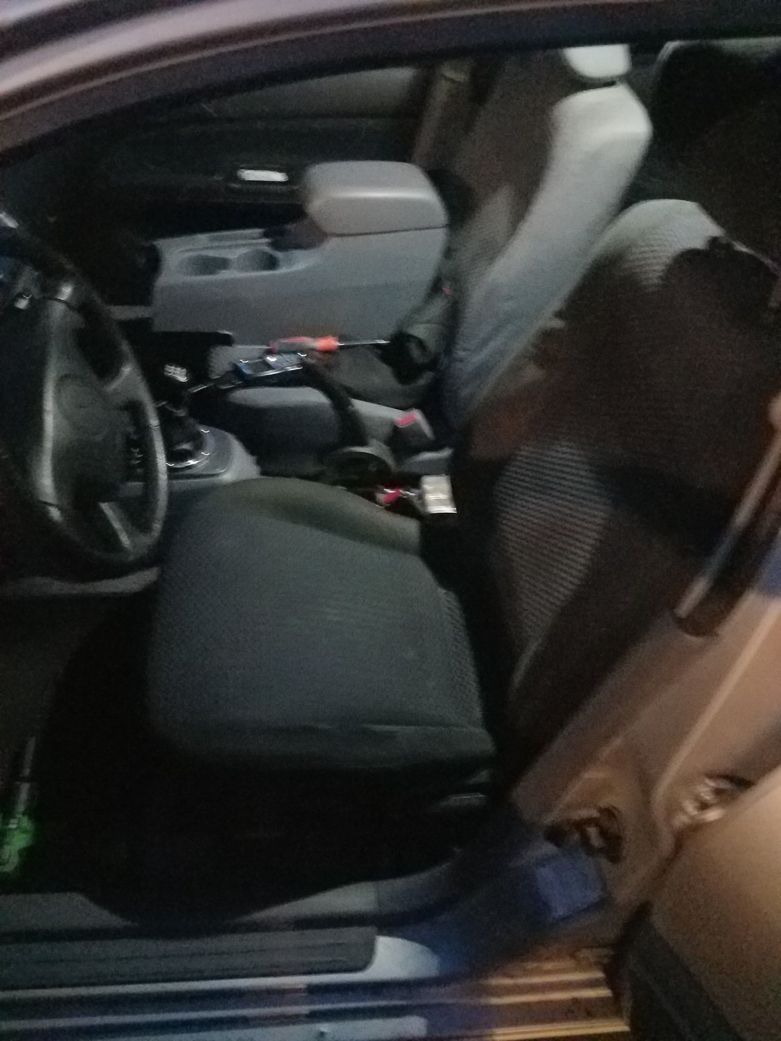

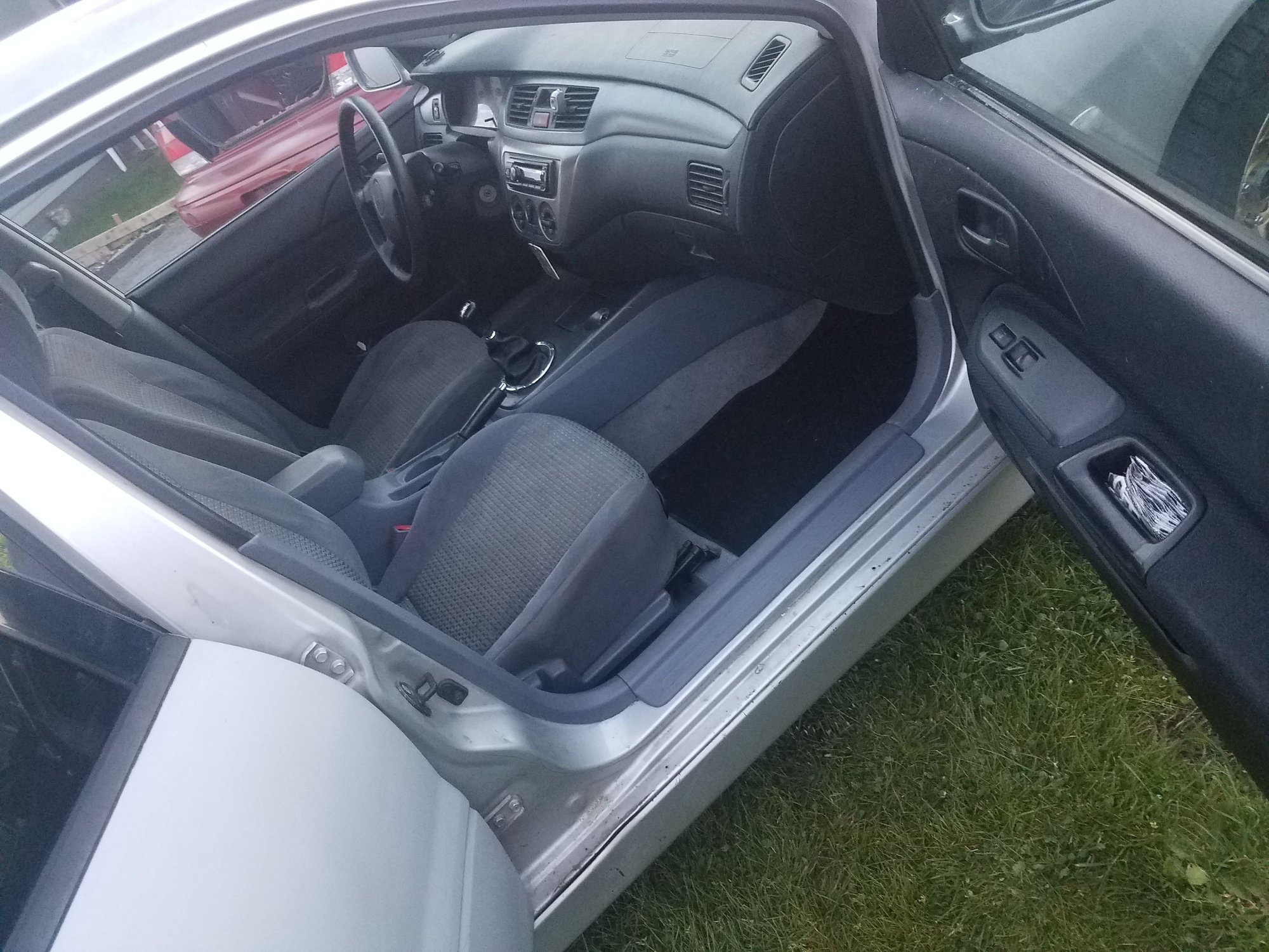

heres the pictures from when we finished moving the carpet and seats over. You can see the deck lid, door panels, and dash are all still black for now. Will be swapping those at a later time as well.
