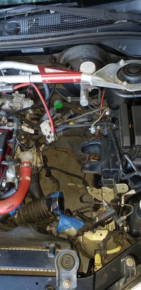

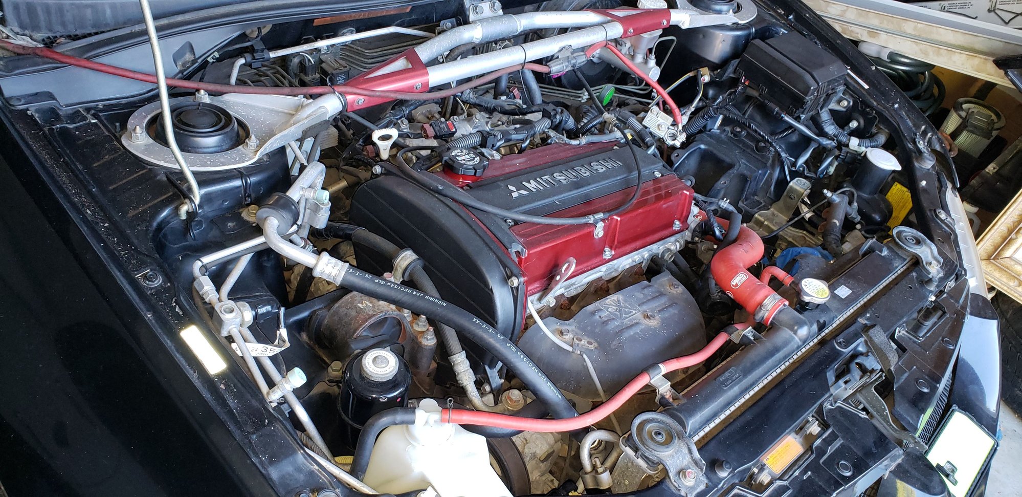

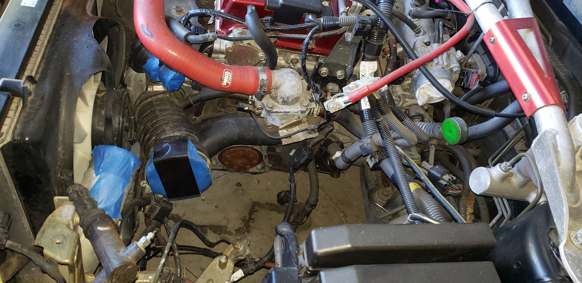

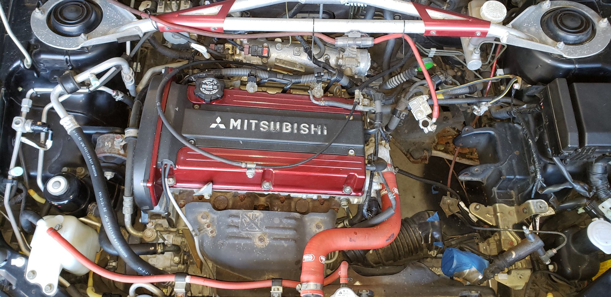

The new goodies!
I added a couple photos of how the engine bay sits let me know if you see any thing out of wack lol but I got her in the garage with a comealong and my 4runner slowly but surely... lol

Nice pics
Are you supporting the engine under the oil pan? It looks like its hanging off of the mounts?
Most guys are using a wide block of wood under the oil pan & a jack

Nothing.... i will get something under there asap.. do you think the mounts are toast since its been like this for prolly 8 years?
Oh Dang. Yeah, its a great time to consider new mounts. You can order replacement inserts into the stock brkts or go w/the bling (Torque Solutions) and get their billet mounts (thats what i run)
Either way, the rubbers need to go & replace w/new. You can hopefully save the rear trans mount. Many of us just run the stocker because it creates a lot of vibrations if you replace that bush w/a harder one
Good thinking. I've been lucky, so far. 135k on my car and still on OEM mounts. Well, I did swap the roll stop. But definitely check your mounts, since you are there. Couldn't hurt!
I'd also do something about this wire. It's just asking to short out your system or start a fire.

oh man i gave my Cousin so much **** about that he ran the sub PWR through the door jam and the wire has been crimped and looks like it was starting to melt...
Car Audio was the first thing i got into with cars so i will make all that invisible when im done. but yes thanks for noticing that
Edit: Im going with the Agency Power mounts aleardy ordered.
