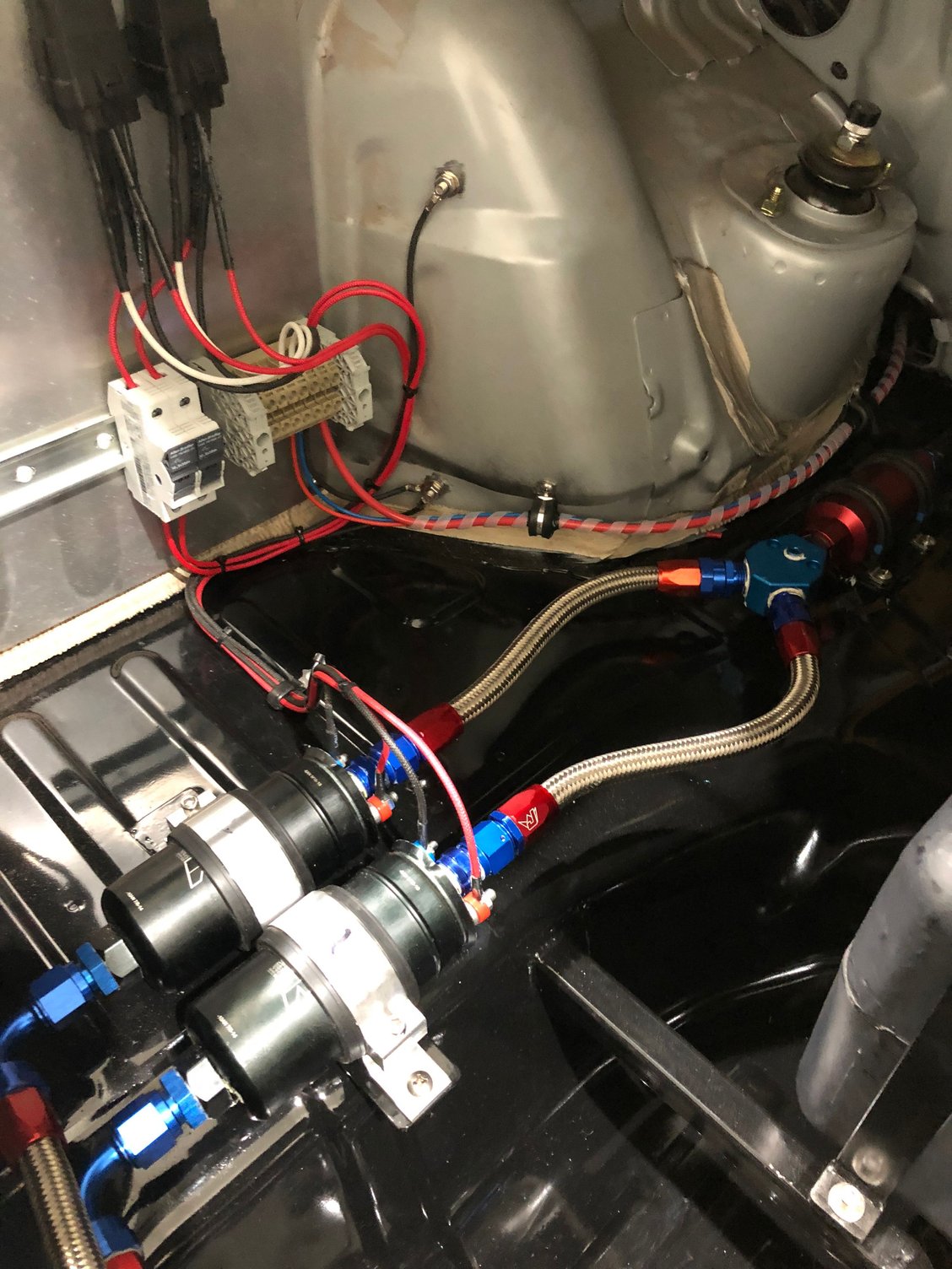

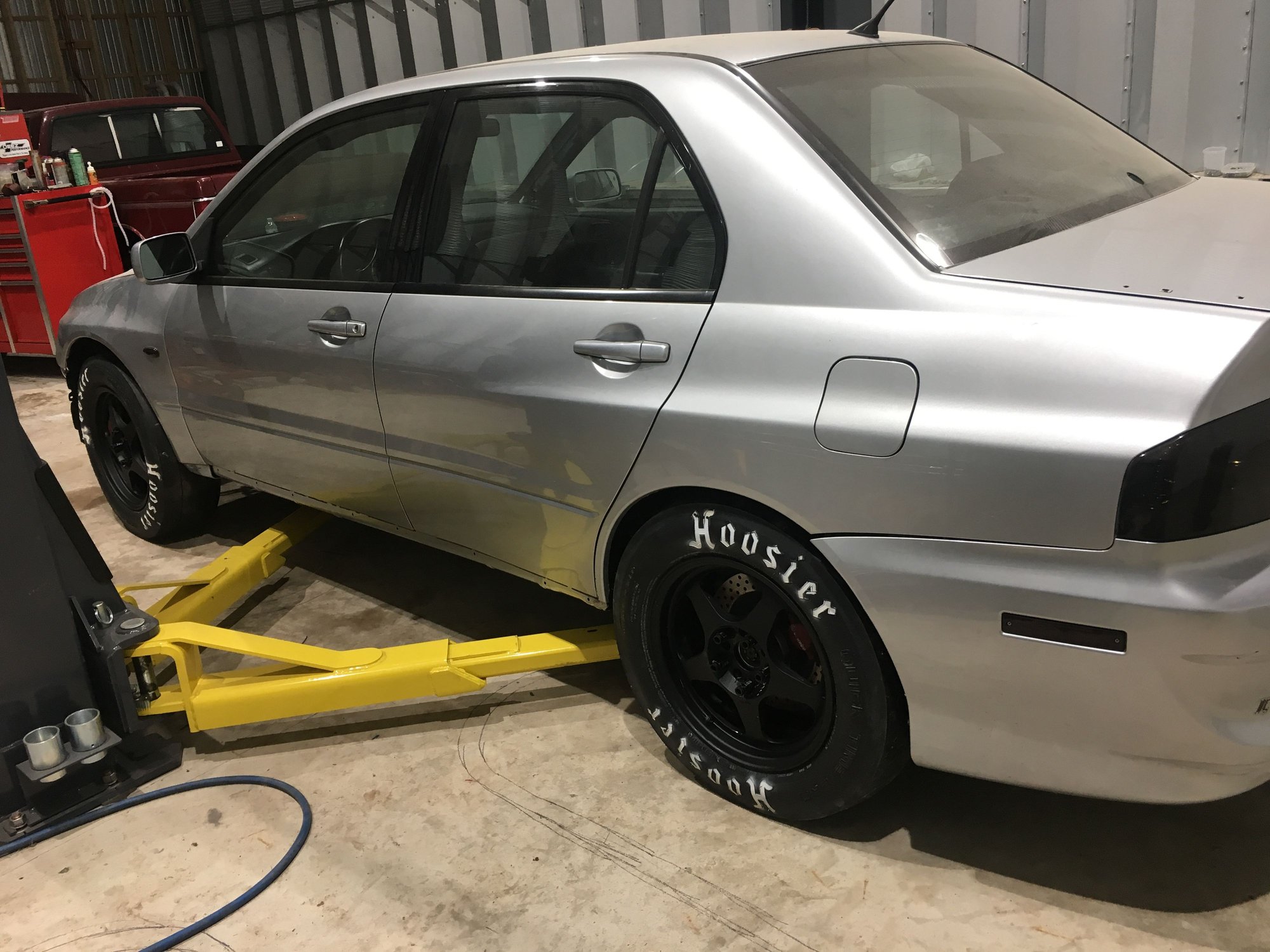

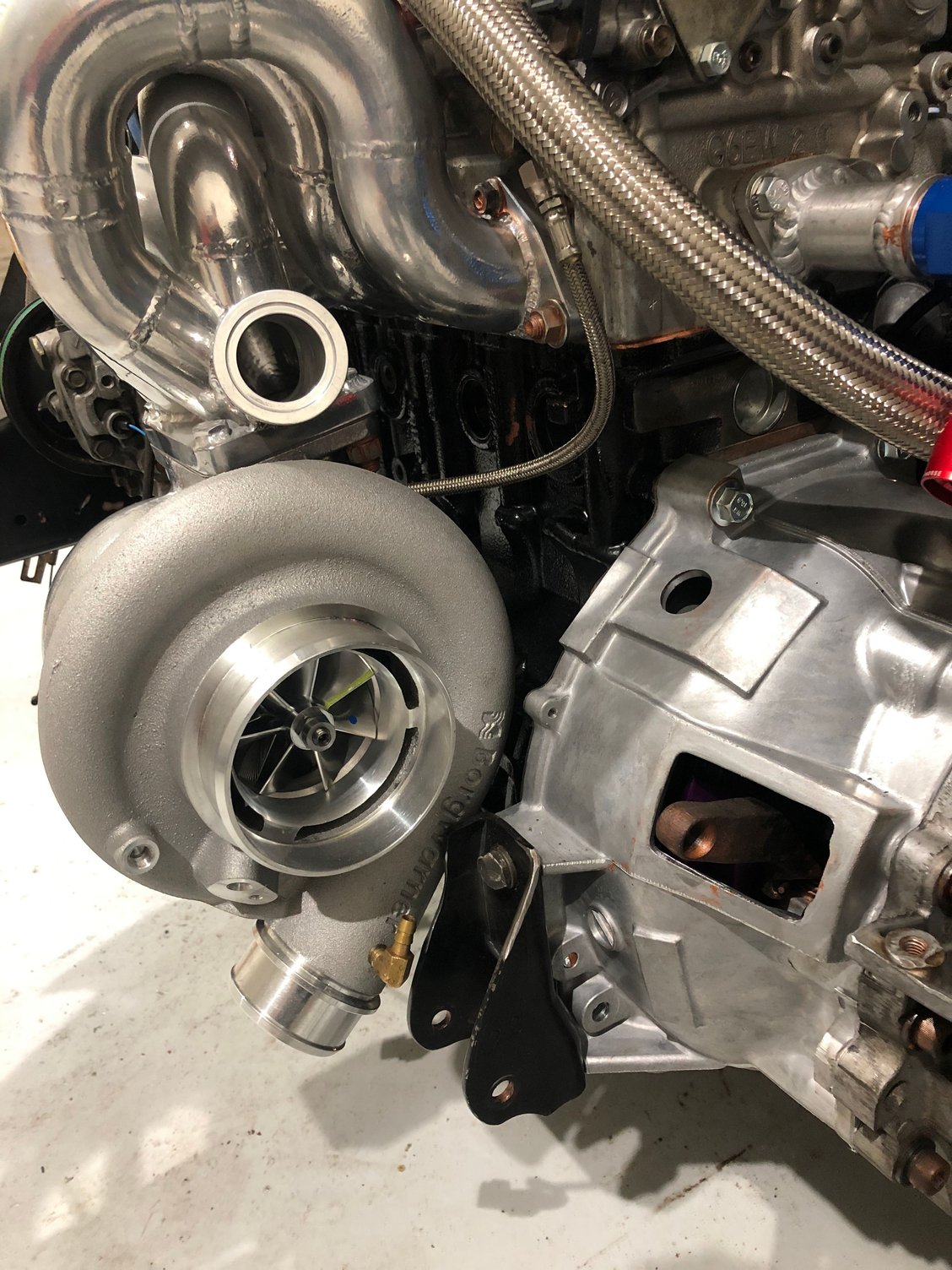

Well I’m getting close to finishing up this build. I have an old build thread with the S366 turbo but with so many upgrades and a new 72mm BorgWarner turbo I figured a new thread was appropriate. Here’s the first build I did.
https://www.evolutionm.net/forums/pr...diy-build.html
Items I have upgraded are as follows....
I ditched the old double pumper because it was maxed out at 850hp. I went with twin AEM 044 pumps and fuel cell. Ran stainless lines (5/8” feed, 1/2” return). Aeromotive regulator and Magnus rail.

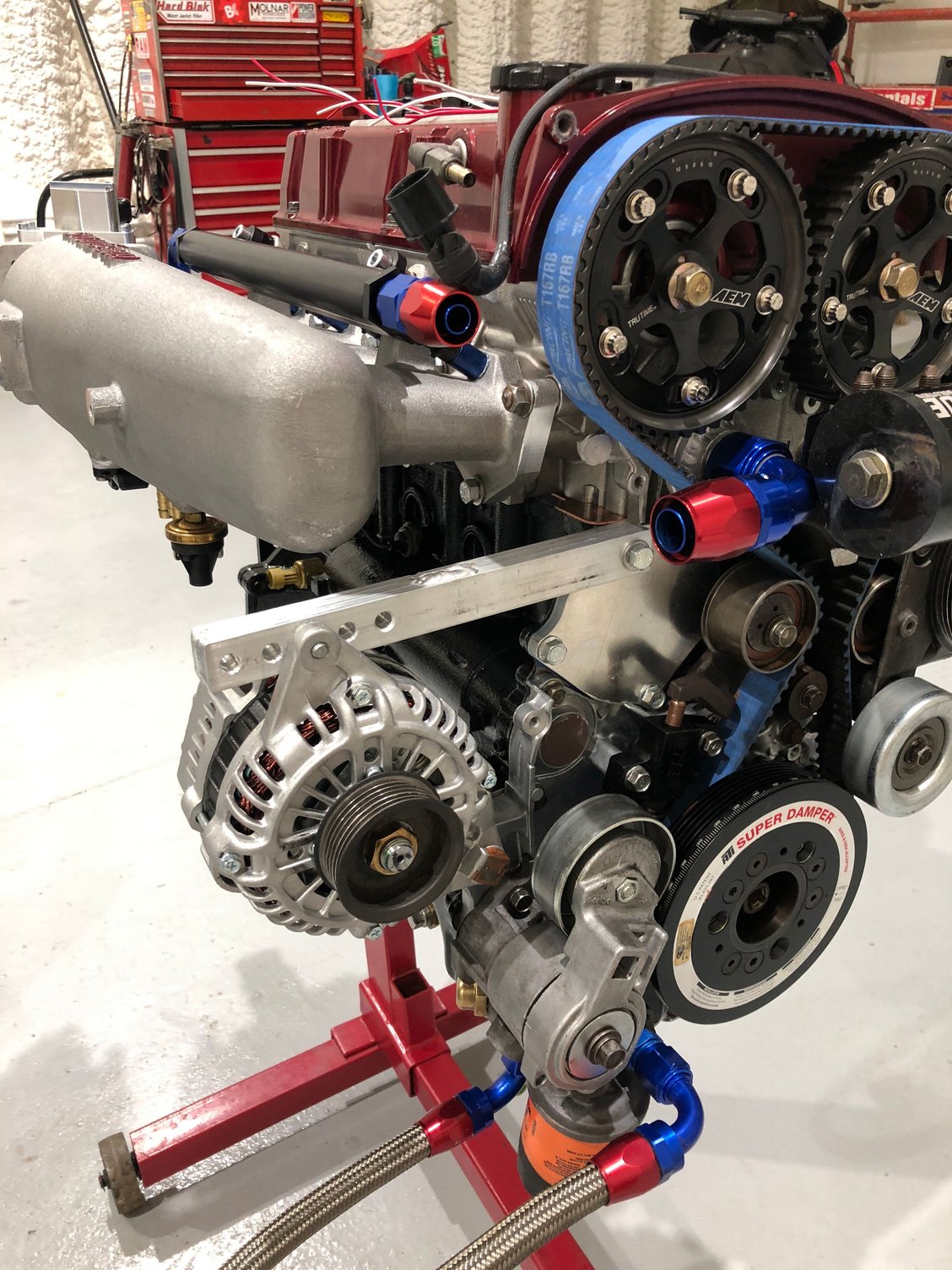

Diched the stock intake for a Magnus V5. Ditched the stock TB for a S90 TB.

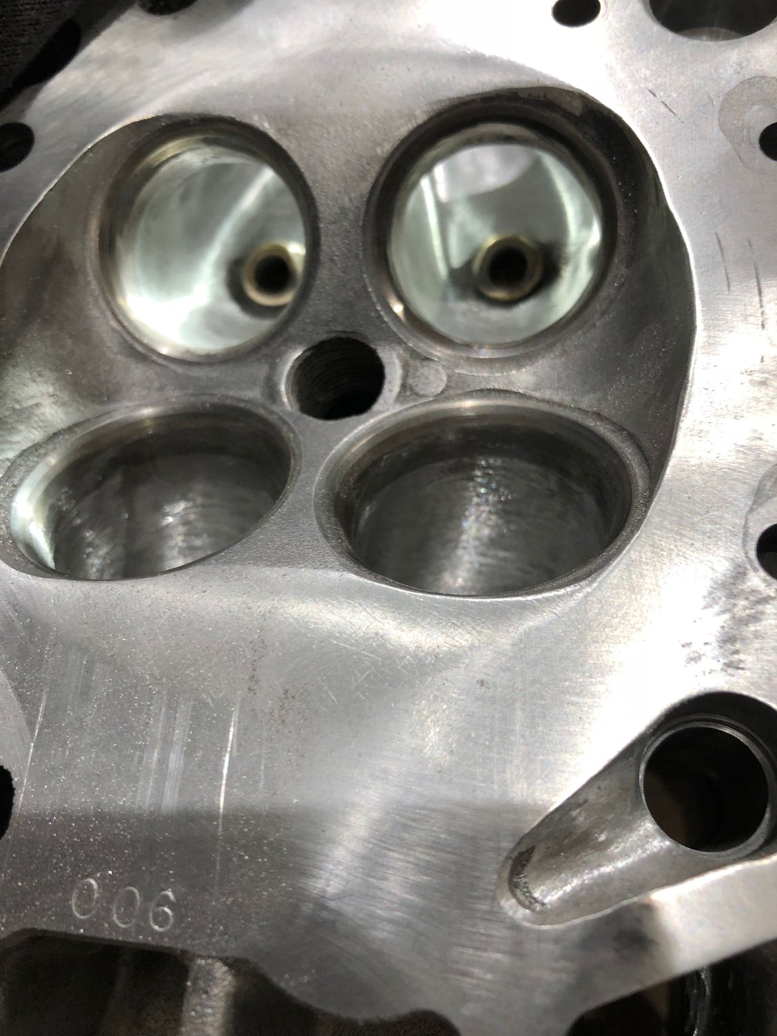

I did a DIY head porting job.
Ditched the stock crank for a billet Manley 88mm stroke.
O-ringed the block and head for use with a copper head gasket.
Filled the block too the top and ported the pistons. I did this to promote better ring seal as I was having blow by issues at +40 psi boost.
Davies Craig water pump. Modified the oil pan even more...lol.
Transmission got Carbon syncros installed.
Ditched the Toyota coil COP setup for a M&W CDI sequential setup.
ECU will remain stock for now.
Omni Power 7 Bar sensor.
Rota slipstreams with 26” Hoosier QTP’s
Almost forgot new stickers on the mirrors “objects in mirror are losing “
Thats all I can think of for now, I’m sure I missed some stuff.

What fuel pump solution are you going to use?
Old Sep 30, 2018 | 07:18 PM
2winscroll's Avatar
Joined: Mar 2014
Posts: 816
Likes: 82
From: wisconsin
Twin AEM 044’s
Calculated horsepower they are good for 1200hp @ 100psi rail pressure (50 psi base + 50 psi manifold on E85).
I’m running 55psi base pressure 2150’s so I guess we will find out?!
Old Sep 30, 2018 | 09:19 PM
Pirana's Avatar
iTrader: (43)
Posts: 1,222
From: Arlington, TX
Thats what Im running...but my tuner told me it wasnt enough for e85....
