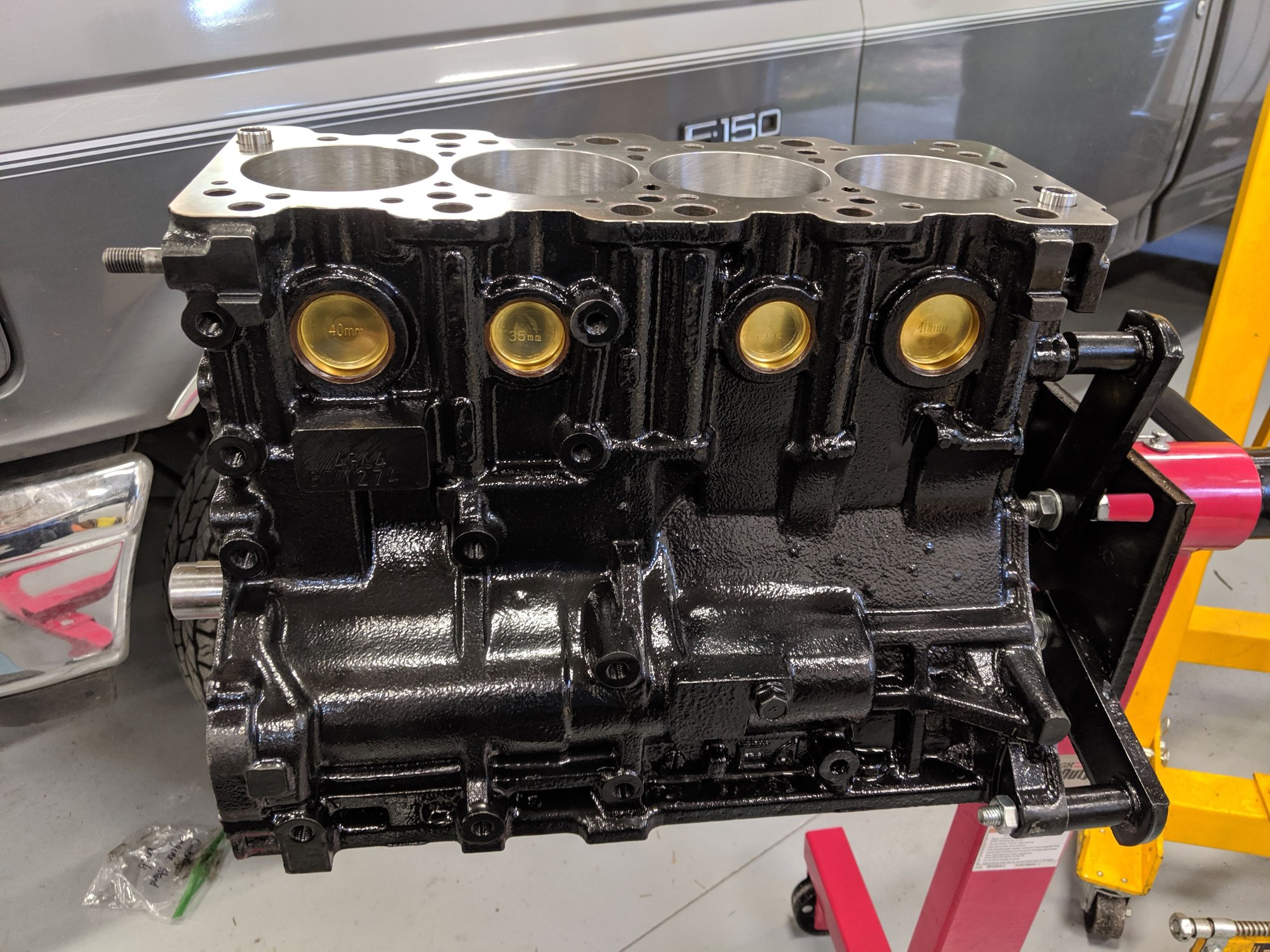

I'm super excited for all the pretty parts to get back on the car. In order for all that to happen, the fun stuff has to take place: getting the motor assembled! The first big step was picking up the block yesterday. I'll post specs of everything below.
Specs:
4G64 block
2.4L crank, 100mm stroke
Crank cryotreated
Manley 2.4LR pistons 156mm/100mm
Manley 2.4LR rods 156mm
ARP main studs
ACL main bearings
ACL rod/thrust bearings
ATI harmonic balancer
Kiggly HLA
English Racing 2.4L water pump
Balance shaft delete

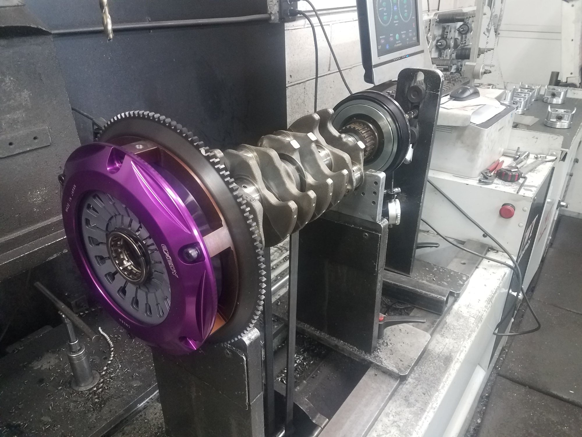

All the oil galleys got rolled and smoothed. All the cylinder walls got honed. Everything got weight balanced and rotation balanced (I have the spec sheet in the box of parts). I'm really excited to get all of this put together and get it mated with the head. Which, that should be done next week. As soon as I have that back, I'll list out the specs for that too. In the mean time, I have a lot to do to get the car ready for her new heart. I have new stainless braided brake lines to install, a new exhaust to install, and an engine bay to clean. And the rest of the block to assemble. Best to get to work!

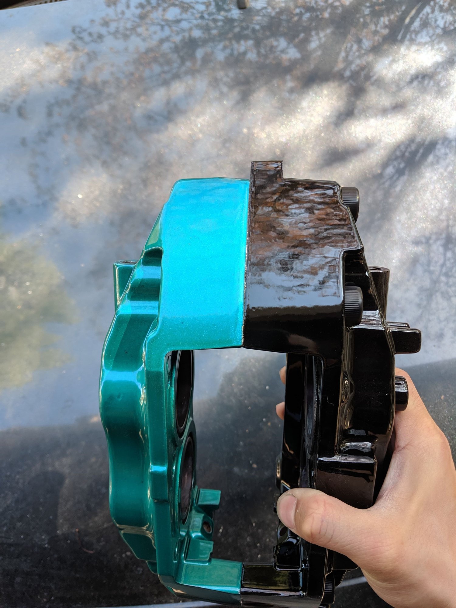

My valve cover and brakes are 100% done and assembled. I love how everything has turned out so far, and am definitely excited to get it all back on the car.

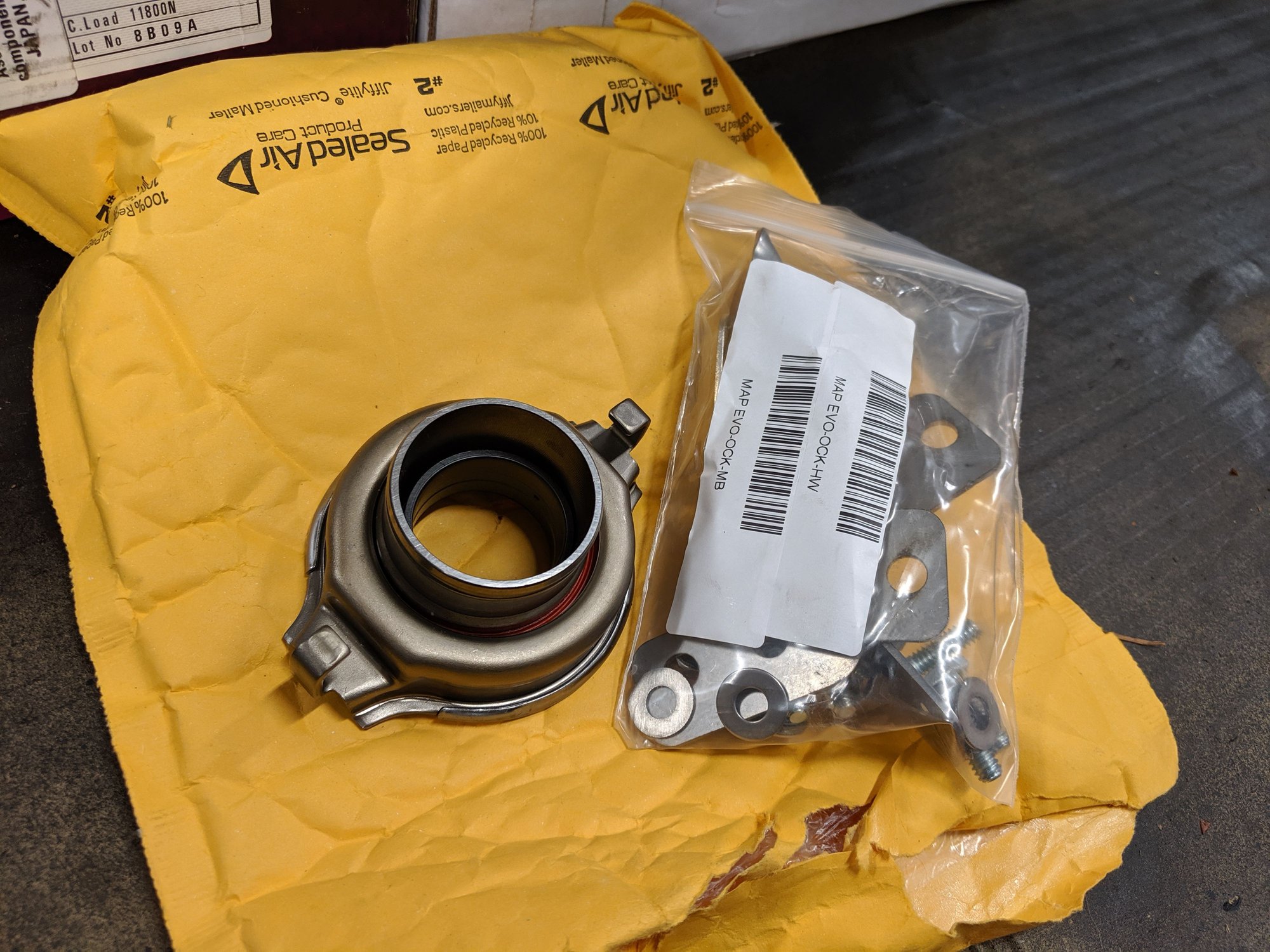

I also picked up a bunch of other parts necessary for the build.
Radium clutch fork
Exedy HD twin disk clutch
ARP head studs
New front oil case
Progress is happening, and I'm stoked to see everything finally coming back together.

The brakes are a lighter color in the sunlight? If so that is pretty nice.
Yeah, the color definitely is lighter, more blue-ish in the sunlight and more green-ish when in inside type lighting. It's super cool; I love it. I can't wait to see how everything looks on the car and get some really nice shots of everything.

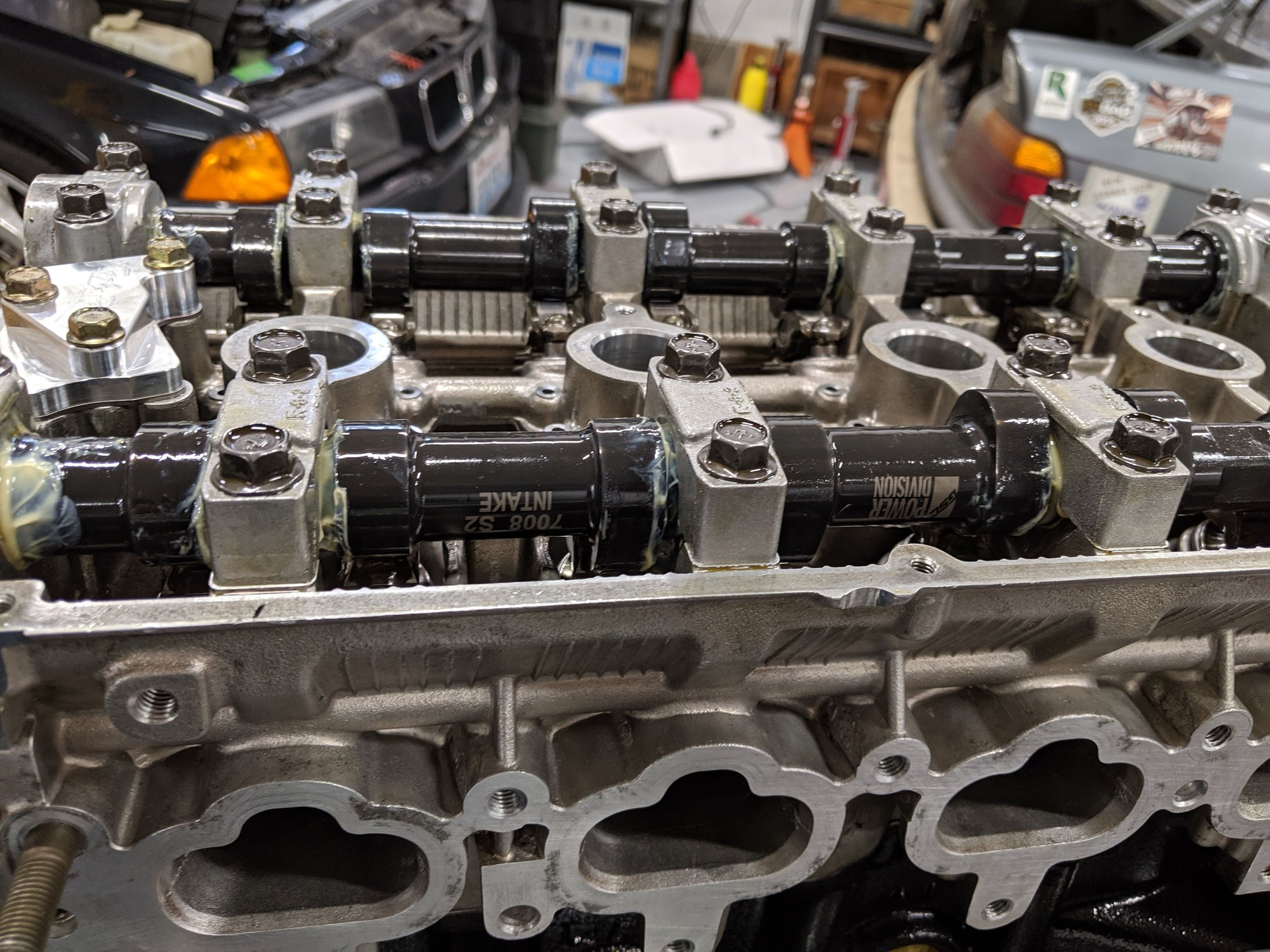

Update again!
The head is complete and back from the machine shop!! I am super excited to have this back in my possession Now I'm just waiting for the gasket set that I ordered to come in so I can start assembling the motor as one piece
Specs:
GSC S2 cams 272/272
Titanium beehive valve springs & retainers
Manley valve keepers
ARP L19 head studs
GSC intake/exhaust +1mm valves
GSC no-tick lifters
GSC valve seals
MLS head gasket
Bronze valve guides
EGR delete
I am getting really excited to see everything starting to come back together. It's already been 9 weeks since the motor blew up, and I miss driving the Evo every day. I cannot wait to take her for a spin!
