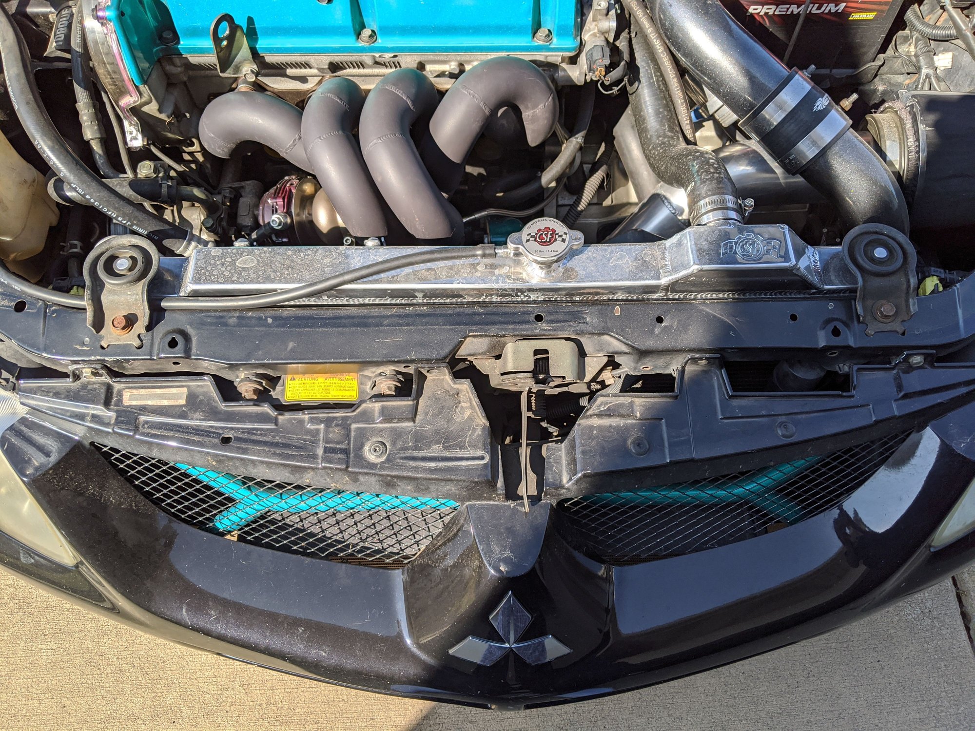

Just installed the CSF Race radiator yesterday. I was wanting to stick with the OEM fan, but it just wouldn't bolt up to the spots that were on the radiator. The fan that came with it was actually bigger in diameter than the OEM one, so we'll see how it does. I let the car idle for like 10-15 minutes to see how temps held up, and it seemed to do fine.
Yes, I believe it was designed with the intent of using the aftermarket slim fan. I am sure that the routine normal driving that people do is fine with this slim fan. I might compare both at a Track day since I have them in my possession and can log coolant temperatures. Maybe turn it into a production that is in the spirit of Mythbusters .

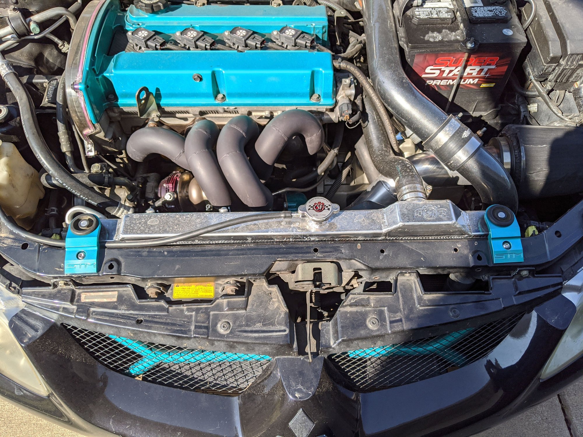

I got some new radiator mounting brackets to go with everything else in the engine bay.

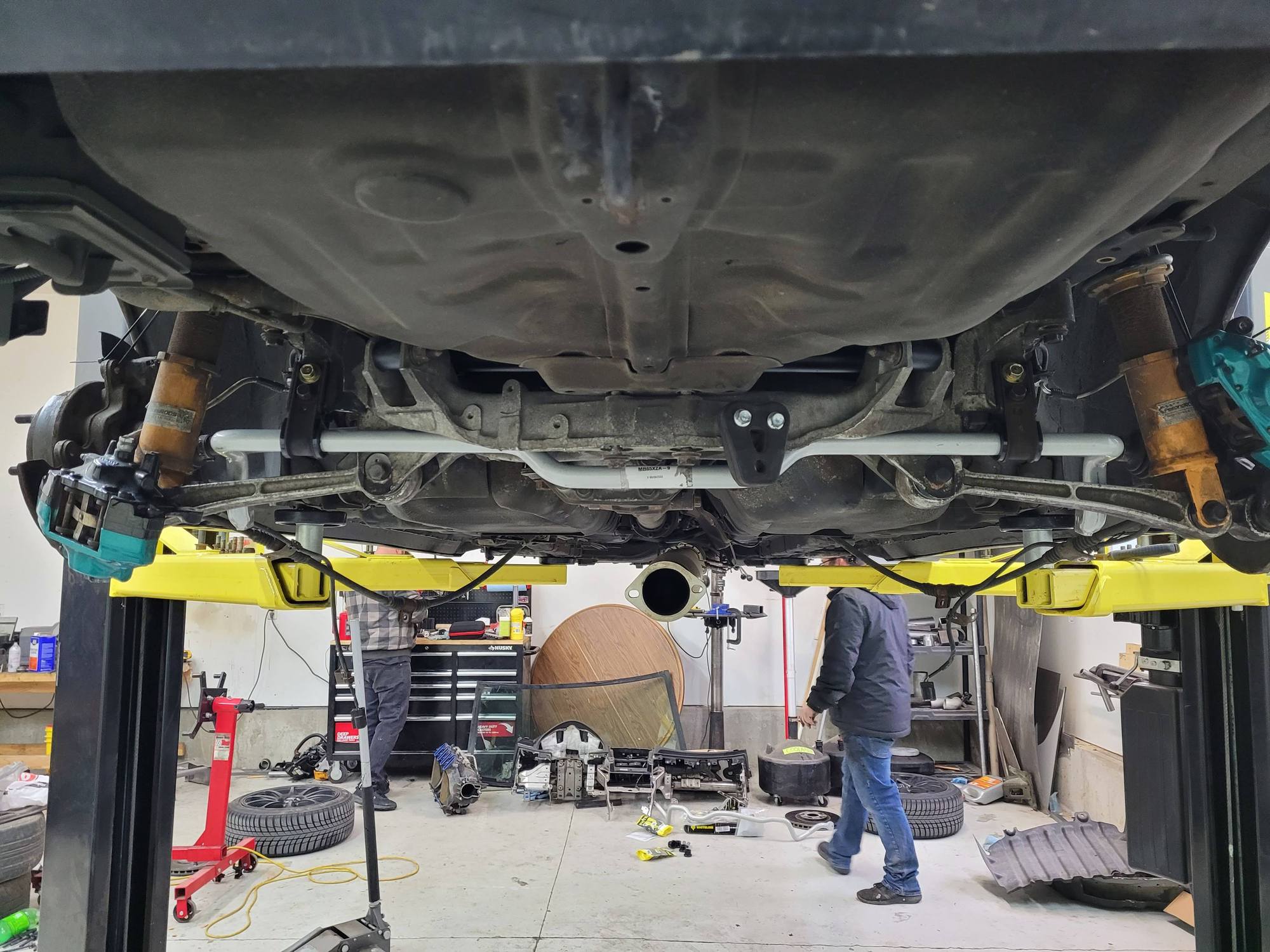

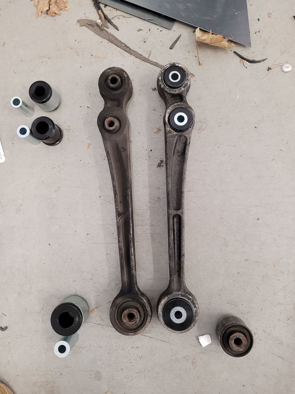

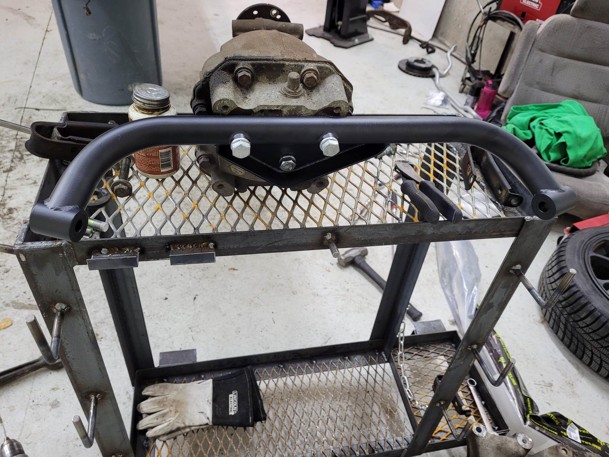

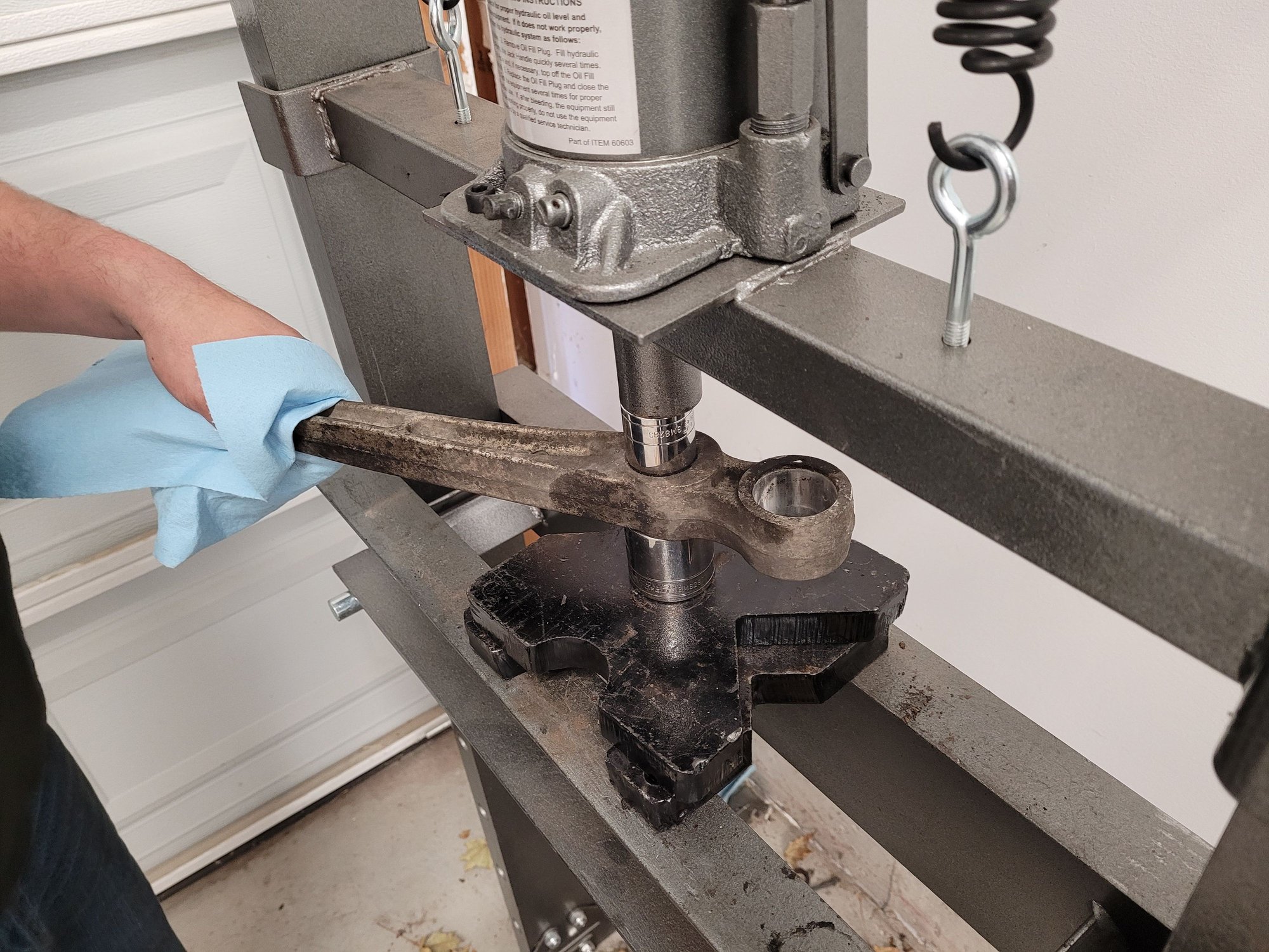

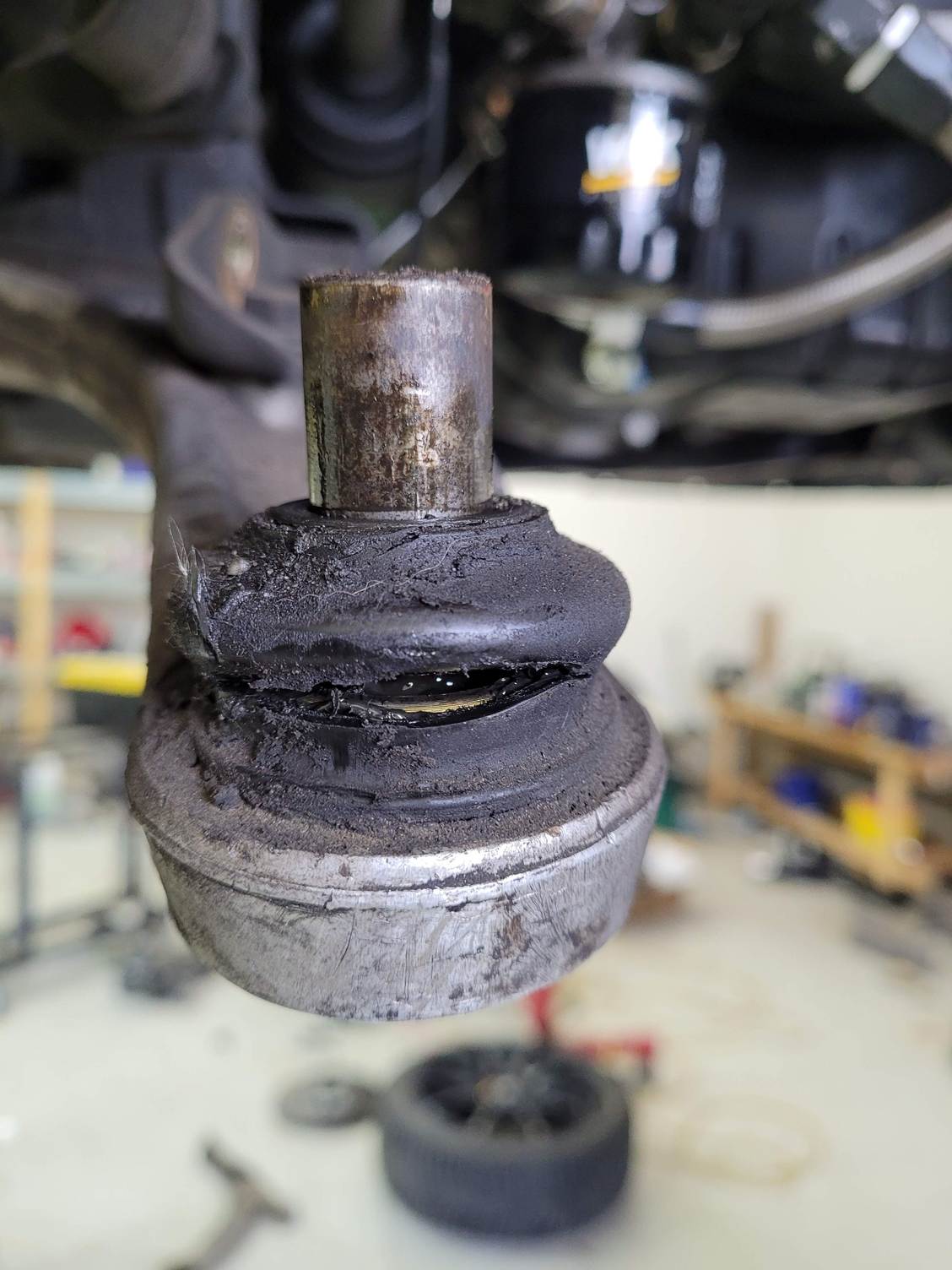

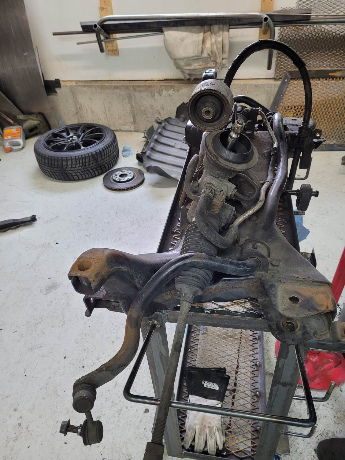

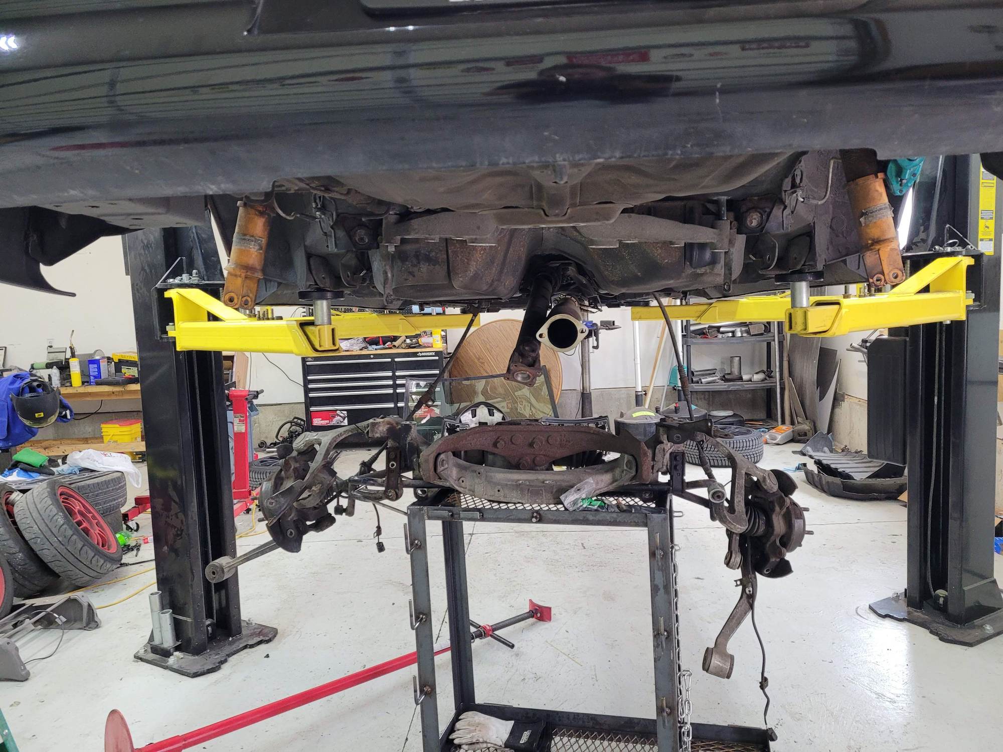

Then I started in on the next big project with the Evo: the suspension overhaul. She has needed it ever since I bought her 3 years ago, and I feel bad it's taken me this long to address it. As I was disassembling everything, I got an eyefull of just how bad it was. All 8 ball joints on the car looked like this photo, the LCA (front and rear) bushings were trashed, and the rear diff carrier bushings were hardened solid. It was just a mess under there. SO! I opted to get Whiteline everything.
One of 8 trashed ball joints.

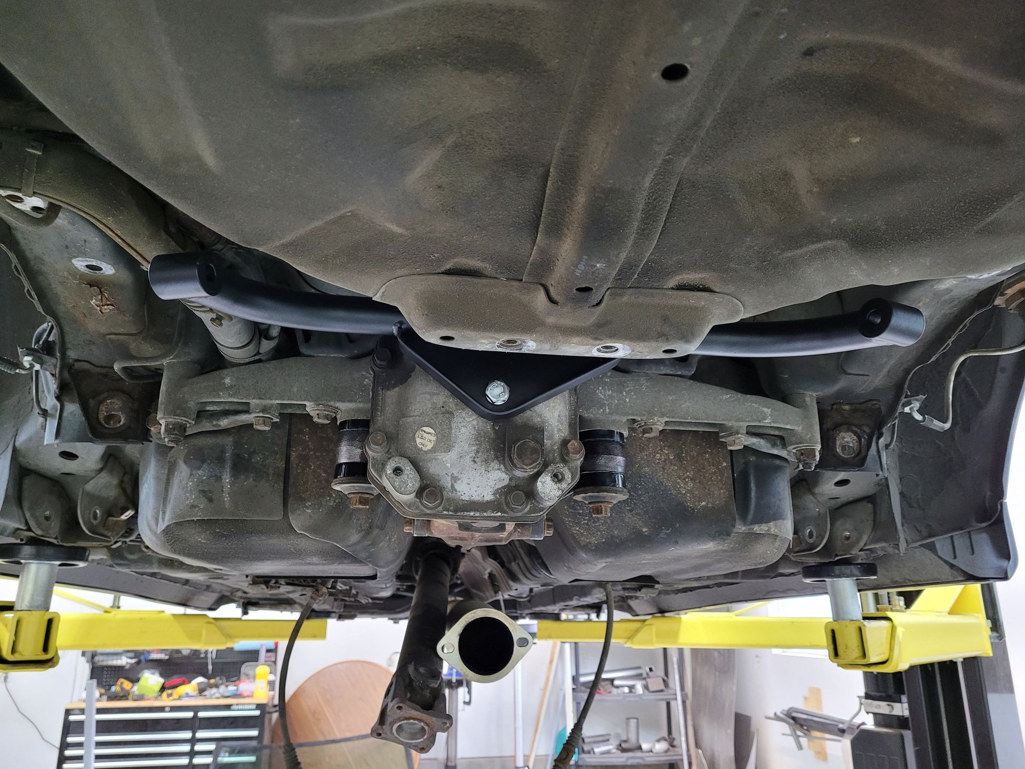

Rear subrame came down to get access to everything that needed to be swapped out back there.
Old mustache bar vs the STM replacement. MUCH lighter than OEM.
Whiteline rear sway bars included in the overhaul.
Got the caster adjustment bushings for the front LCA, along with the roll center bump steer correction kit.

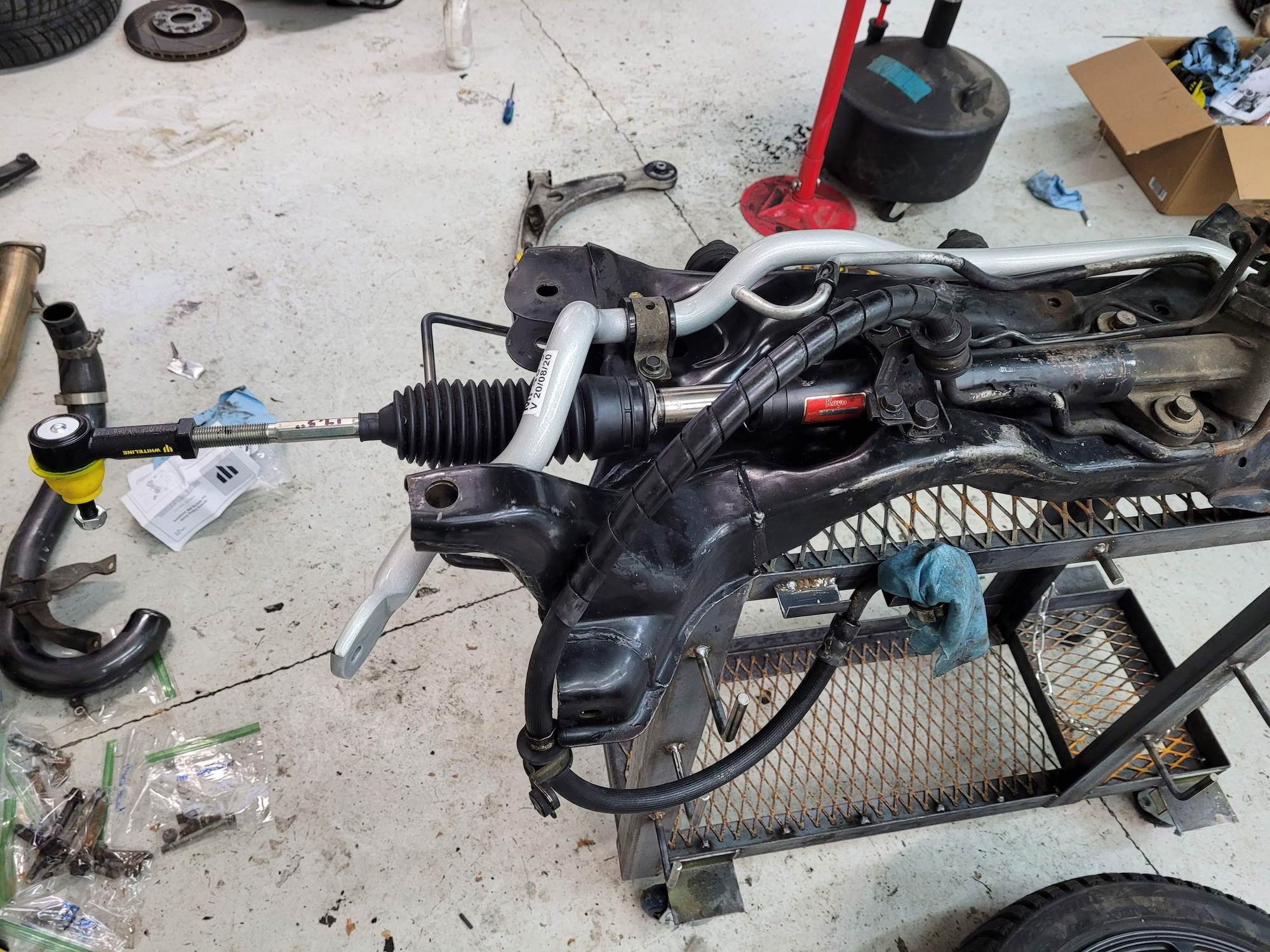

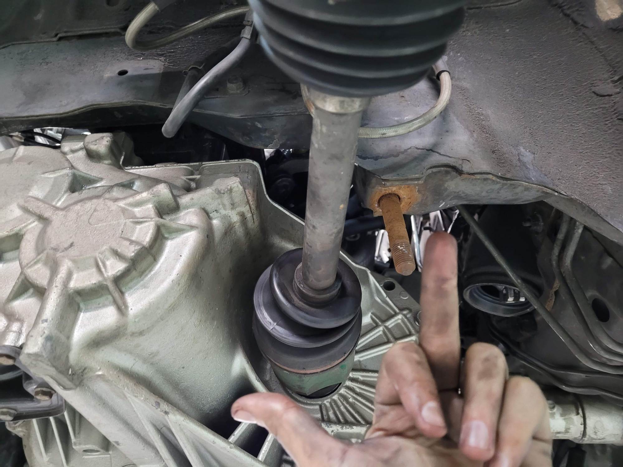

Dropping the front subframe turned out to be a bigger challenge than anticipated, due to the driver side vertical bolt in the frame rail putting up a MASSIVE fight. Hooray for rounded corners...

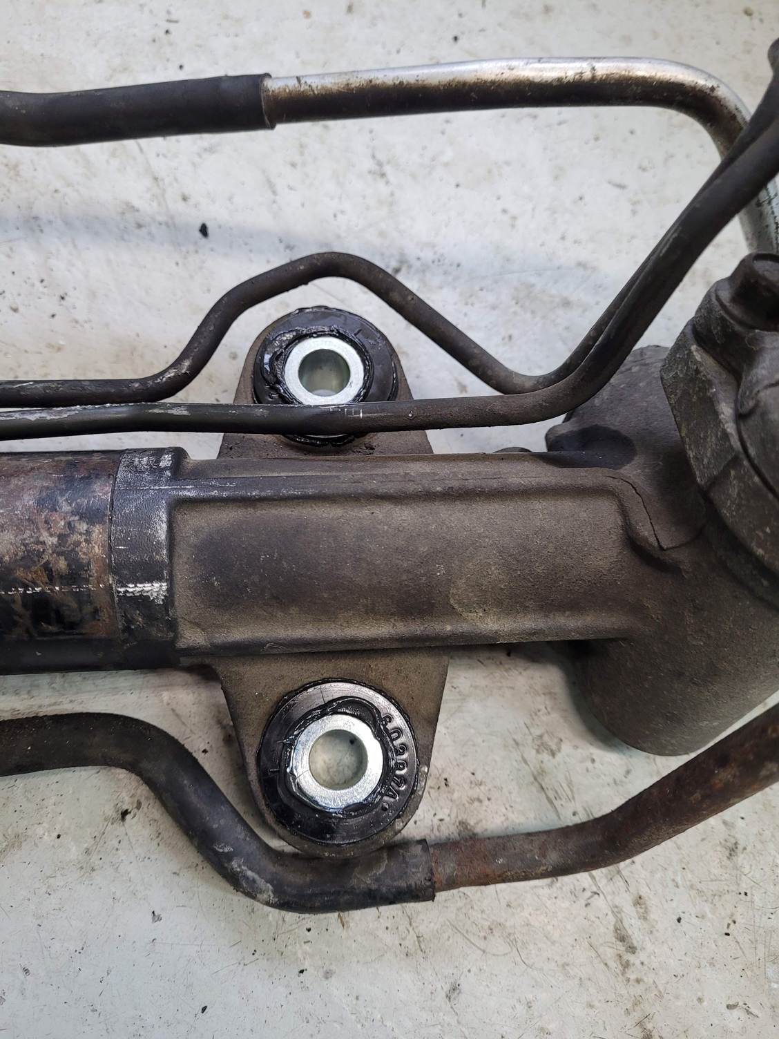

Got all new power steering rack bushings as well.
New front subframe setup.

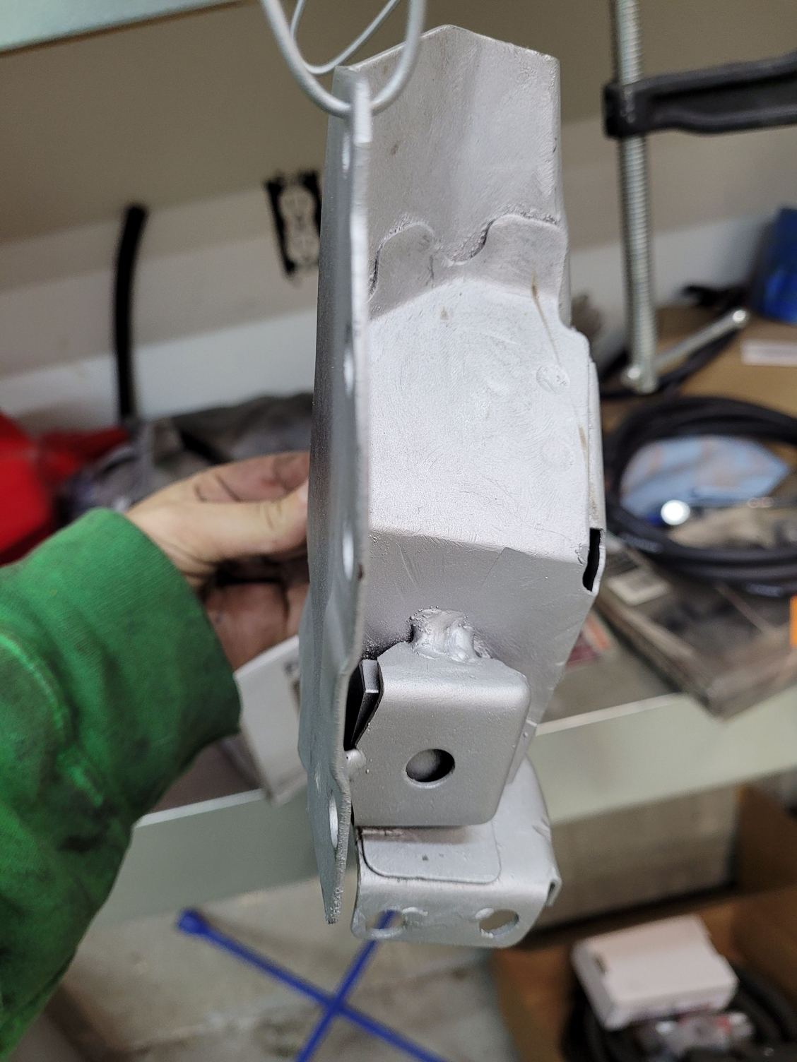

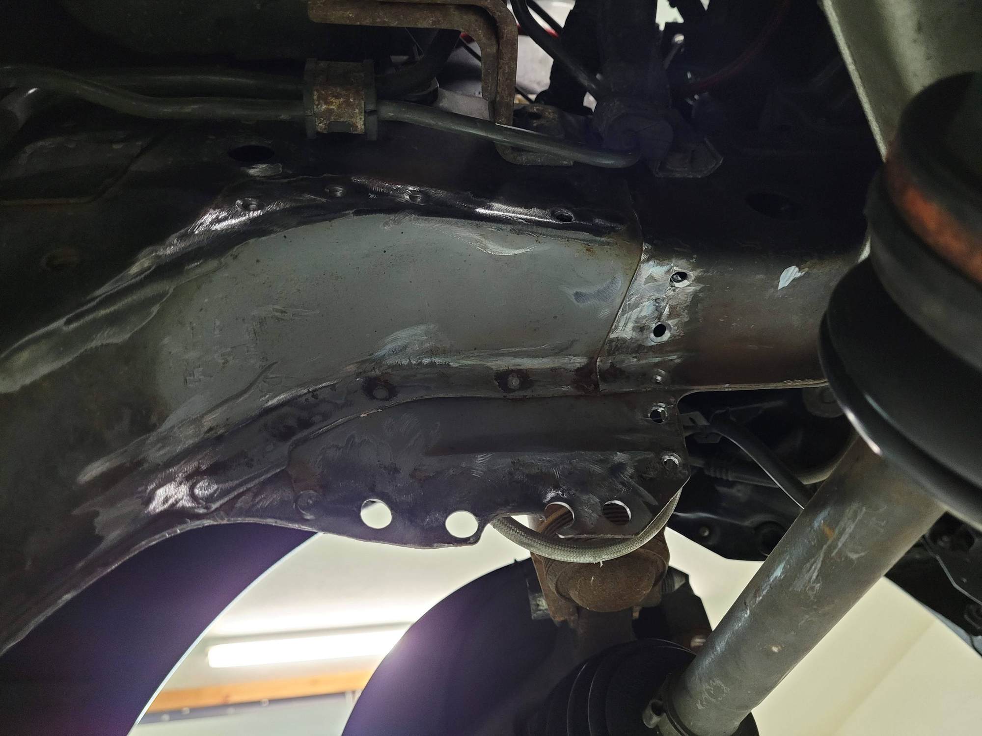

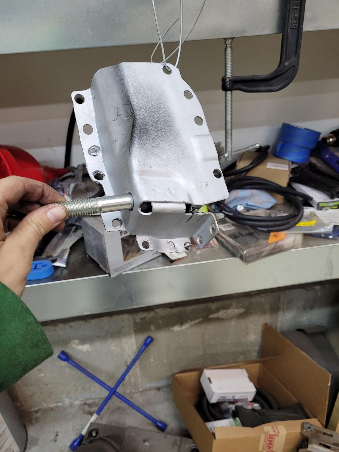

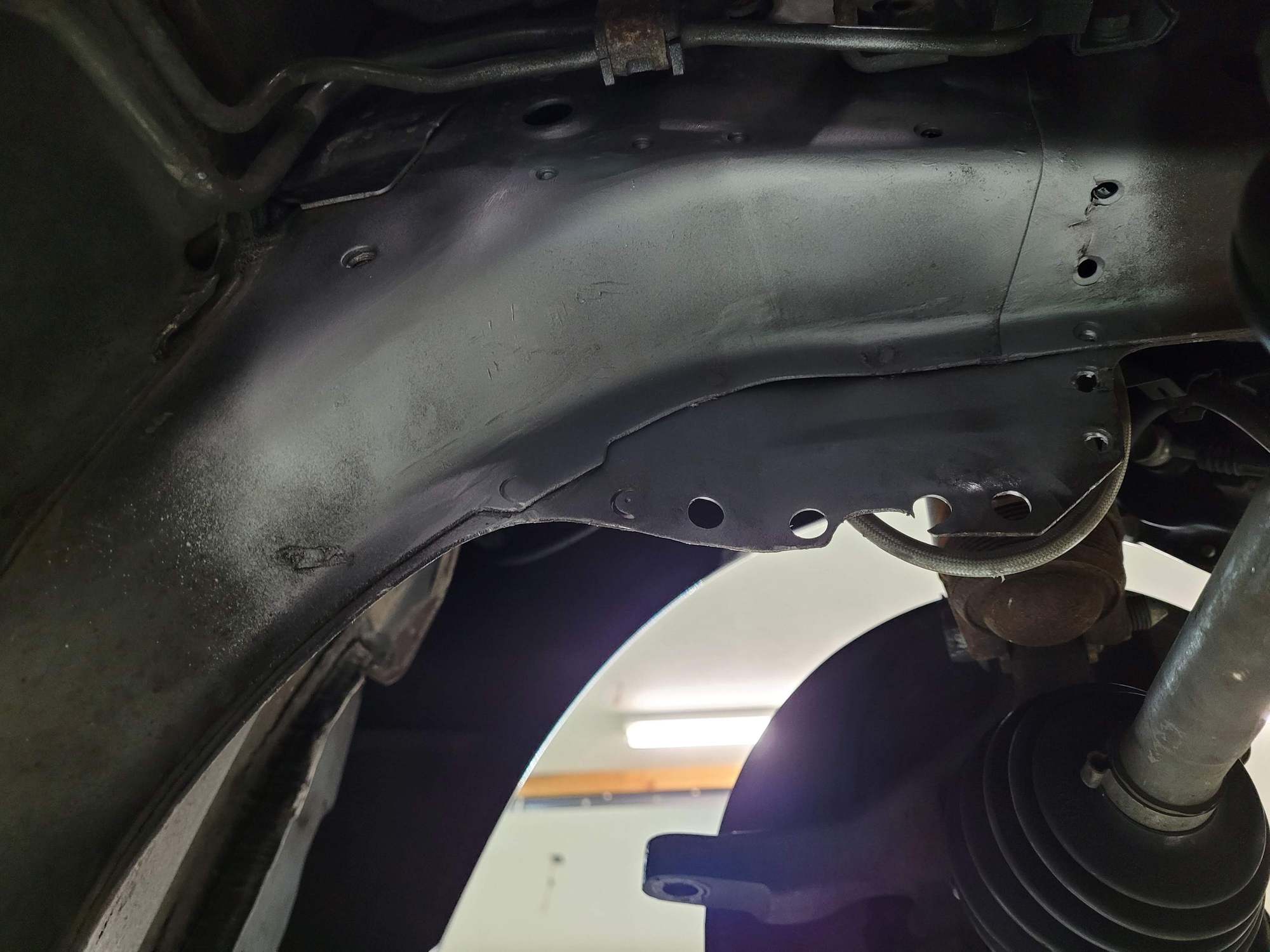

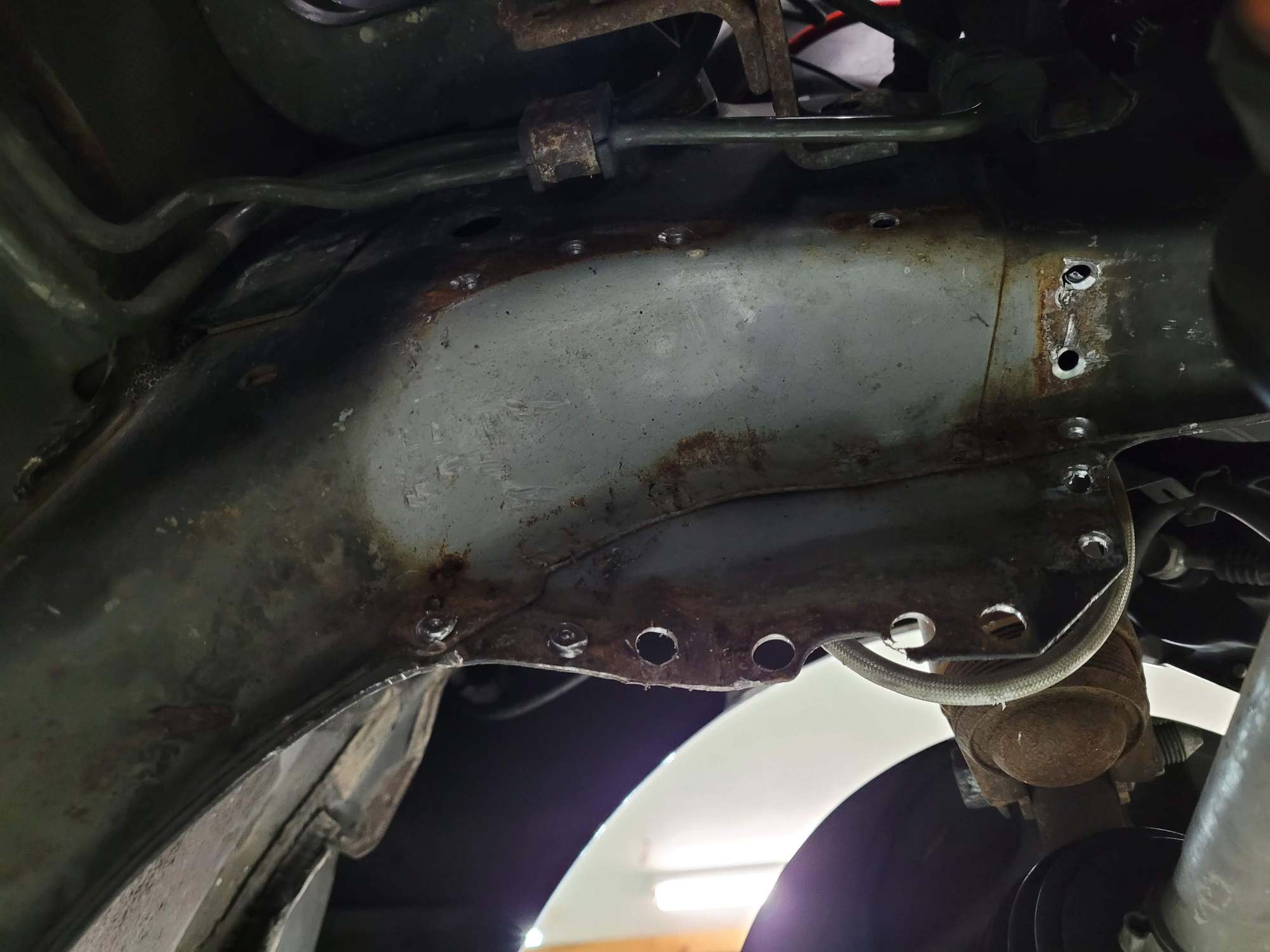

This bolt.... I hate this bolt. It was just spinning and spinning inside the cage-box thing inside the frame rail. Obviously, that had to be addressed and fixed. We opted to drill out the spot welds holding that front corner on in order to replace the damaged bolt. Got the corner of the frame rail all cleaned up, painted with weld-through primer, got a new bolt and created a much bigger square head that fit inside the cage better (I forgot to take a photo of that before we got it welded back inside the cage; you can kind of see the head of the bolt in the photo below from when we painted it), and got it all painted up in prep for welding back up. That's tomorrow's task.
The suspension overhaul has been a much bigger project undertaking than I originally anticipated, but it's going to be SO incredibly worth it. I can't wait to take her for a spin!

It all got welded back into place and painted. Here's to hoping it never has issues again.

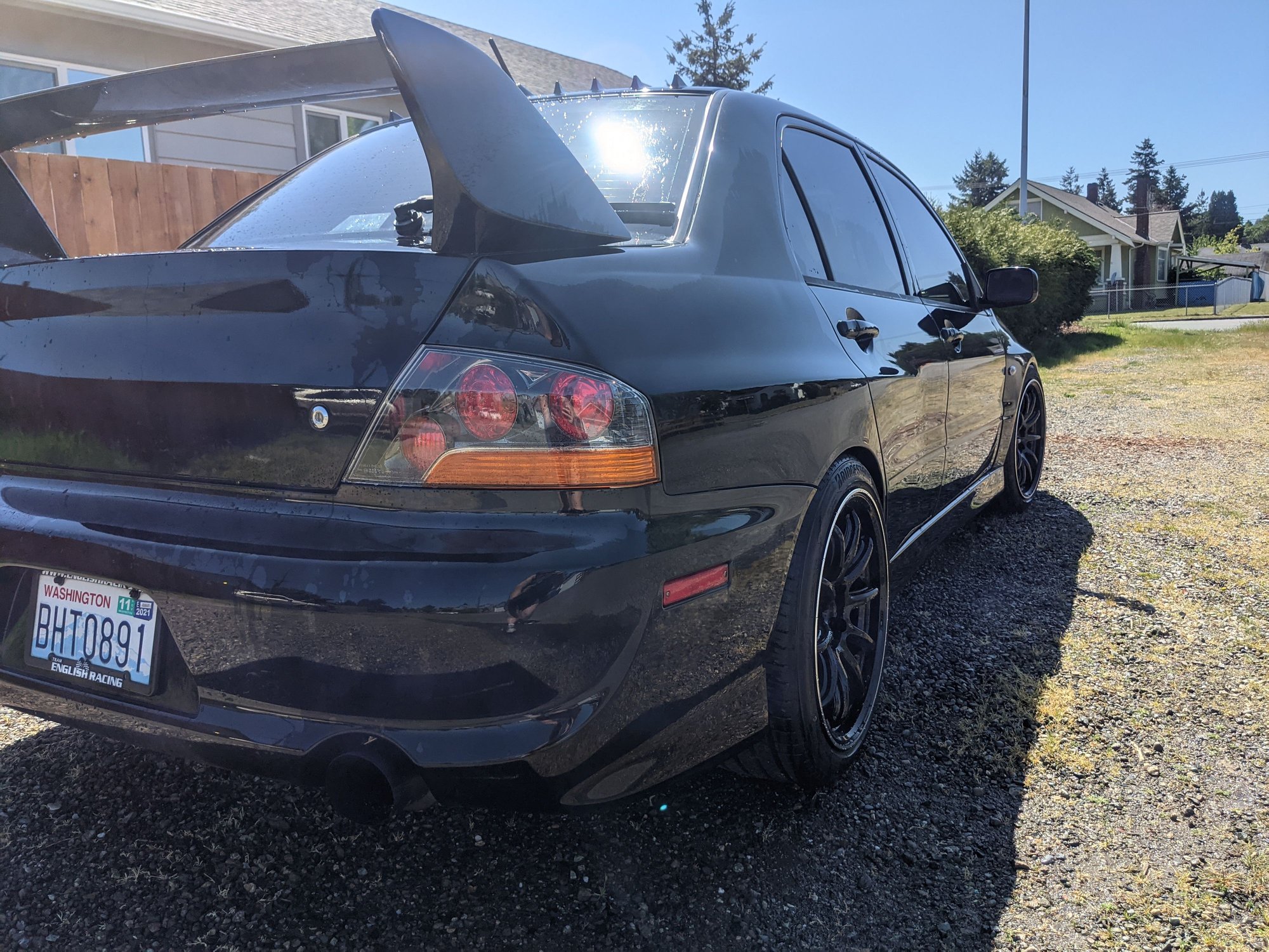

I think her new shoes and eyes look stunning. I'm happy to have her back on the road after an excessively long wait for the headlights to ship from Japan. Our first really nice weather weekend was this past weekend, and I was able to get her all washed up and out for a drive. Feels amazing.
