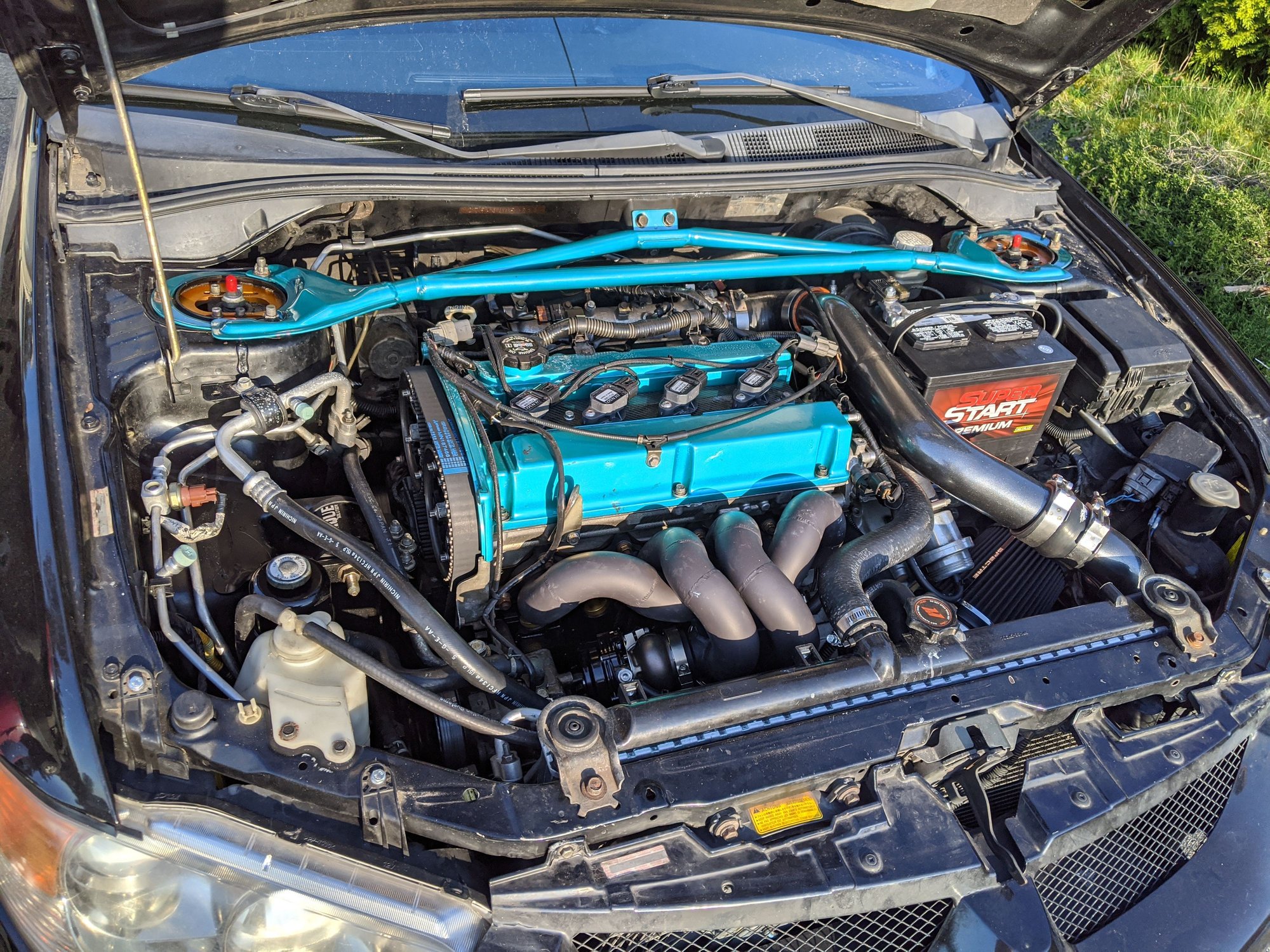

Better engine bay shot.

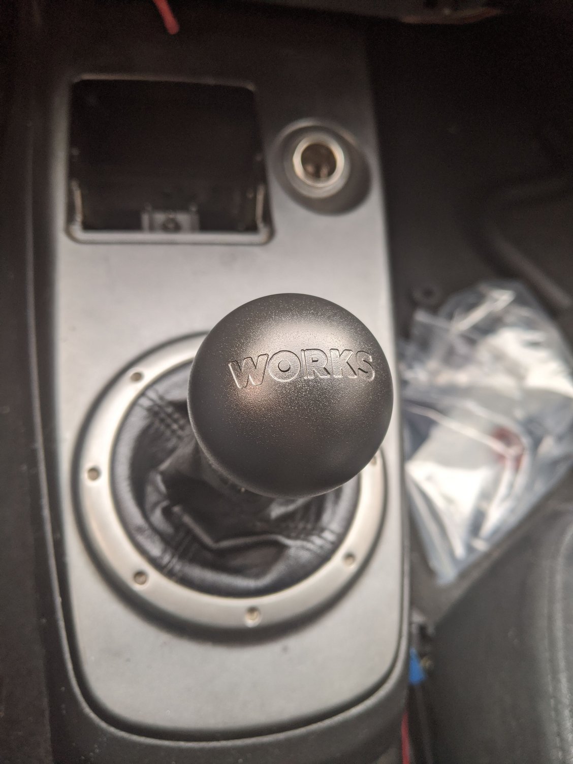

Got a new short shifter and replaced the bushings. Feels so much better now!

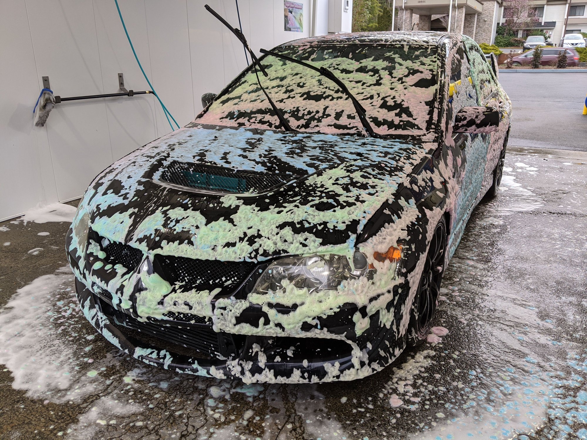

Giving this car a bath is super satisfying.

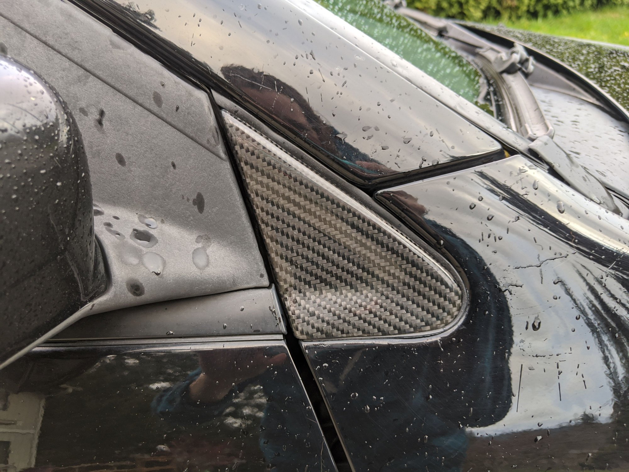

One of my close friends got me some carbon fiber j-panels for Christmas, and I finally took the time to get them put on.

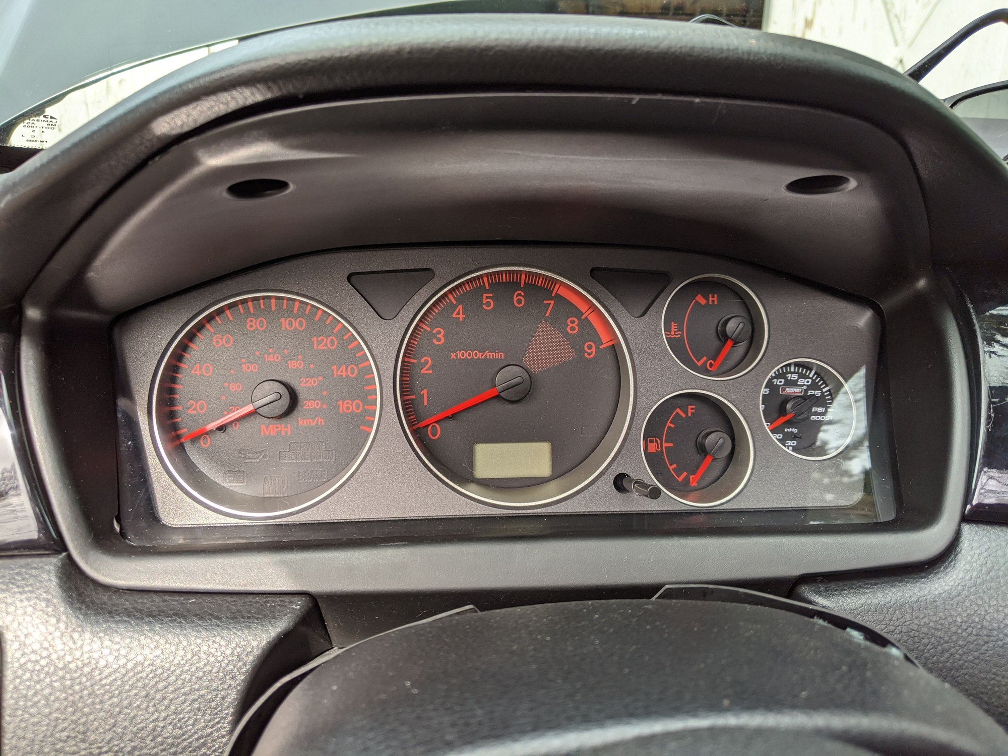

Had an issue with my oil light coming on while at idle, and about had a heart attack that the motor had s hit itself. I went through the whole process of draining the oil and checking the filter for metal flakes and all that, and everything looked just fine. My oil pressure gauge had a loose terminal that made it to where it wasn't reading all the time, so I took the time to get that working reliably. At idle, she holds a consistent 30psi, and 90 at cruising speeds, so that confirms that everything is fine and points to a faulty engine block sensor. I got that replaced, and everything behaved as it properly should. Big sigh of relief. I also got my new boost gauge hooked up, got the other gauges wired in better so they actually turn amber when the headlights come on. I also managed to get the wastegate vacuum hoses rerouted away from the exhaust manifold. Lots of little things worked out, and I'm super happy with how things are running now.

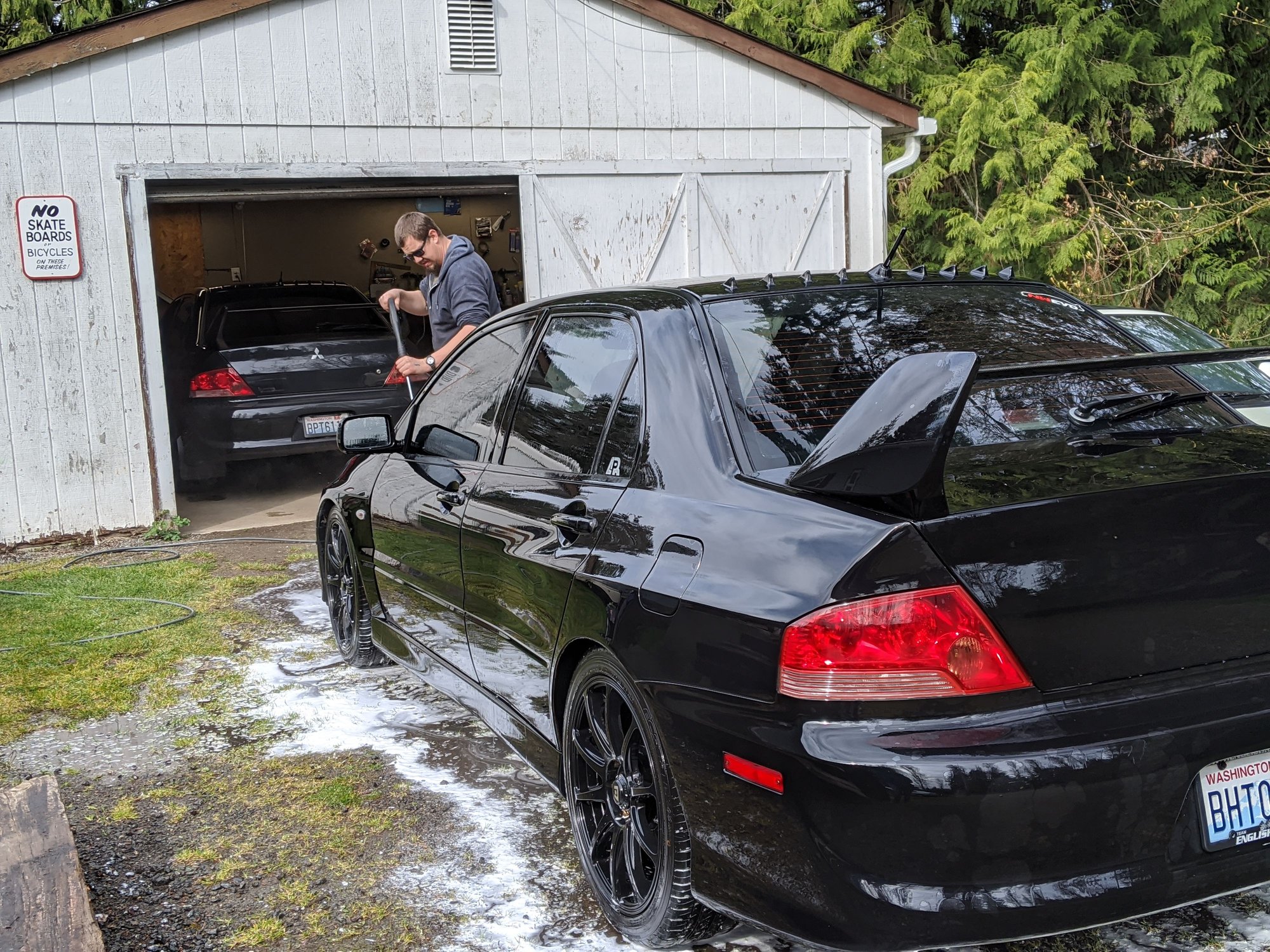

She sure looks pretty all cleaned up.

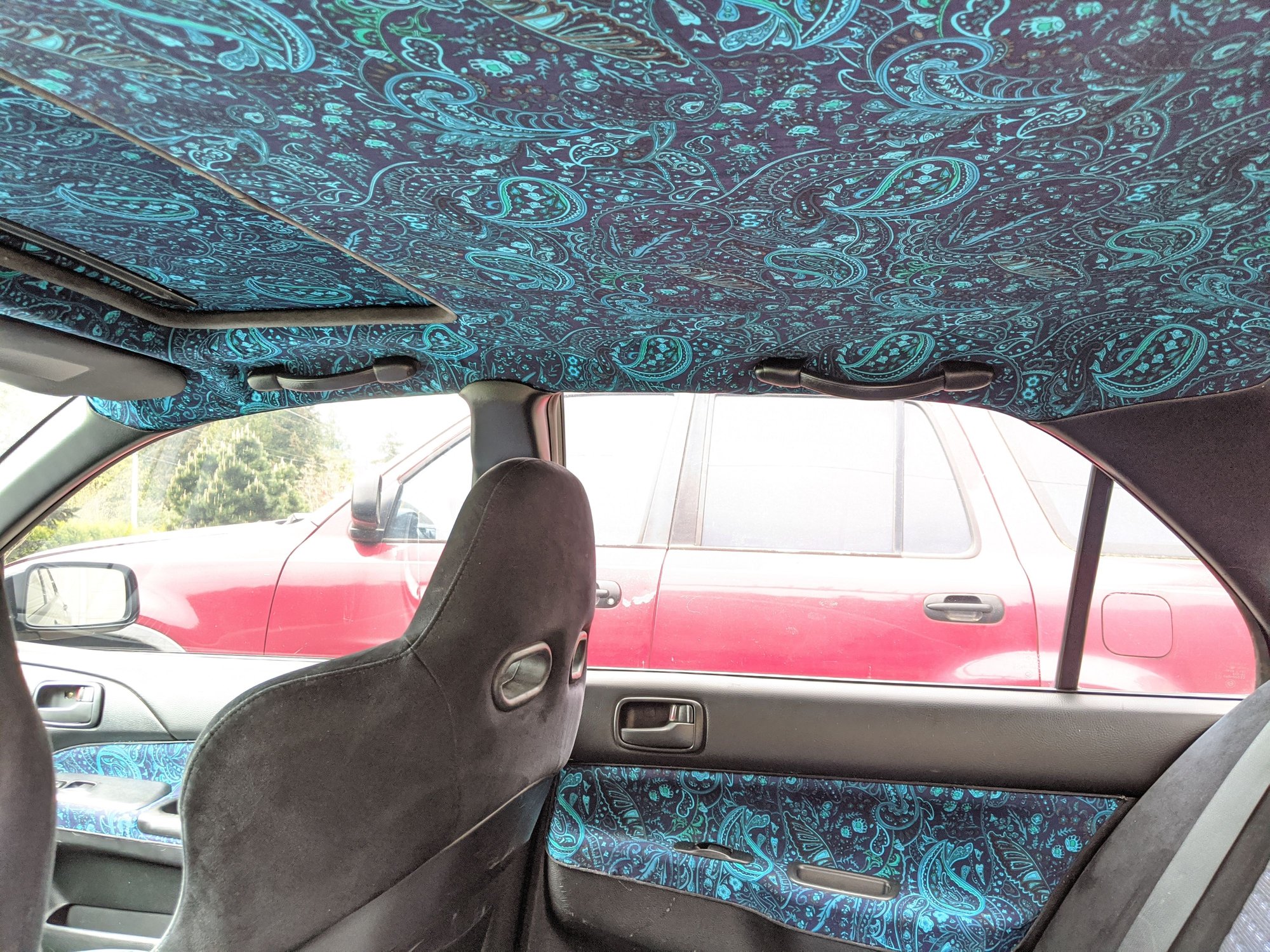

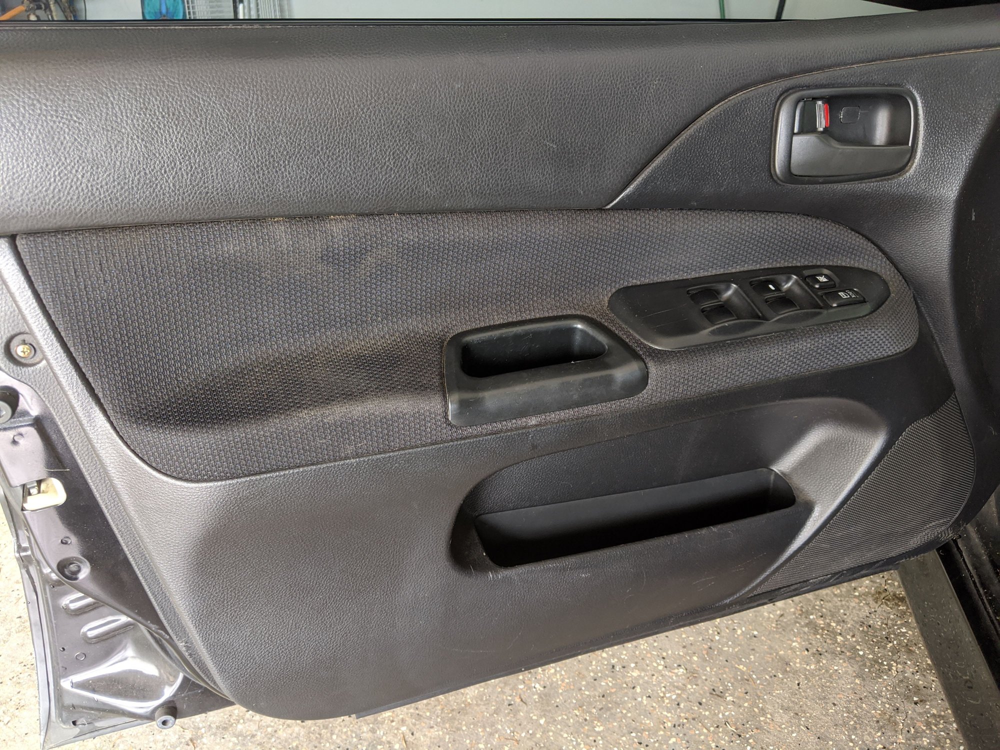

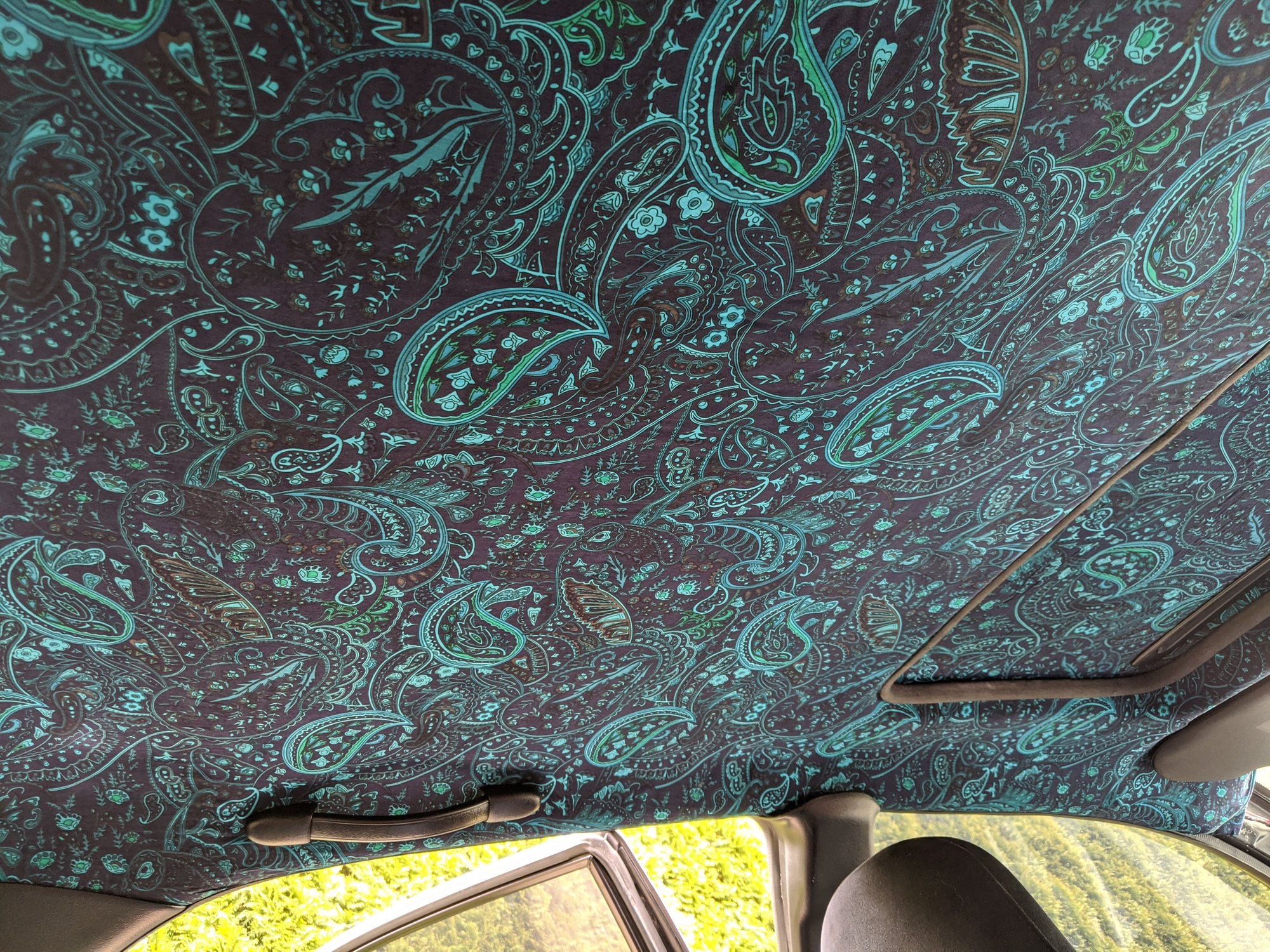

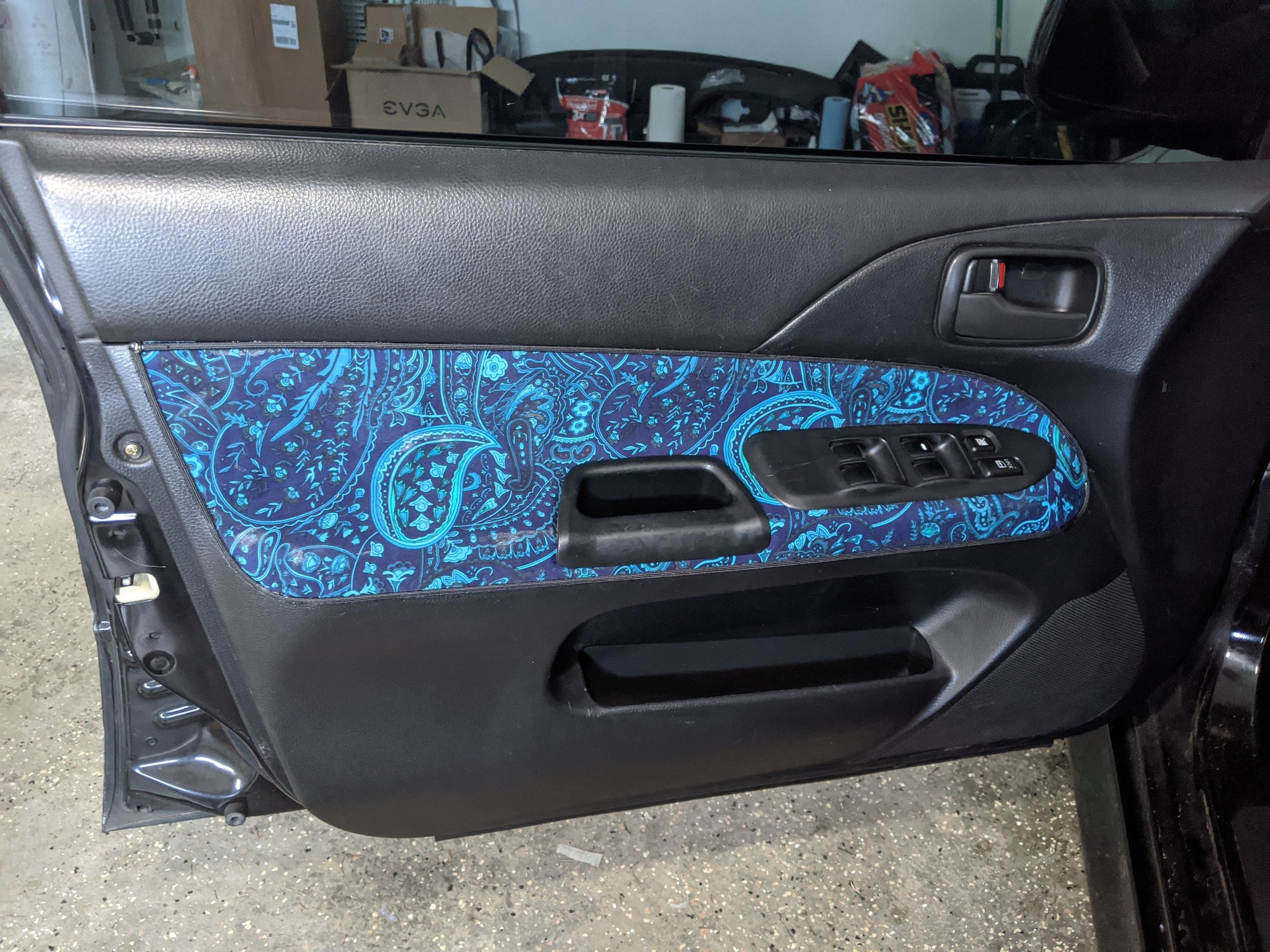

I've also had more time than I know what to do with since the quarantine started, so I got bored of looking at the dingy, boring door cards. I reupholstered them to match how my headliner came out. I'm loving the outcome!

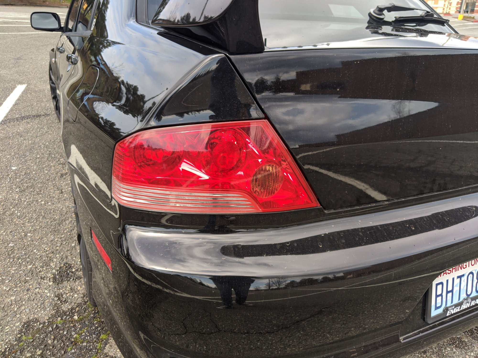

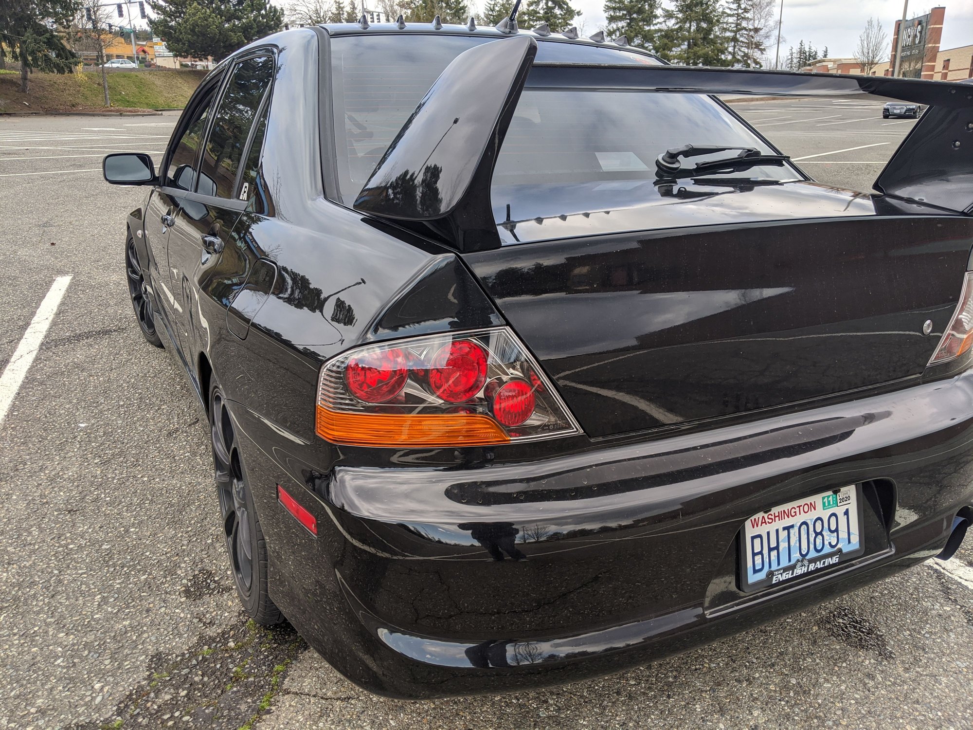

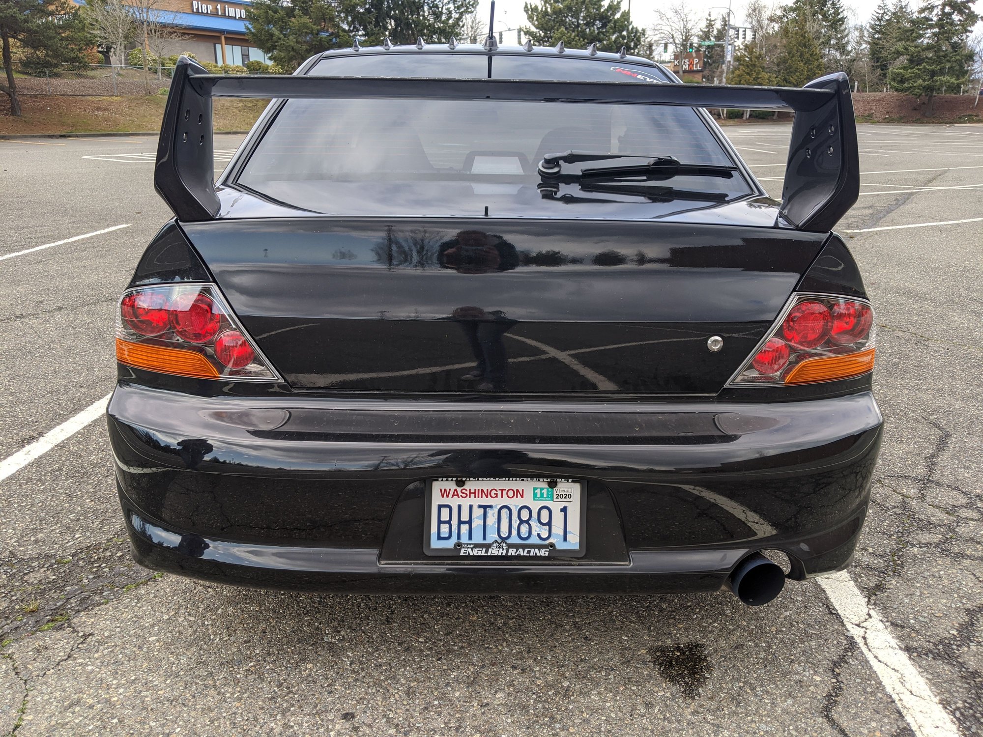

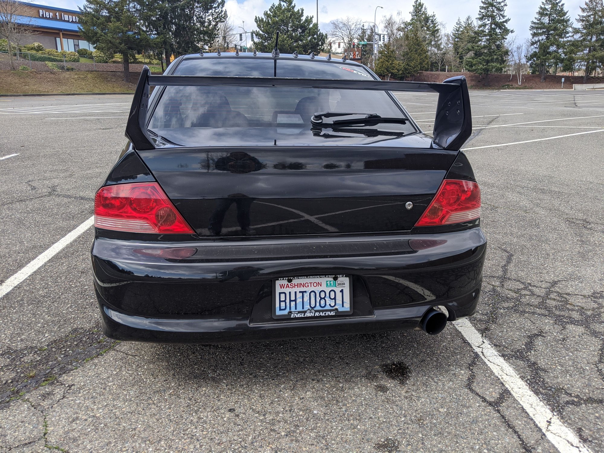

I picked up some new JDM taillights.
Before:
After:
These pictures make them look way more chrome-y than they are, but they're the gloss black housings, and they look amazing.

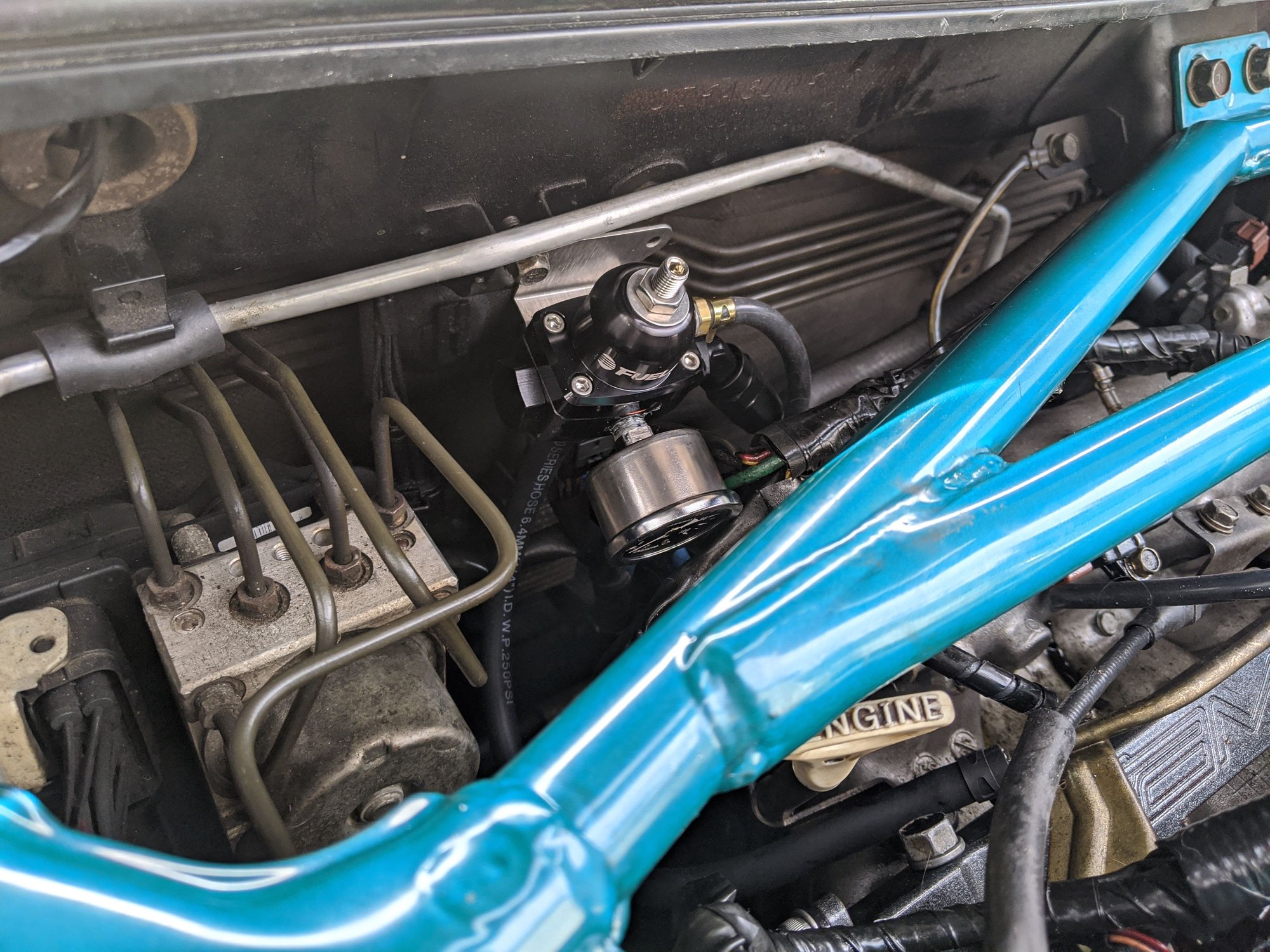

I also finally installed my Fuelab FPR w/gauge.

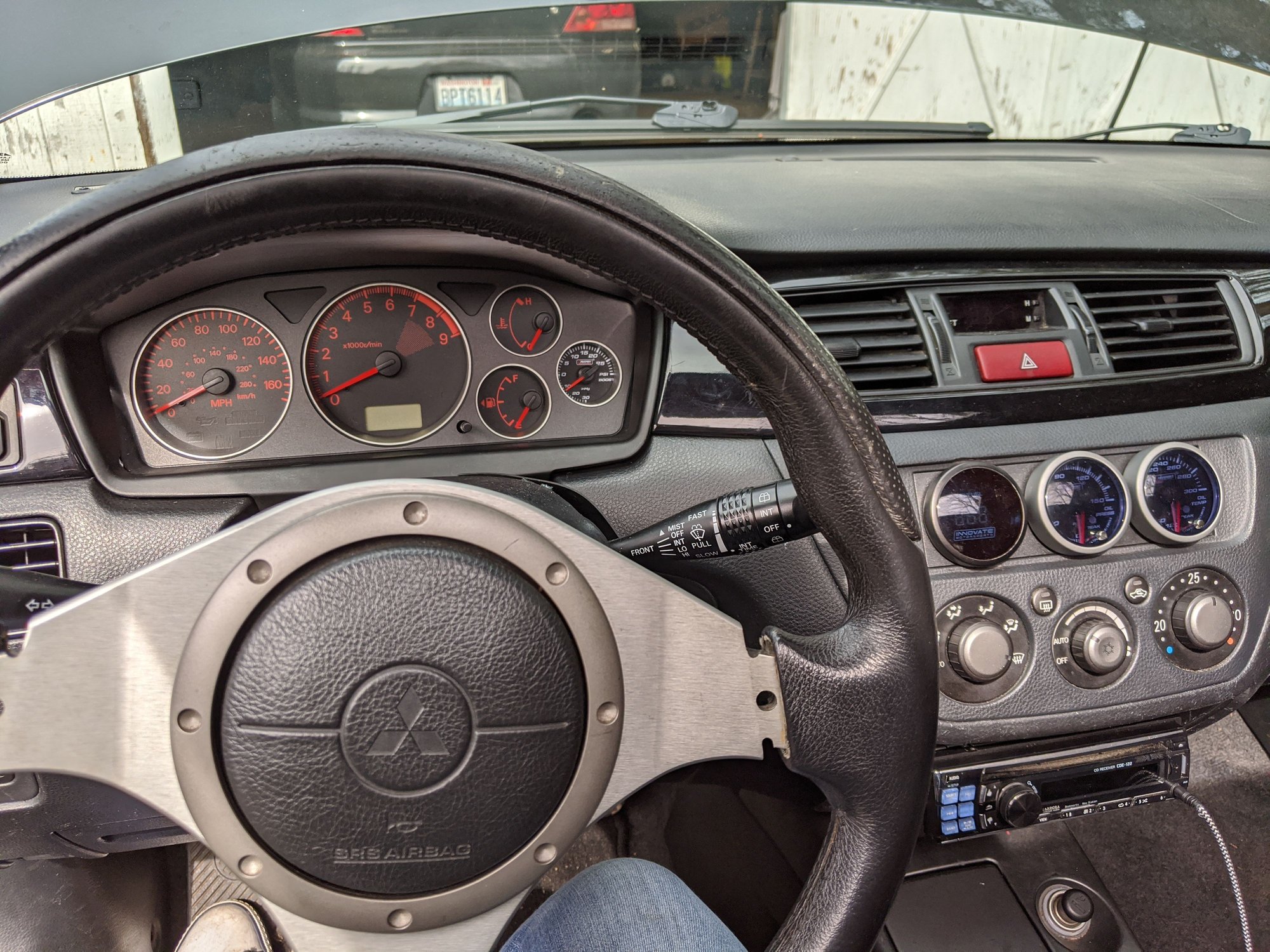

View of the cluster with the boost gauge installed.
Center dash with all the gauges, JDM hvac, and radio.
The cockpit view sure is nice these days.
