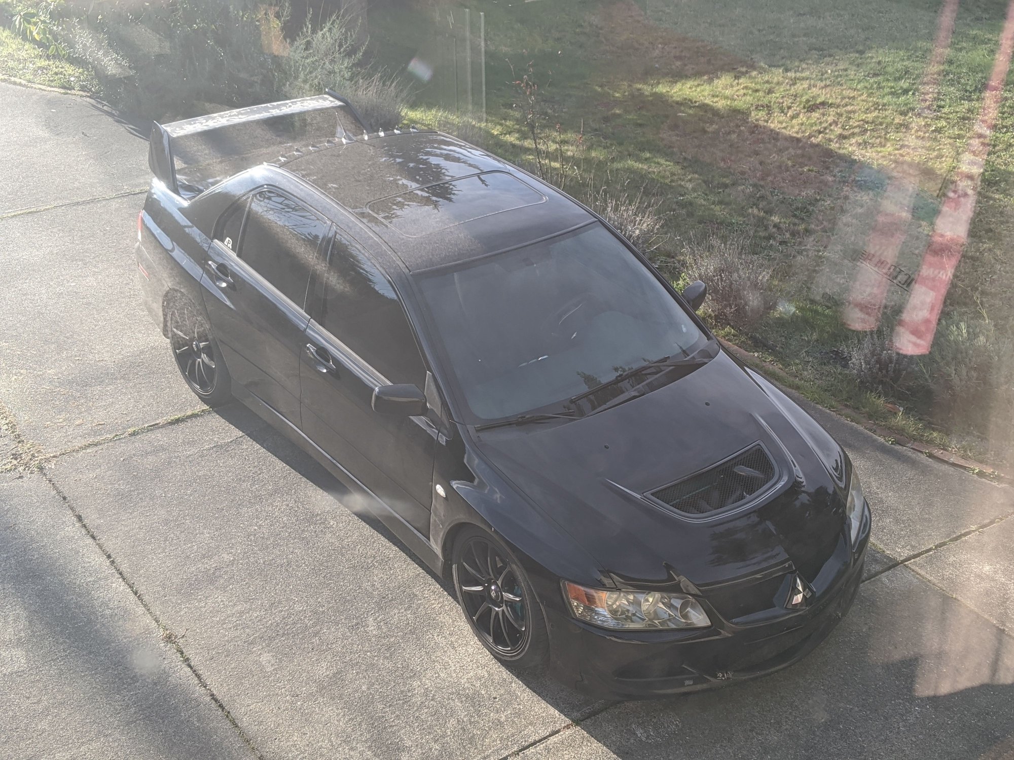

Update for y'all! So the shop that was looking over everything kept the car for a while and did a full checkup on everything I did. They found a few other minor things that I overlooked or didn't have sealed all the way. All minor stuff, but definitely makes a difference. Plus now I have some peace of mind that a local shop that knows Evos really well has given her a clean bill of health. With that all said, this past Friday, I got to take her home and do the break-in tune. I'll need to get some videos of how she drives once she's broken in and I can do the boost tune, but I did manage to get a little clip of her idling after she warmed up and did a few pulls.
Needless to say, I had a blast doing the break-in tune, and am excited to see how she feels once we're able to turn up the boost. As of right now, she's holding steady at 16psi, and is a lot of fun. The whole time during the break-in tune, I was giggling like a kid in a candy store, and I'm sure the tuner thought I was crazy. But alas! She is home, and it feels so good! Now she just needs a good bath, and for me to button up a few other little things.
