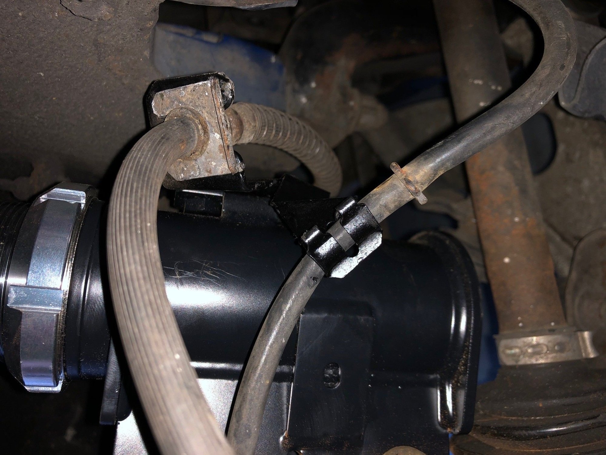

Got some more work done on the car this weekend. All that’s left is mounting/plumbing the regulator and putting in the new fuel pump.
I was able to fenangle a few things around and get the upper intercooler pipe to fit without modification, so that’s good.
I decided to go with the new Walbro 525 fuel pump, we keep a crap ton of them in stock at work so I’m just going to grab one and replace the F90000267 pump with it and see how it goes!

But, I got the FueLab regulator mounted and plumbed, wired in the Mac 4 port, bled the cooling system and tidied up some other odds and ends so it's ready for testing now!
