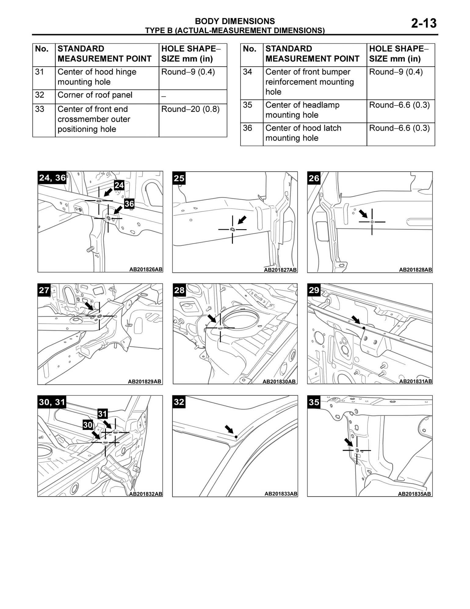

If you haven't already done this, I would highly recommend you go measure out the front end. Those results are really going to have an effect on the scope of this project.
Old Oct 22, 2019 | 08:34 AM
kyoo's Avatar
iTrader: (29)
Joined: May 2006
Posts: 10,834
Likes: 283
From: US
why's that? i dont plan to be doing the straightening myself, but the body shop seemed to think it wouldn't be a big deal - they have one of those laser aligners.
