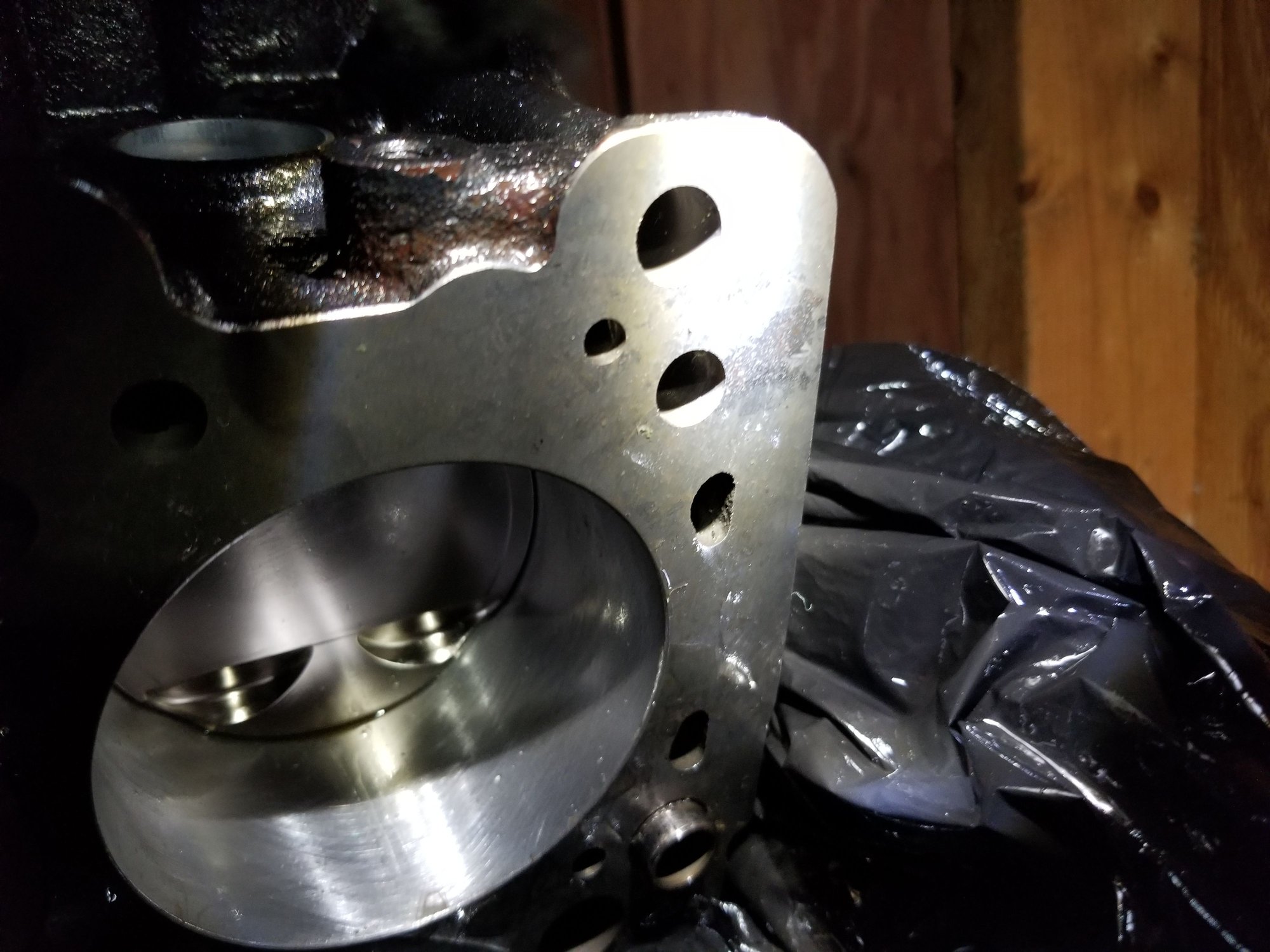

TEC locally here did the machine work. Block has been sitting for over a year, starting to run into a little rust on block from sitting if anyone has a trick to keep it from spreading please do share. If i must I'll send back to machine shop and probably would go with Machines gone wild (MGW)

Rusting on block spreading to deck, need to contain it.
