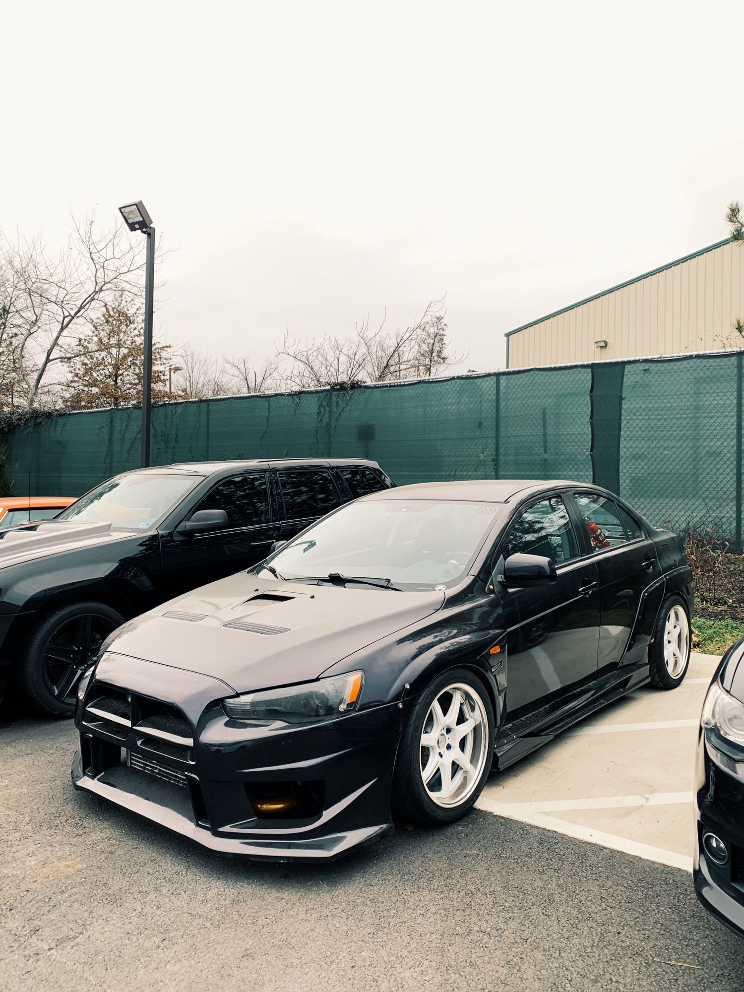

Well still waiting for things to get finished with the build on the car. Been ordering a few things here and there to do an overhaul and have things done at once. Hopefully the car will be wrapped up this month i've been itching to drive it. Anyways here are some pictures of the car from a shoot for a magazine that didn't make it to print.

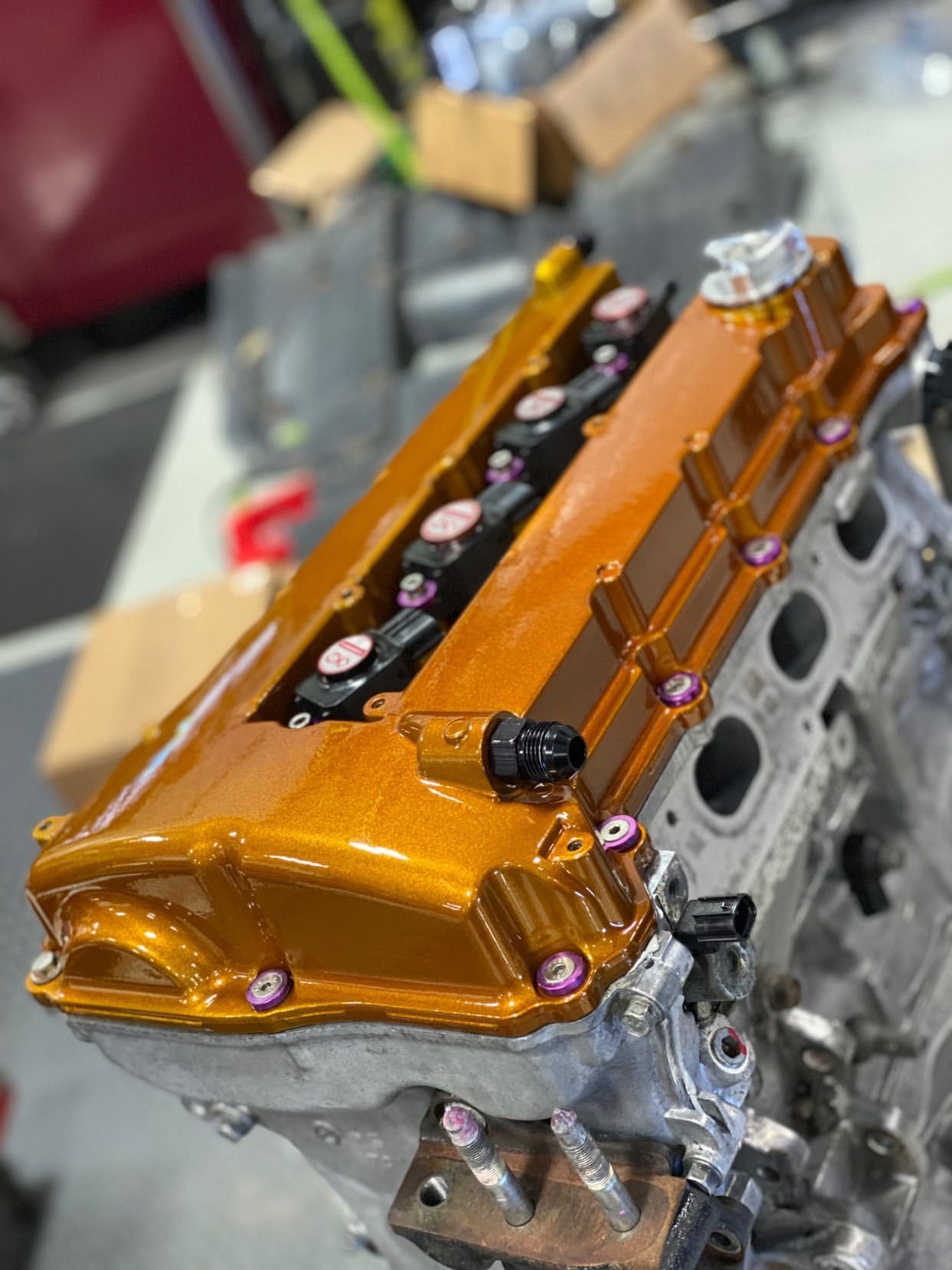

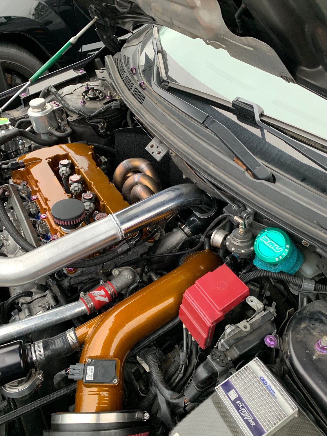

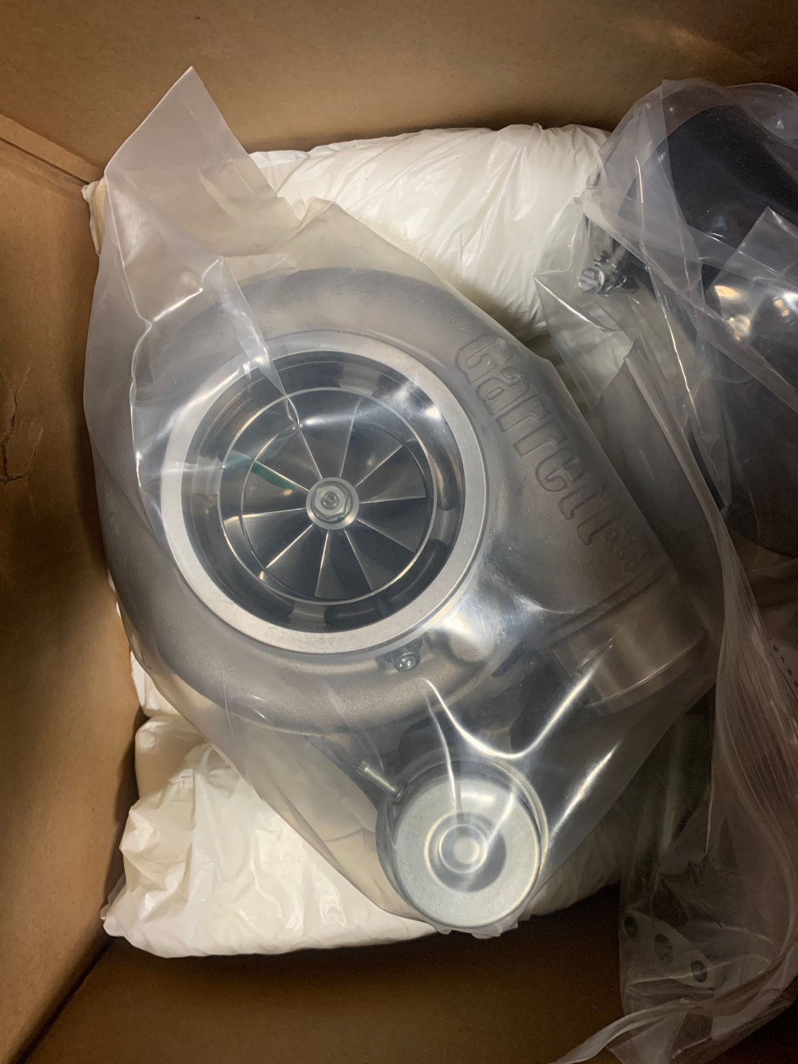

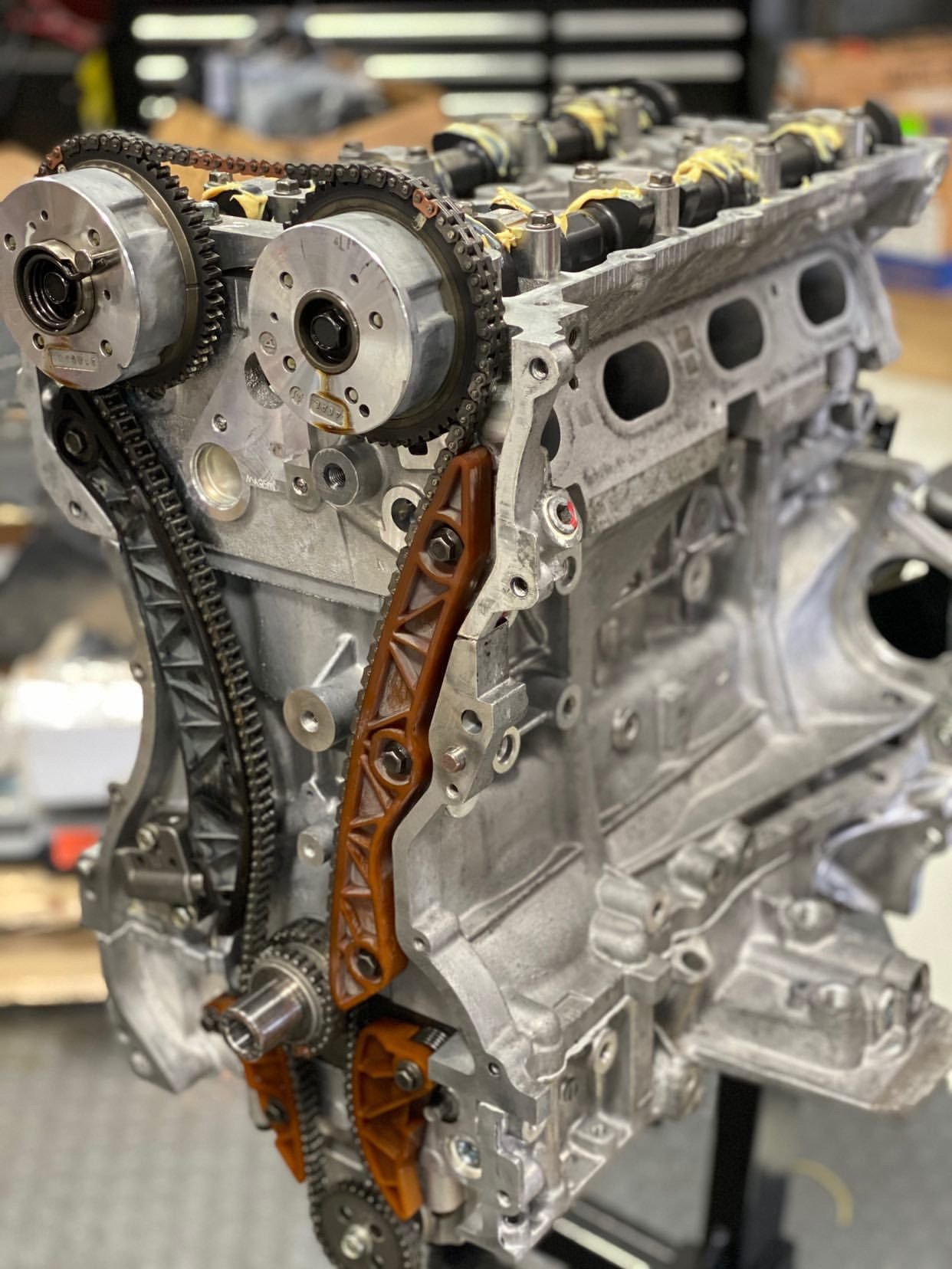

Things are underway for my build. Car should wrapped up soon!

Everything is installed in the car and it runs. Shop is doing some street driving to break the clutches in and then strap it down to the dyno.

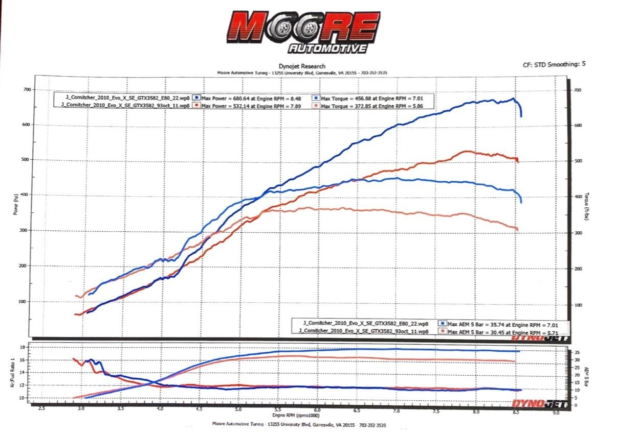

What were the dyno numbers on the new setup?
Old May 23, 2021 | 09:27 AM
Jacblack's Avatar
Joined: Nov 2013
Posts: 98
Likes: 18
From: Maryland
Here’s a dyno sheet
