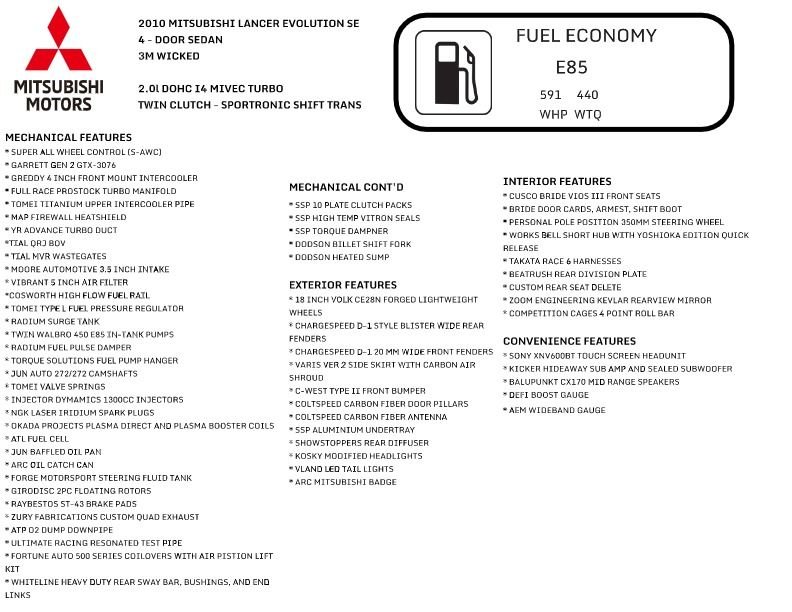

Stats about the car:

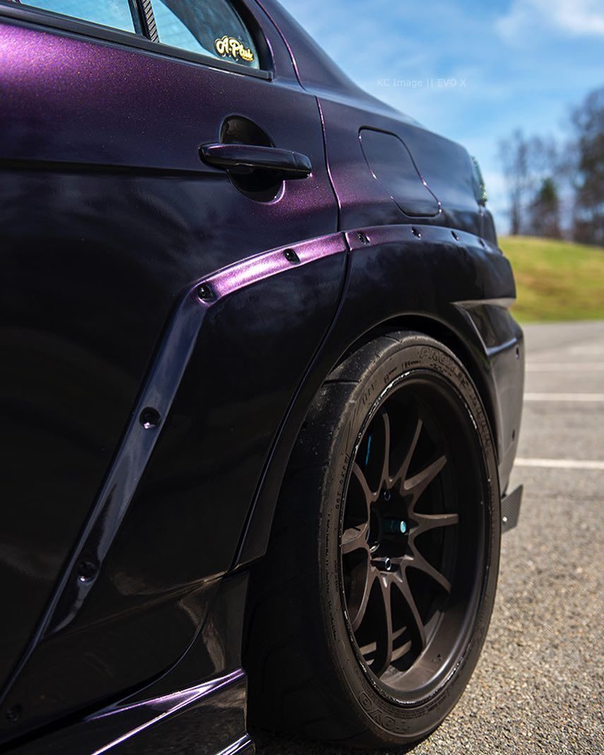

Posting a few shots with the CWEST front end. Sorry in advanced I do not have any cool high res photos yet. Going to be changing a few things over the next few months, which I will use this thread to document.

It's good to see an SST build, they seem pretty rare. Aside from the dodson sump, was there anything else you had to do cooling wise to keep the SST alive at that power level?
Old May 19, 2020 | 01:59 PM
LetsGetThisDone's Avatar
Joined: Oct 2013
Posts: 15,973
Likes: 1,629
Build sheet shows an SSP 10 plate clutch. The stock clutches wouldn't hold shifts at his power level.
