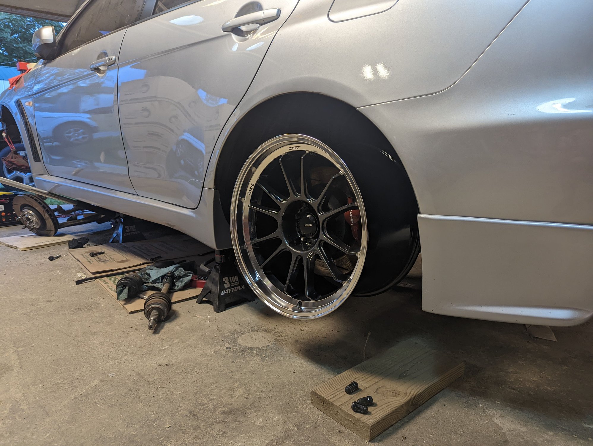

I have entirely too many projects going on, I get a couple of hours here and there to work on the car. I finally got the transmission and tcase pulled early August and shipped the tcase to Shep Trans for a new casing/rebuild.

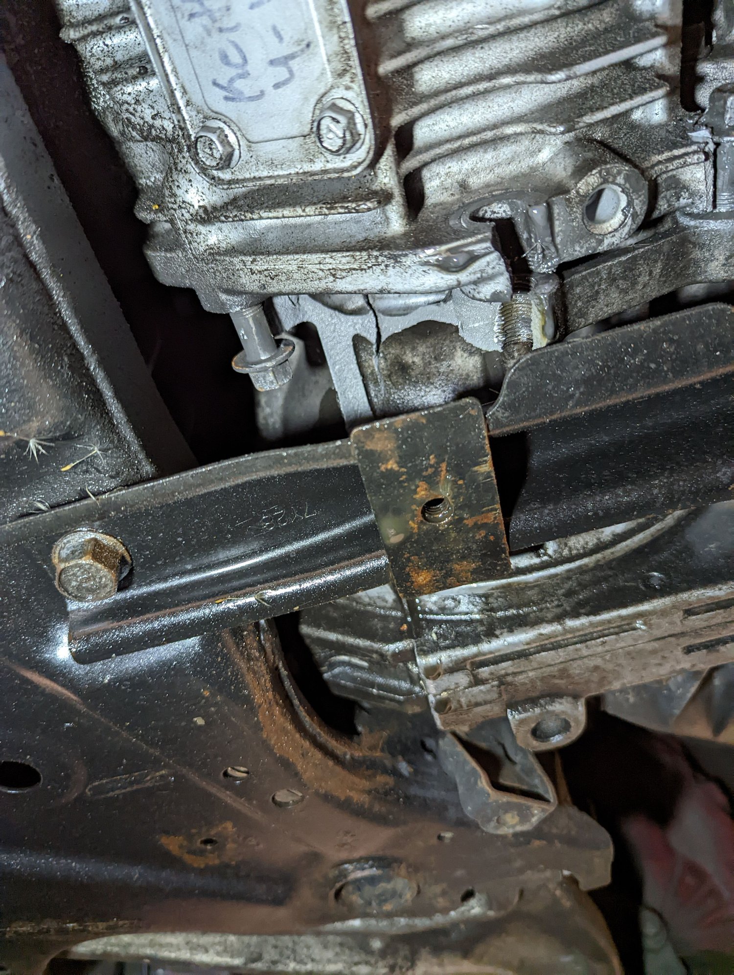

Don't judge too hard on the wood/support bar set up.

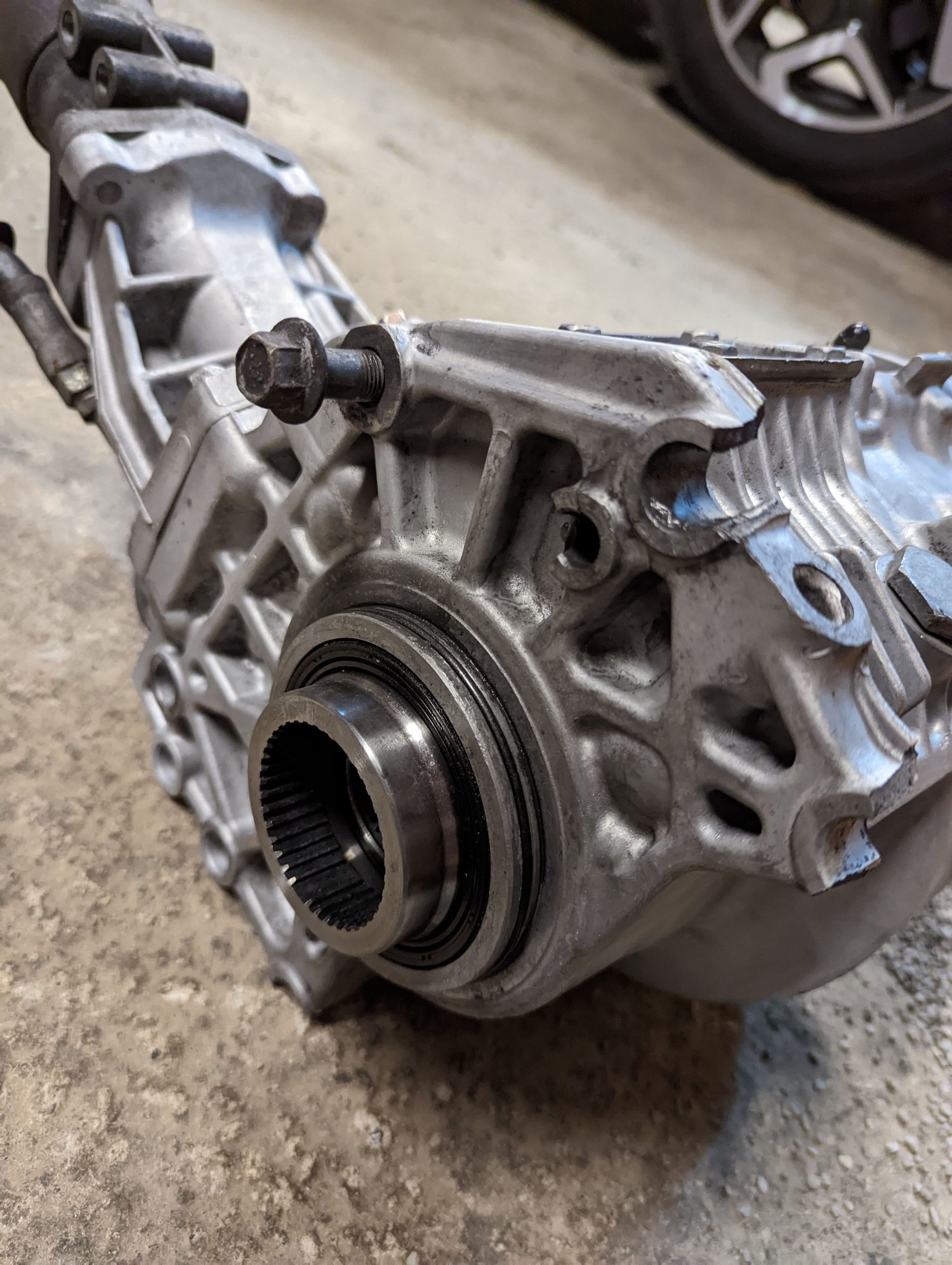

Took long than expected, had a friend coach me on the best way to get it out. I had to lower the engine slightly to give it a lean and it slid out without too much trouble.

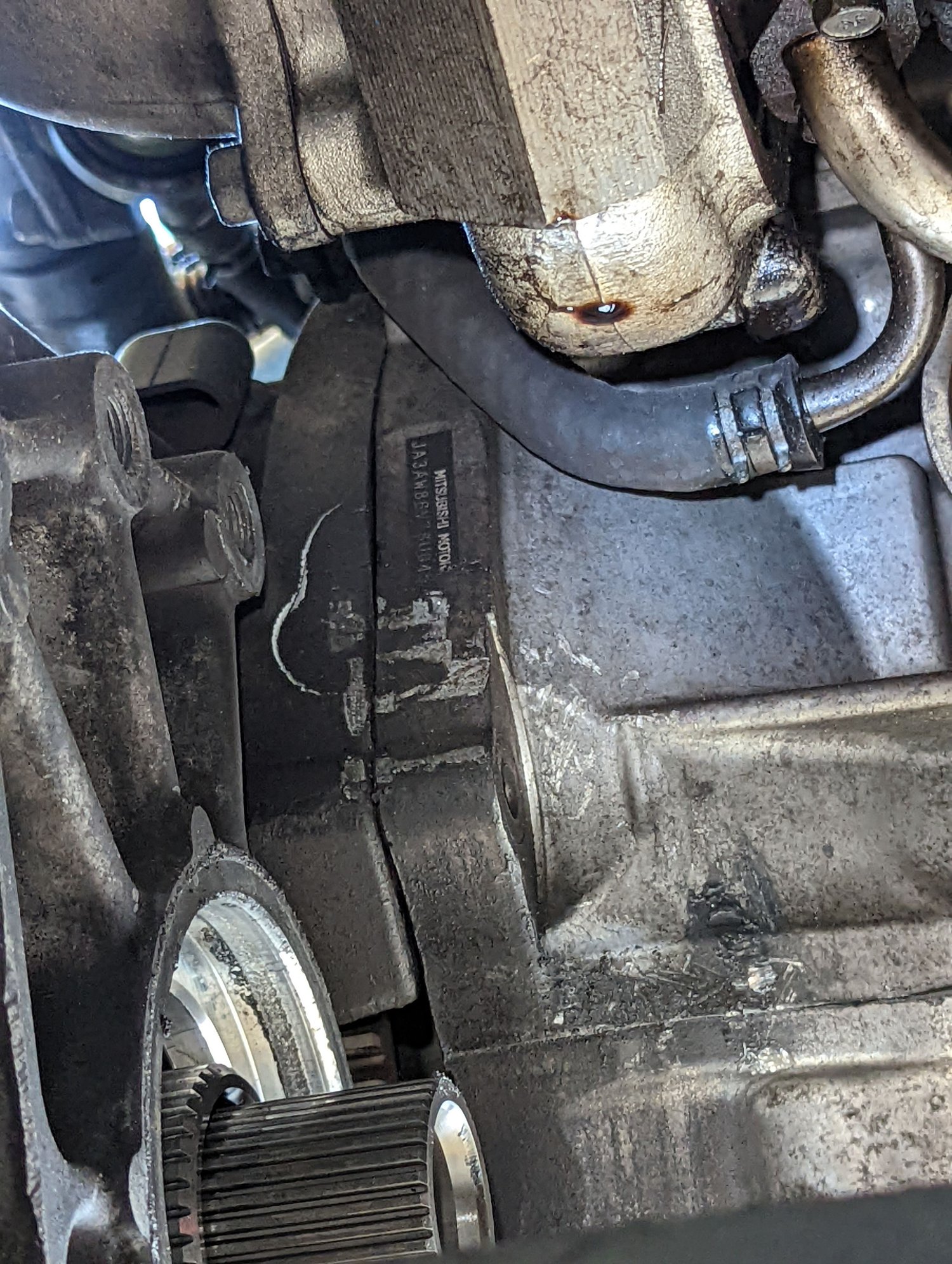

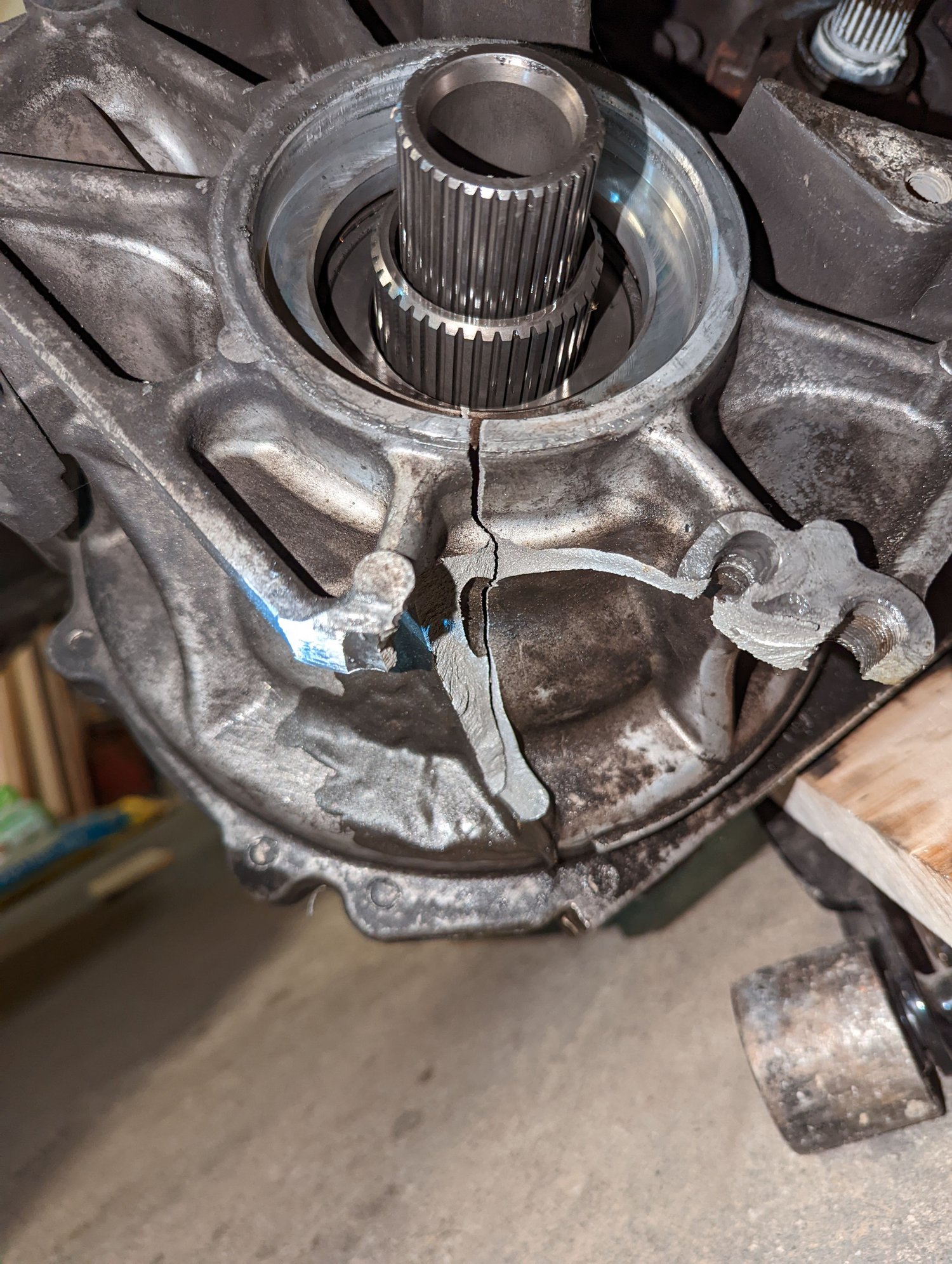

Here is the damage, I suspect the bolts were not properly tightened after the clutch replacement or missing bolts. I found the bolts on top of the tcase were missing. The tcase appears to flex and punching the transmission case, luckily it does not look like the block has been damaged.

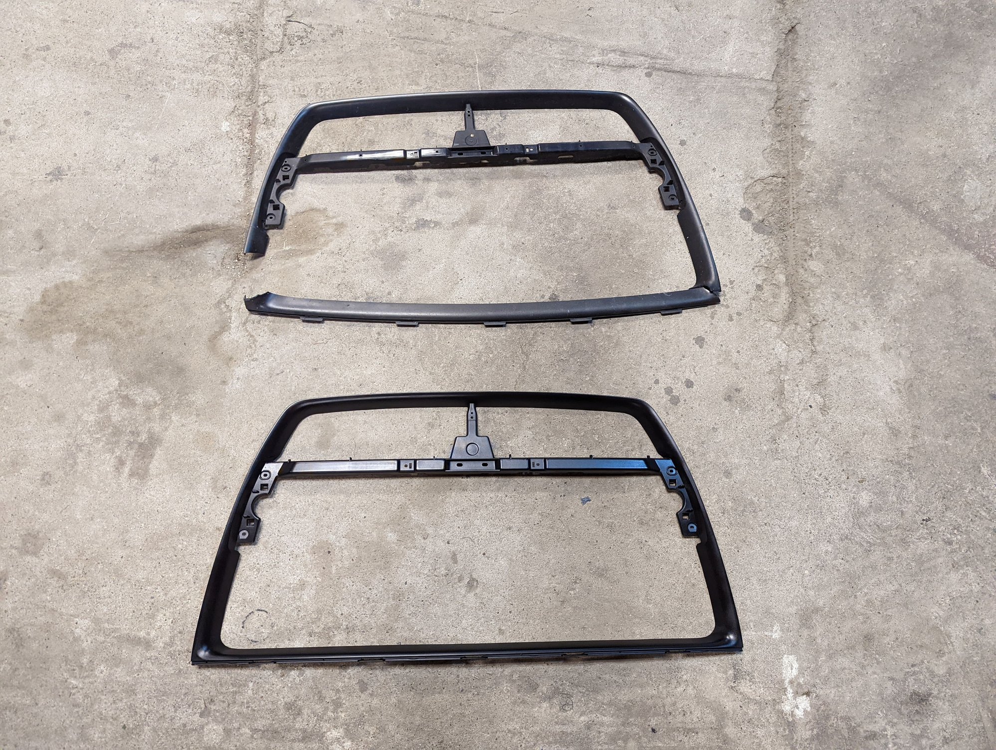

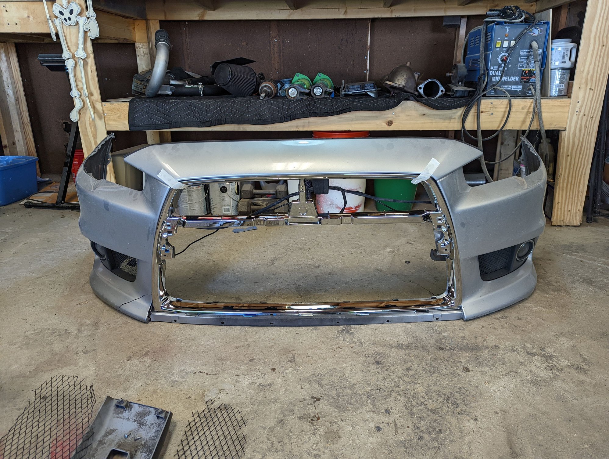

Tackling the damaged bumper, it needs a lot of love. I didn't want to spend ~$250 for the black trim piece, so I got the chrome instead. No problem with that! We'll paint it and make it look better, I'll be painting other parts of the bumper to match the black as well.
Fixed the lower deflector with some plastic JB Weld
I also picked up a plastic welder to fully fix the bumper crack

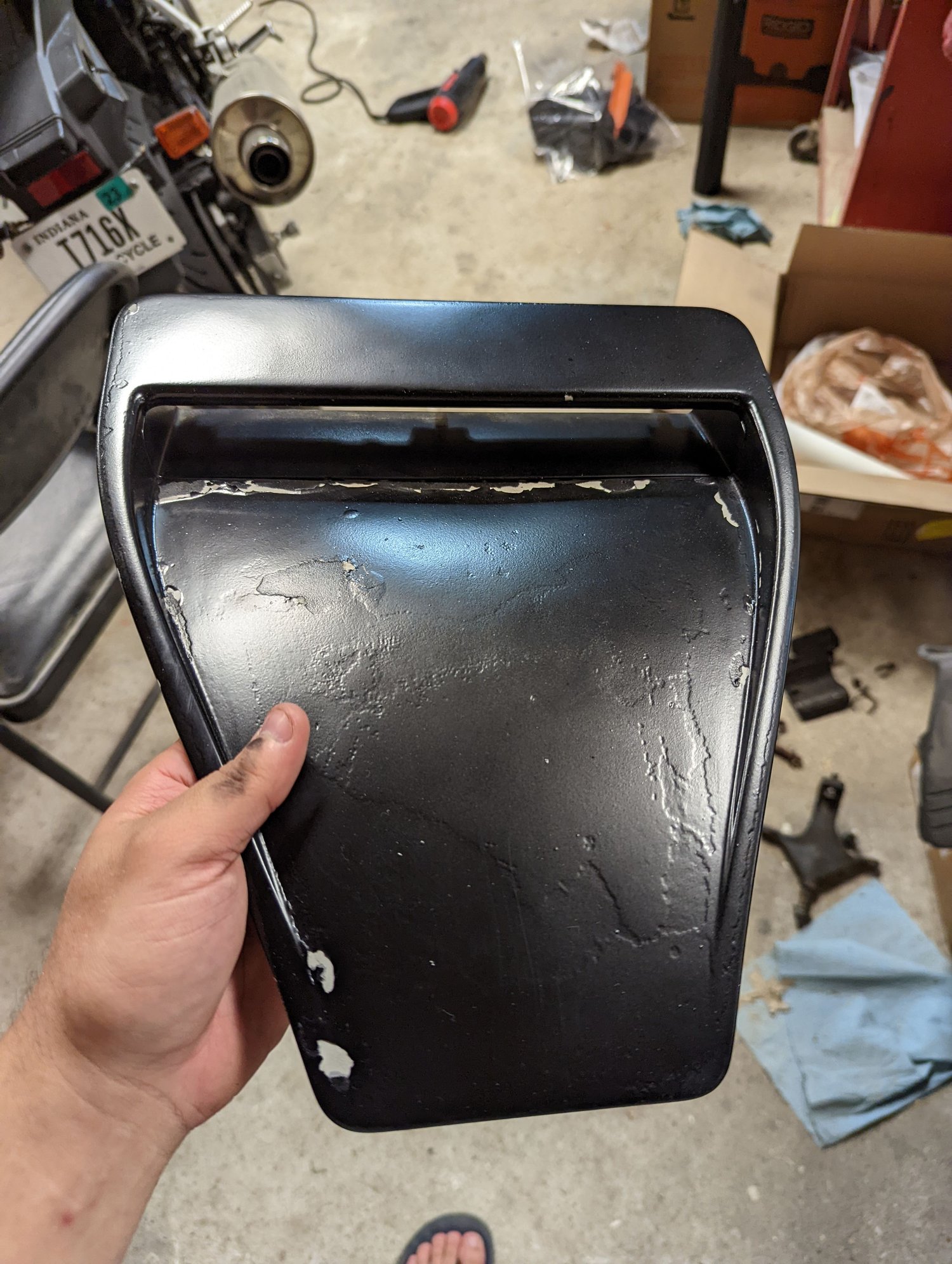

Previous owner attempted to repaint the hood scoop a few times but it kept failing on him. I'll need to sanded it down and prep, hopefully I can sort out a solution for the high heat. I thought it was aluminum and planned to powder coat, but it's plastic

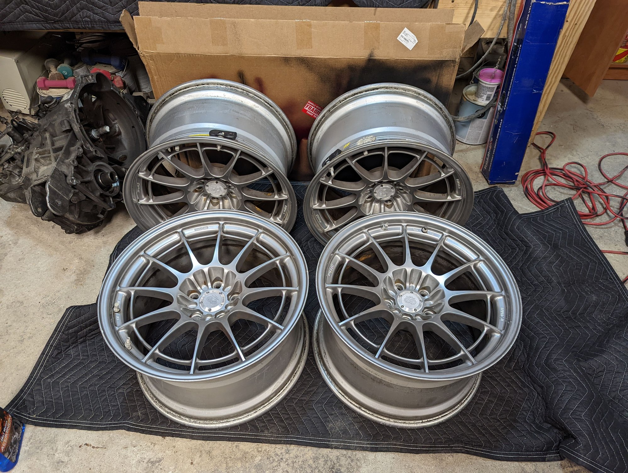

I picked up some cheap Konig Hypergrams 18x10.5 and a friend offloaded his old RE71s for me to use.
I liked the Konig's, but really wanted NT03s and the same friend had a set. He didn't really care what his wheels looked like so we traded!!

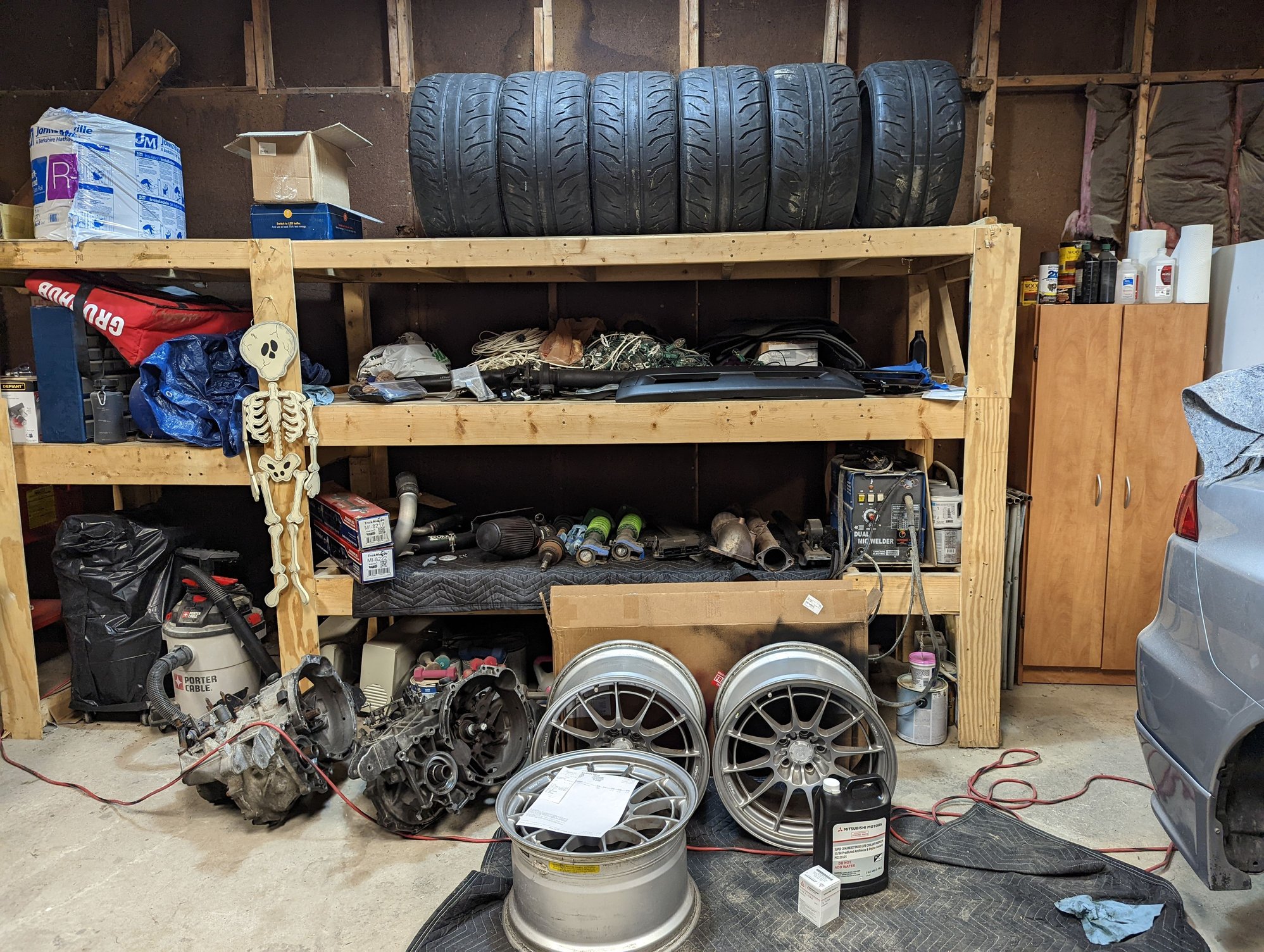

Just a few things on the shelf, I have all new fluids and other things coming to complete all the maintenance for the car. I hope to get the tcase back in the next week or 2.
