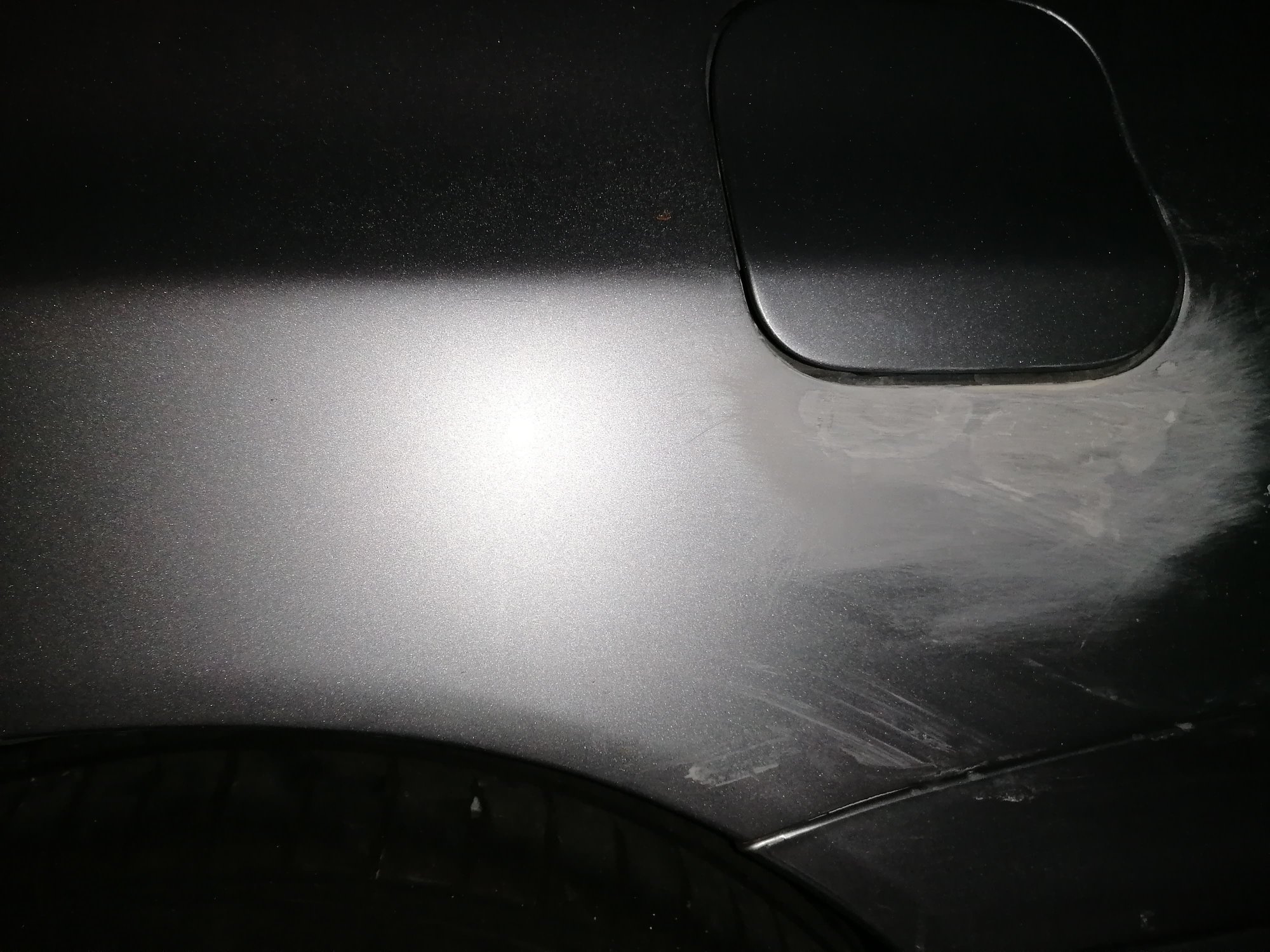

The paint on the left quarter panel near the gas cap came loose, which gave me all kinds of warnings signs. Behind that cap is a 1" hole.. i sadly don't have a picture of this right now. And since that is double skinned, it's just going to continue to rot.

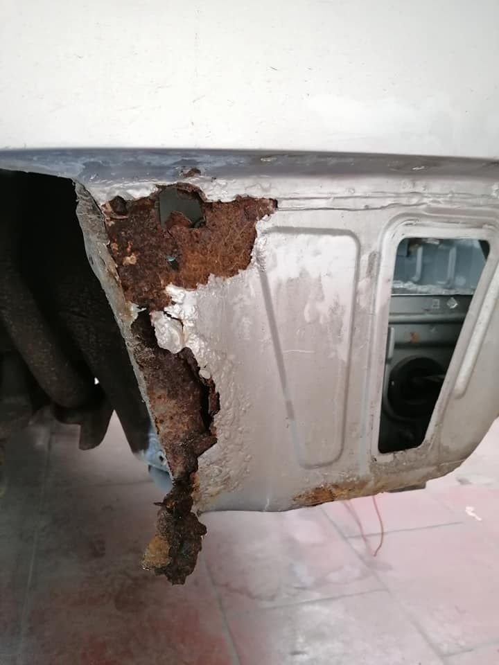

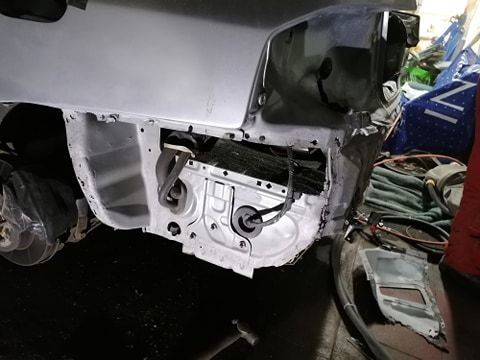

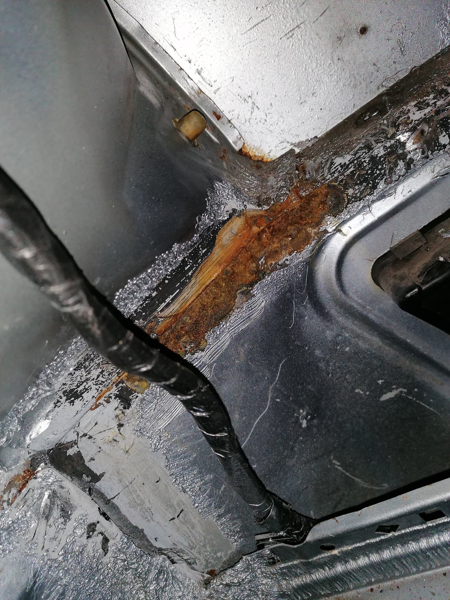

This is nothing, but then after removing what looked like perfectly stock seam sealer revealed a huge bubble of rust. After looking at it thoroughly and removing the back end, i noticed it was in a crash in the past and just badly repaired.
Even more damage revealed when taking the bumper off. Rotten everywhere.. i guess the years of UK roads before ending up in my garage to become a queen didn't do her well..
After taking this out we thought we had room to weld in a new panel i bought, but that ended up not having enough 'metal left' to weld to..

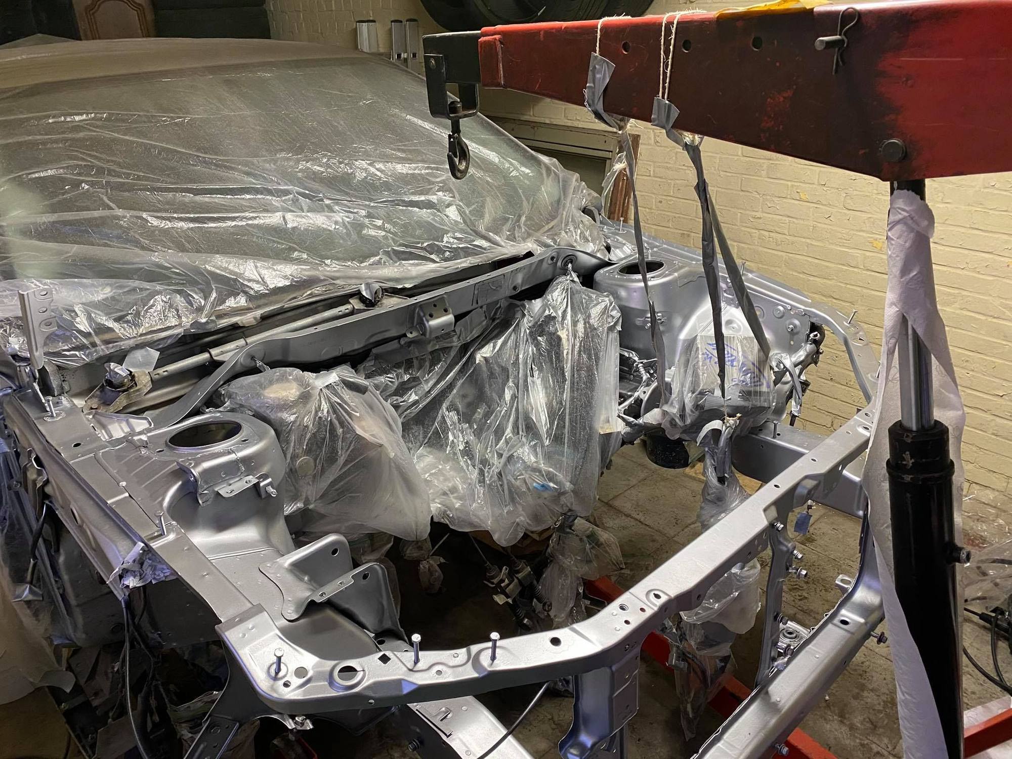

After seeing this, my paranoia became even worse.. time to strip it and see what's going on there.
Removing the bumper didn't help, just the sight of it made me panic in silence.
Okay, lot's of beginning rust, the engine bay pillars have it too.. couldn't become worse right?

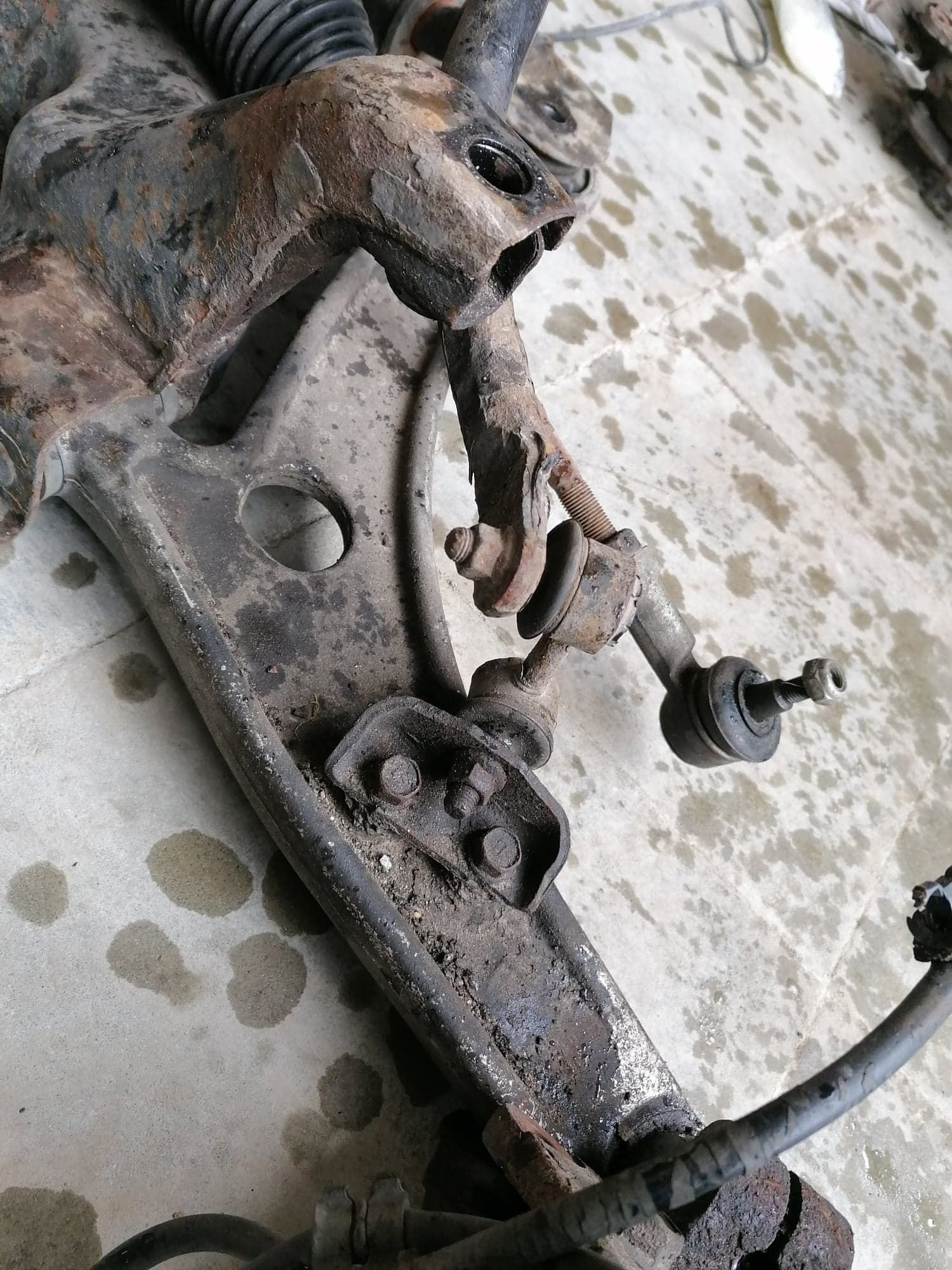

All the bolts are seized, about 10% of them survived, the rest broke off. Yay!

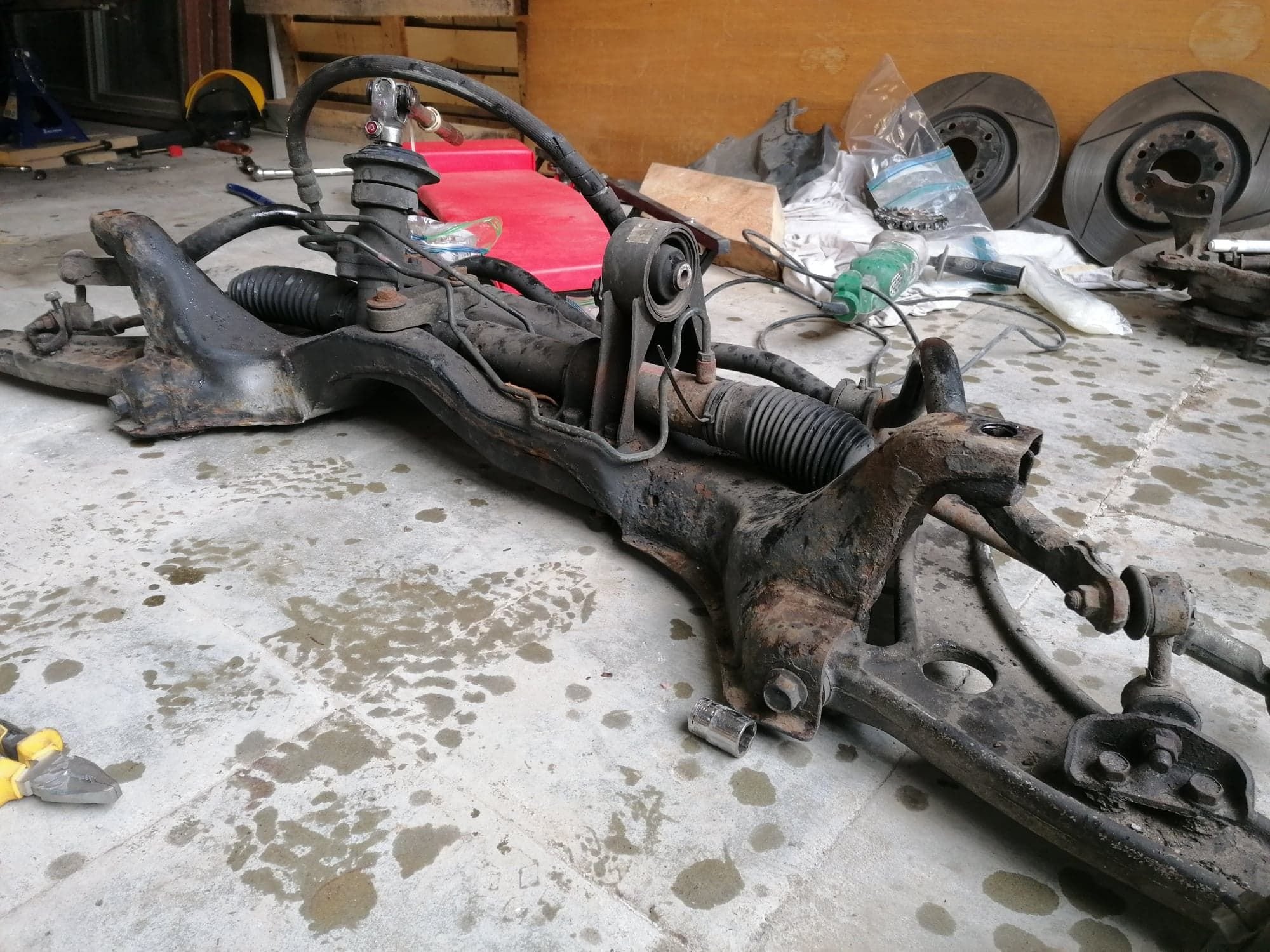

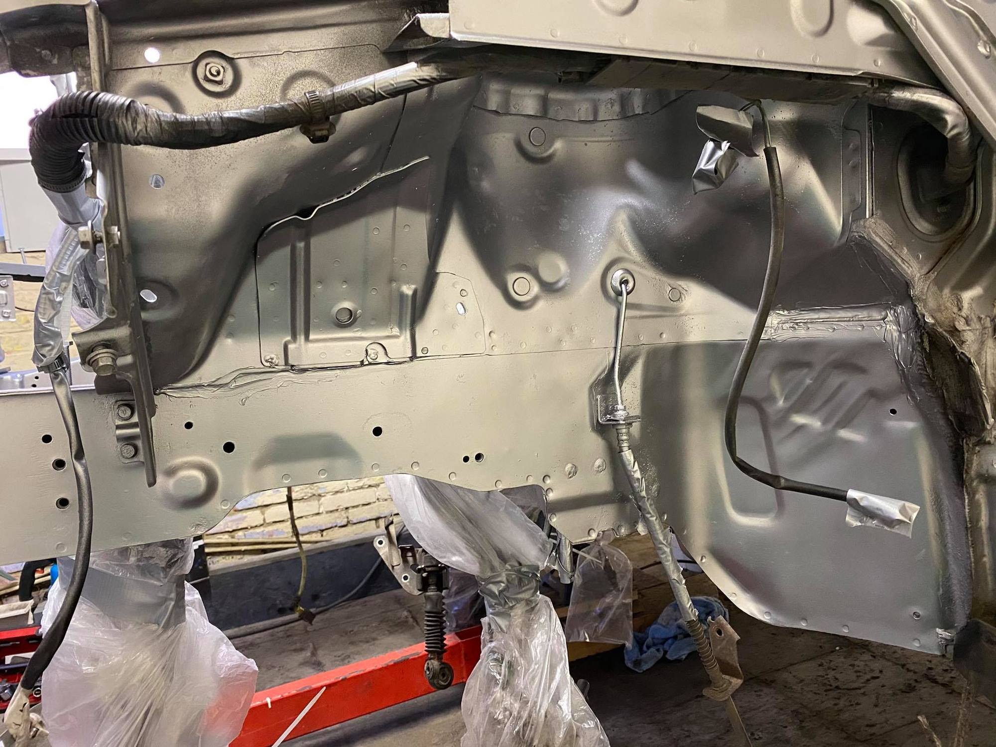

I removed most of the pictures, because they make me cry a little inside. So out came the sub frame.
What a b*tch... pictures say more then a thousand words..

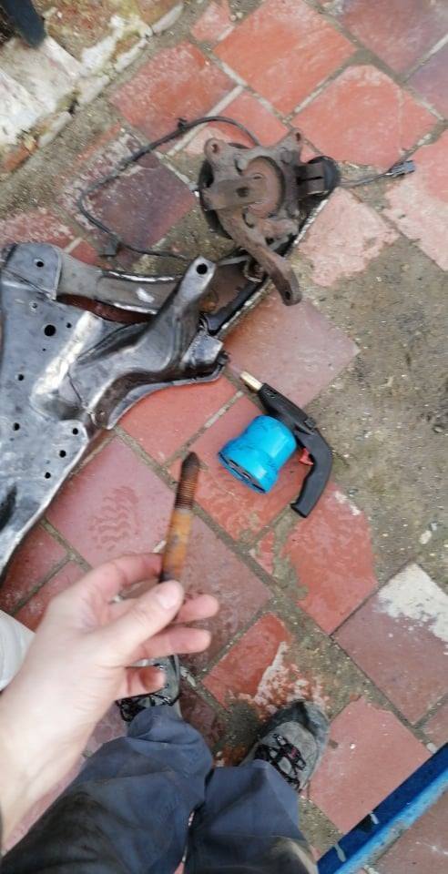

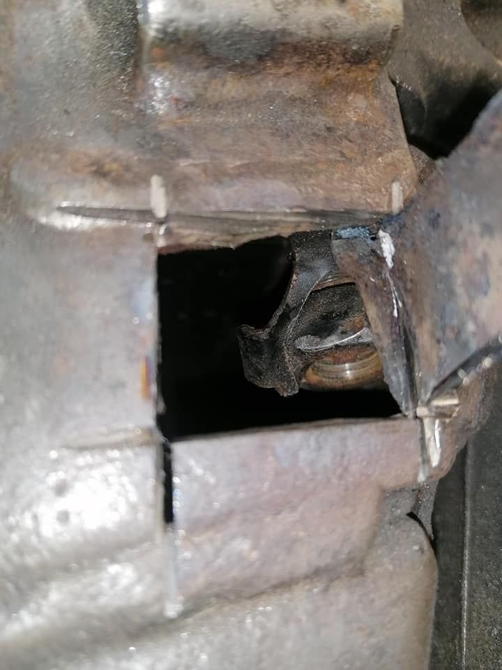

When removing the subframe, the famous bolt seized up. Why not? I mean all the rest is breaking, so why not this one?
Just cut it open, like the rest of them..

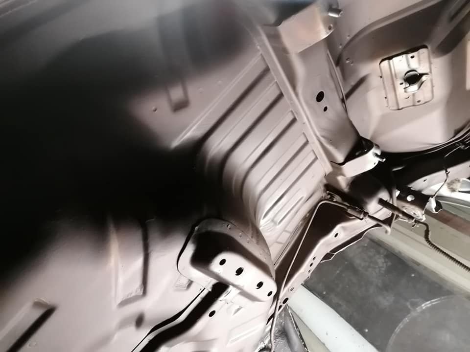

Then came the underside of the car. Where do i even start here? The car was a mess.
Laying underneath 10" of space and then removing all the components on my own , and then grind all this mess off. OH BOY..
Grinded most i could off to bare metal (some spots you just cant get too) and then i used like 4 litres of brunox epoxy (rust converter + primer) on the bottom side.
Then painted it and undercoated it. I hope this holds.

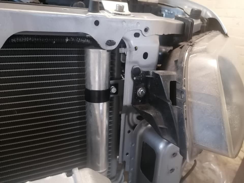

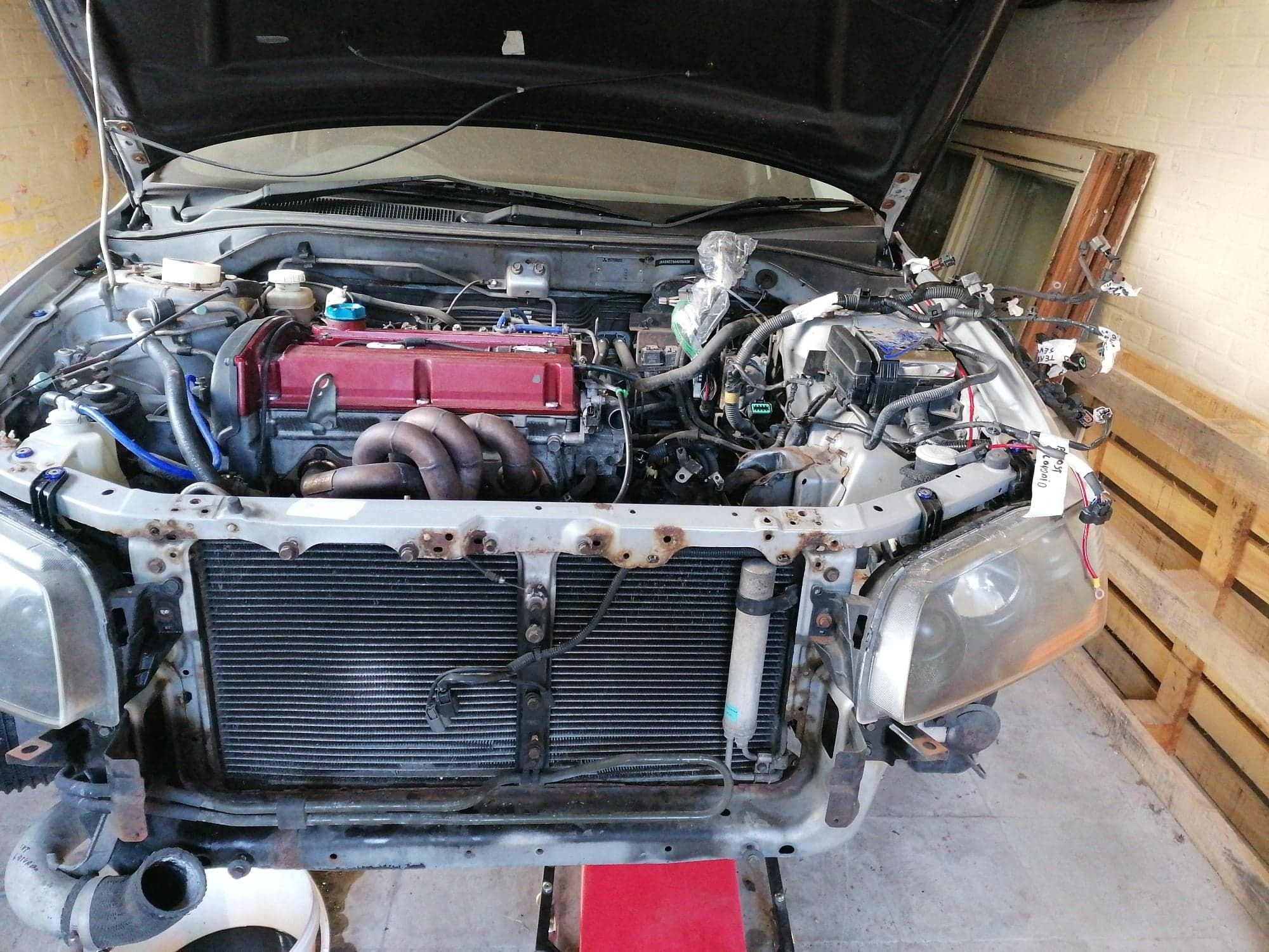

Then i cleaned up the front (fenders, engine bay, ... same way but sandblasting it also)

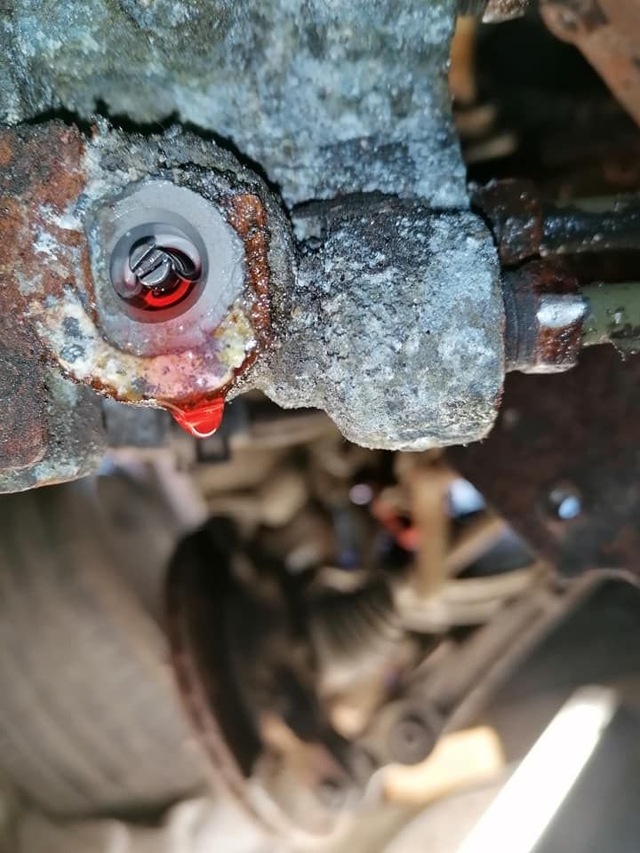

All seems good, then the AYC went out. Solenoid broke off! This can't be good? :P

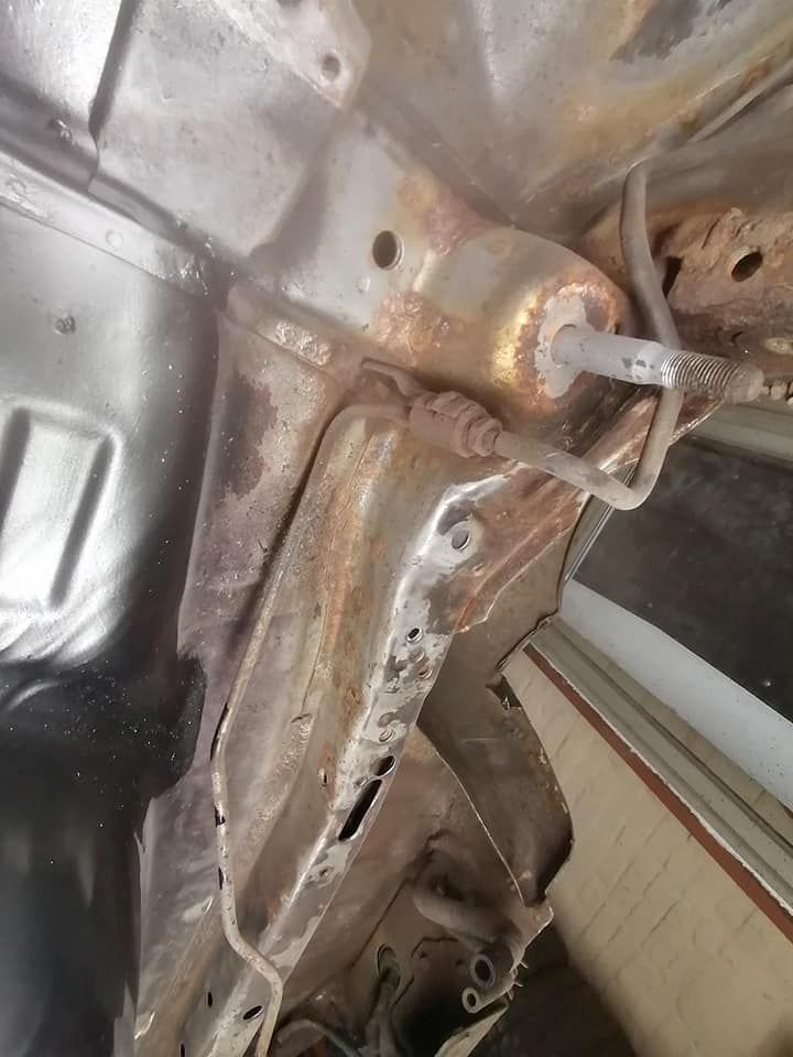

Then i found holes in the rear chassis legs. 2 of them.
Then another one in the rear arches of the wheel
A beautiful look from the inside
