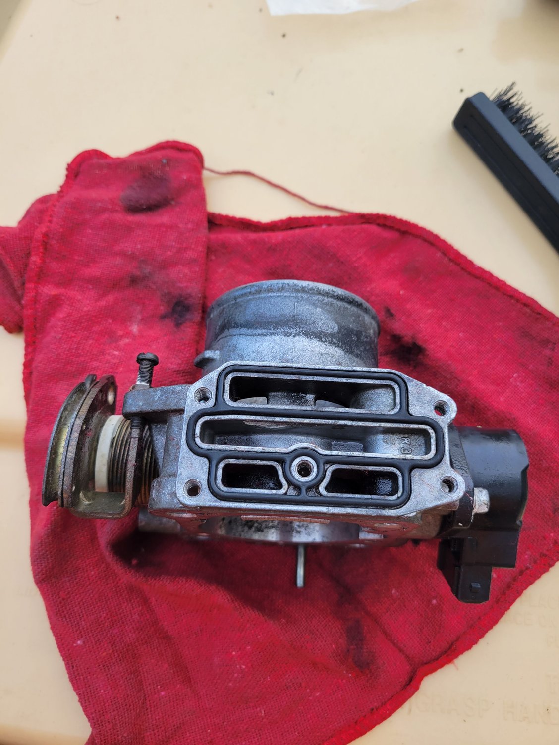

Knowing this, the first things i did was replace the IAC and installed an FIAV bypass plate, which fixed the erratic idle issue. Also cleaned up the throttle body. While the throttle body was off i looked behind the intake manifold and found that the knock sensor was unplugged. Plugged it back in and hope all is good.
Put a fresh set of NGK spark plugs in and changed the oil. Took the car for a drive, Idle is fixed and no more check engine light. Car drives pretty good and feels healthy.

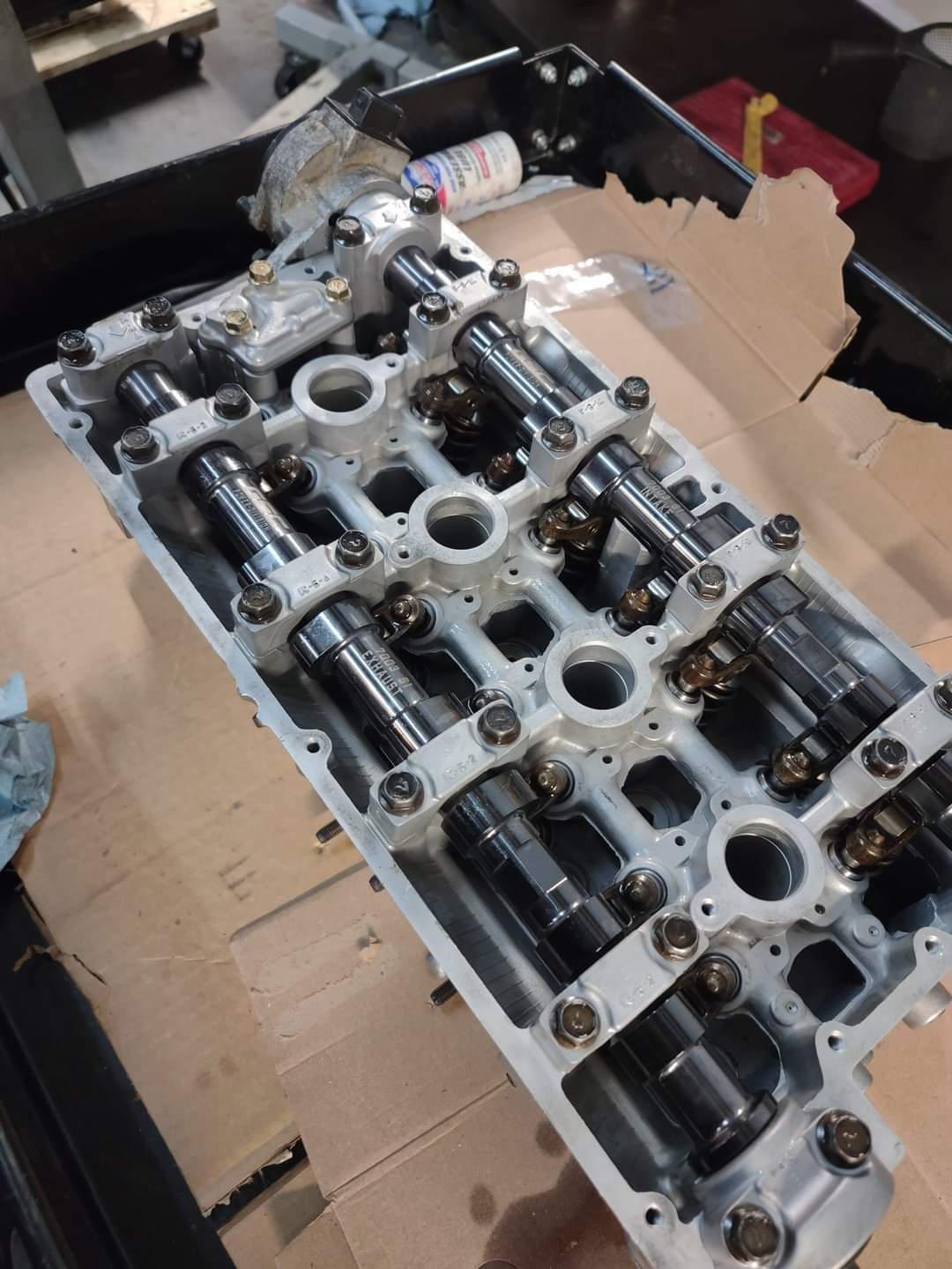

Decided i would go through the front of the engine and do a timing belt and components. Also decided that the roof rust isn't worth the repair so ordered a Carbon Fiber roof from the UK at this time.
Timing components turned into going the extra steps to replace the headgasket (with OEM) and get the cylinder head freshened up.
Parts ordered:
GSC Billet Stage 1 Cams
ARP Head Studs
MAP Beehive Springs and TI retainers
GSC Std Size Intake and Exhaust Valves
Revised Lifters
AEM Cam Gears with ARP Bolts
Kiggly HLA
1300cc injectors
Fuellab FPR
DW 320 LPH fuel pump with rewire kit
Bigger front mount intercooler.
TurboSmart Blow off valve and manual boost controller.
Head is getting cleaned, resurfaced and valves seated at a machine shop.
