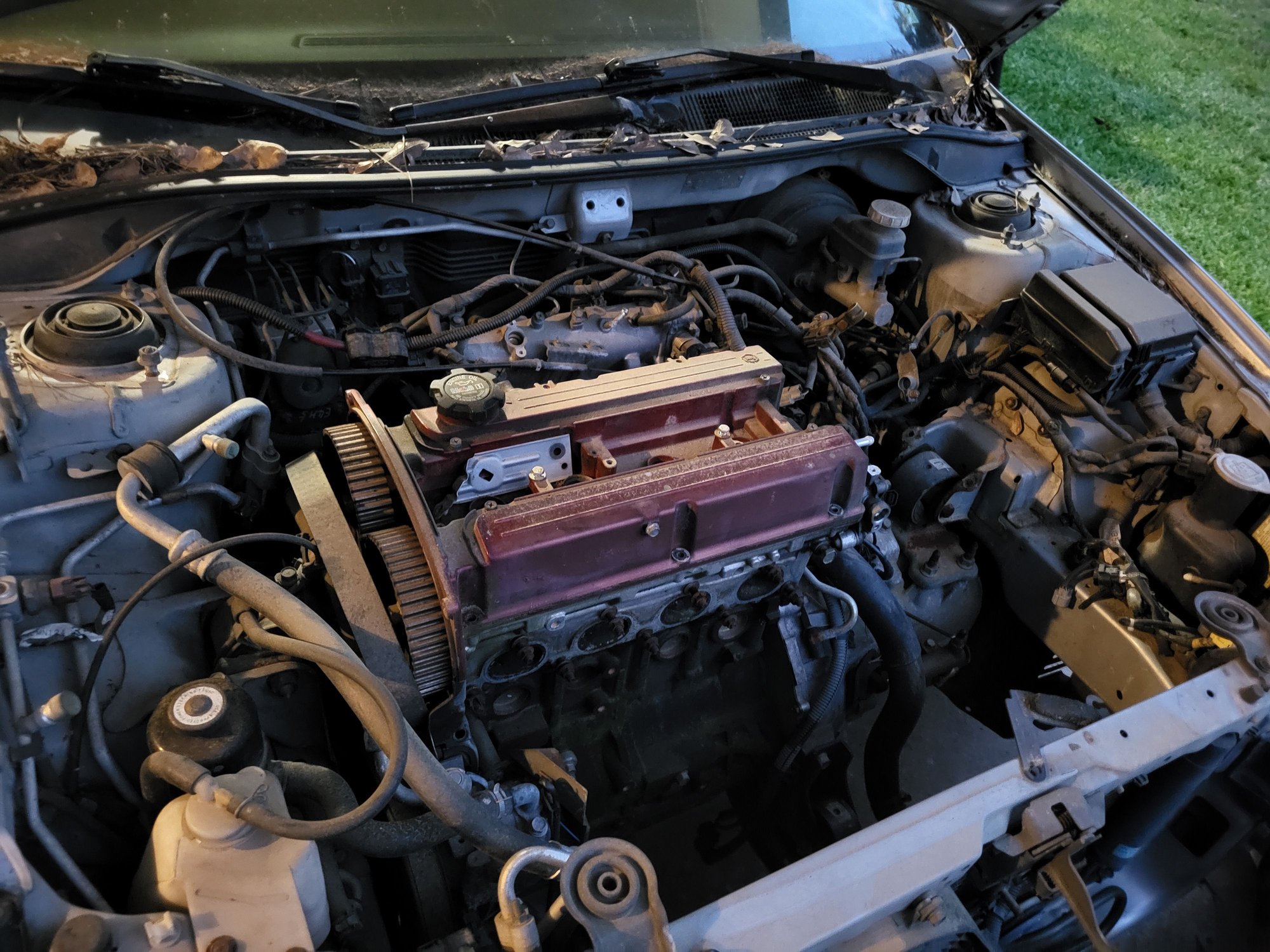

Get to the motor, pull the valve cover and the valve train is CLEAN.. like what in the...
I still have to pull the oil pan to check the rotating assembly, but from what I saw in the head, my hopes are high.

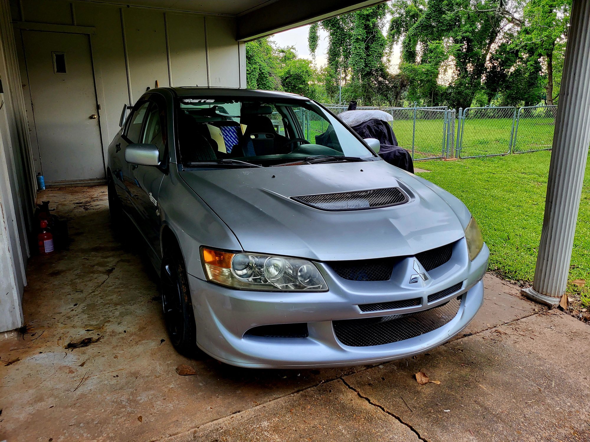

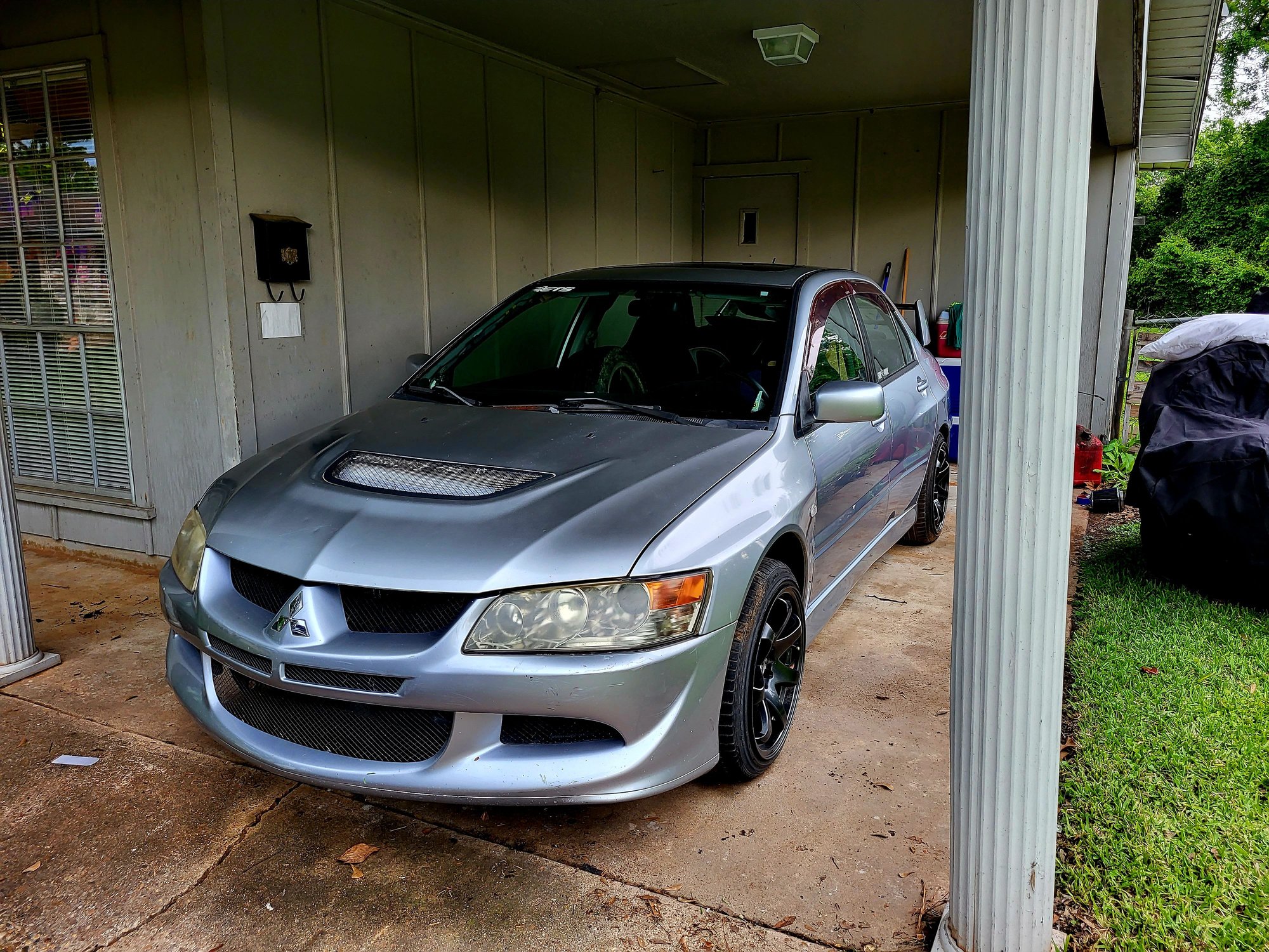

Here is some pictures after I gave it a good wash.

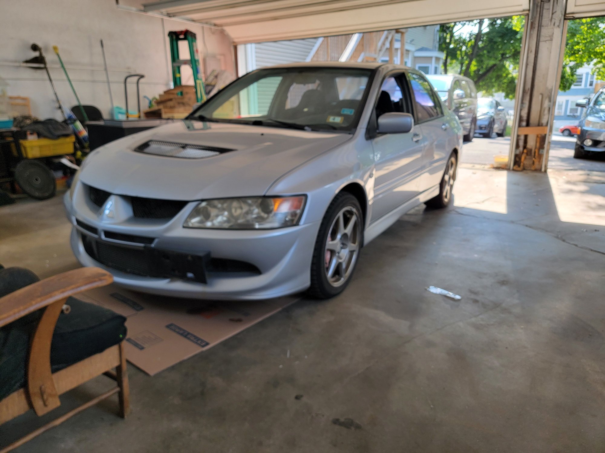

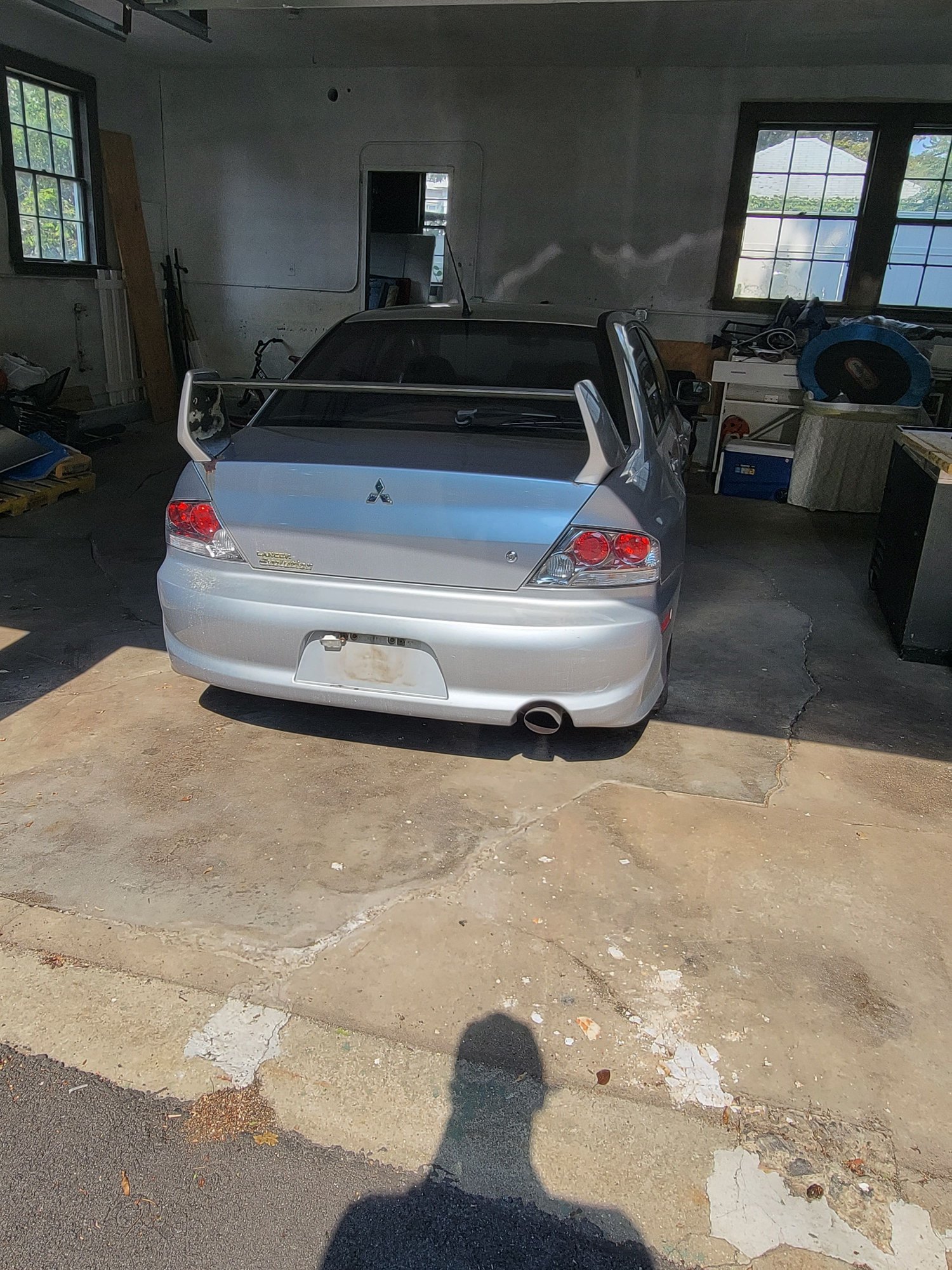

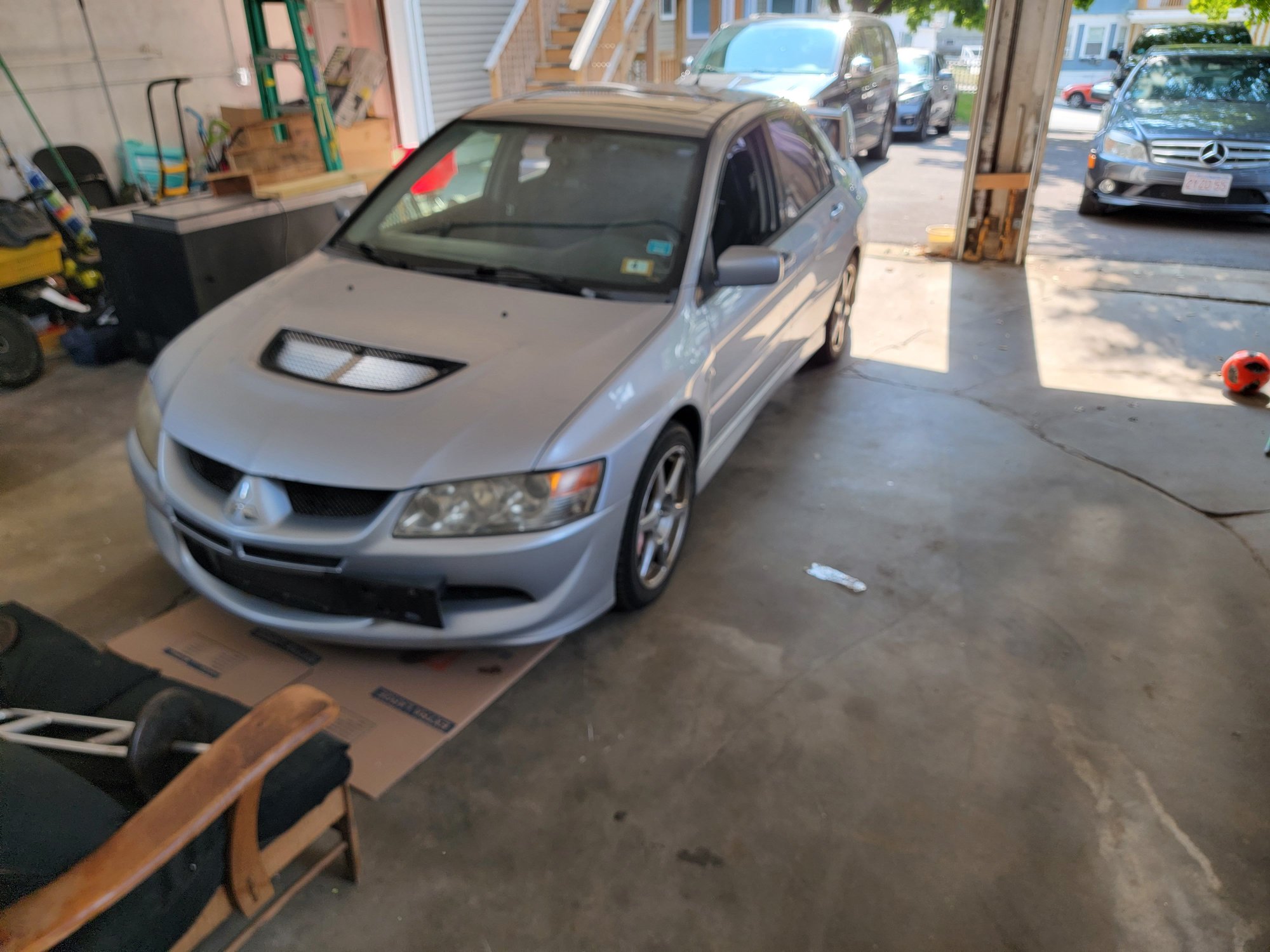

This looks just like my 03 Evo 8. I got mine for 6k 😁. Runs and drives but needs work. It was pretty much a barn find. Drove it home from NH to MA. So far ive I got rid of the misfire and the tranny oil leak. You mentioned the "usual rust spots" on your car. What are the usualy rust spots for evos? This is my 1st time with this platform. Im used to Hondas 🙂
