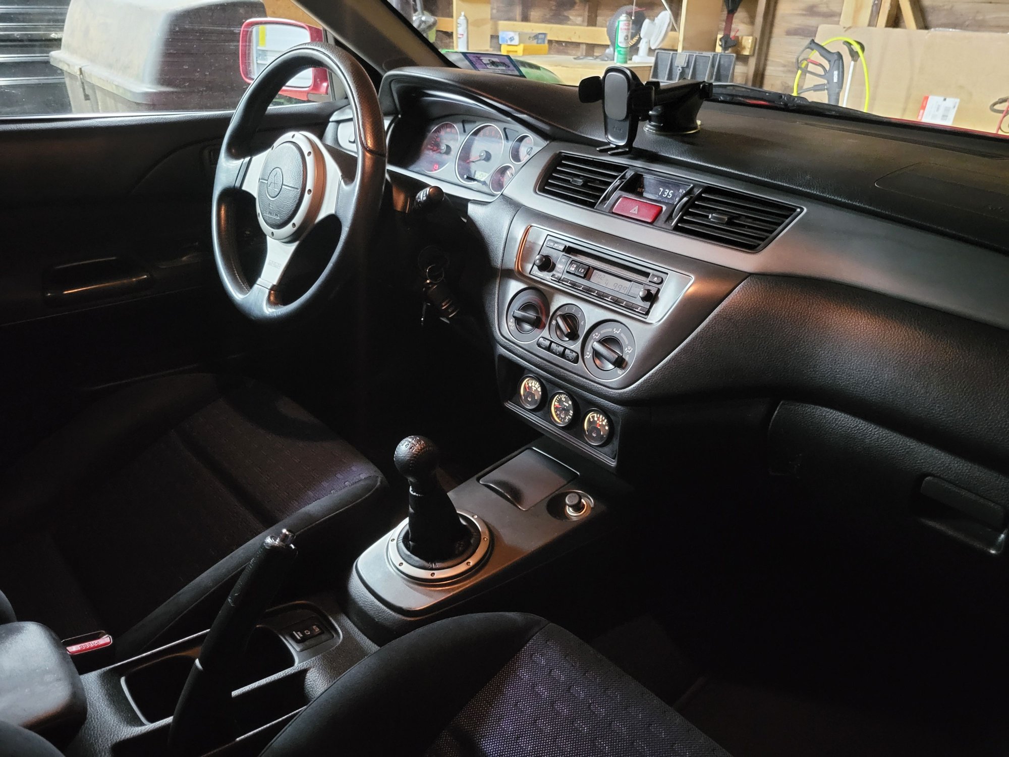

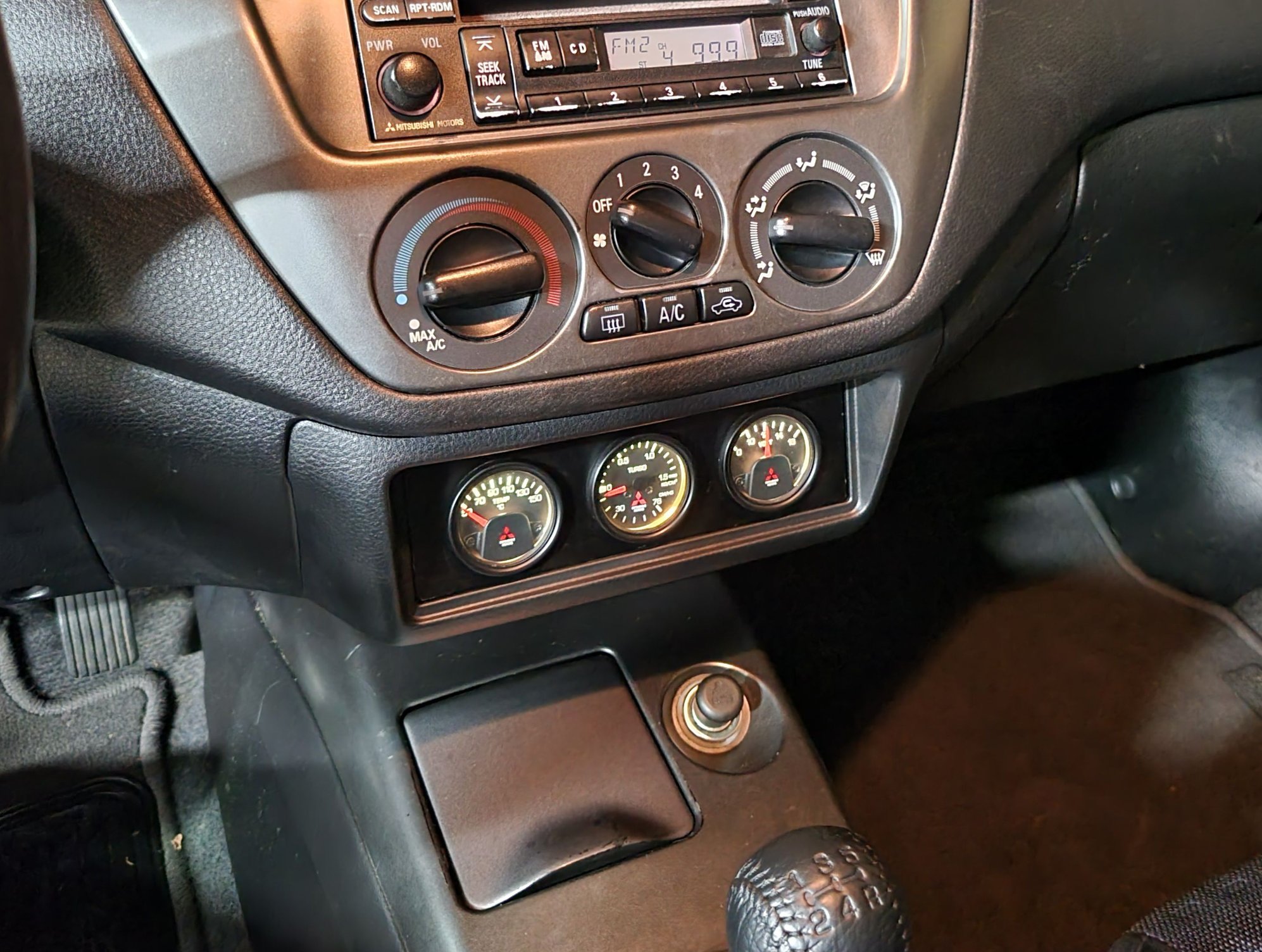

I was feeling the basic interior needed something more but also wanted to keep it OEM and in the time period. I got a good deal on the MR gauges. Im still waiting for the oil temp sensor so that hasnt been wired yet. I 3d printed the spacers needed to mount the gauges. I also replaced the hvac label stickers to freshen it up. I'm still on the hunt for good floor mats to complete the interior.
