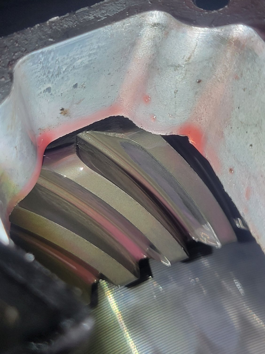

I acquired a supposedly lower milage good tcase. I didn't realize there was a gear inspection cover under the tcase. Honestly I don't see any noticeable wear on the gears. The two tcases look the same to me.

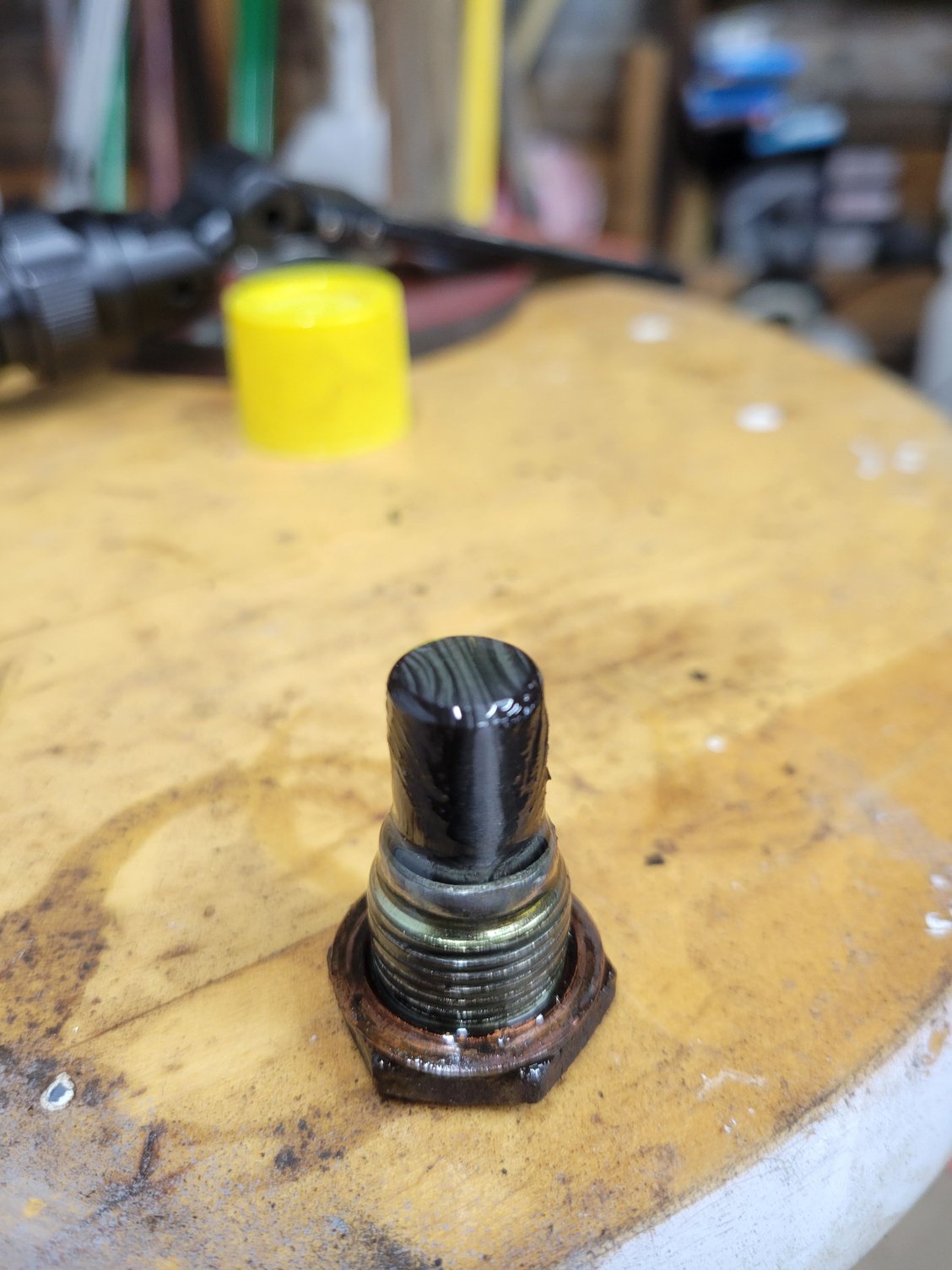

There was however a decent amount of glitter on the transmission drain bolt. The oil looked new, it had been replaced by the previous owner. I'm sure it's not shifting as smooth as a new transmission but I haven't had any issue with it.
Any advice on proceeding? Just continue with the tcase swap, or consider having the transmission rebuilt?

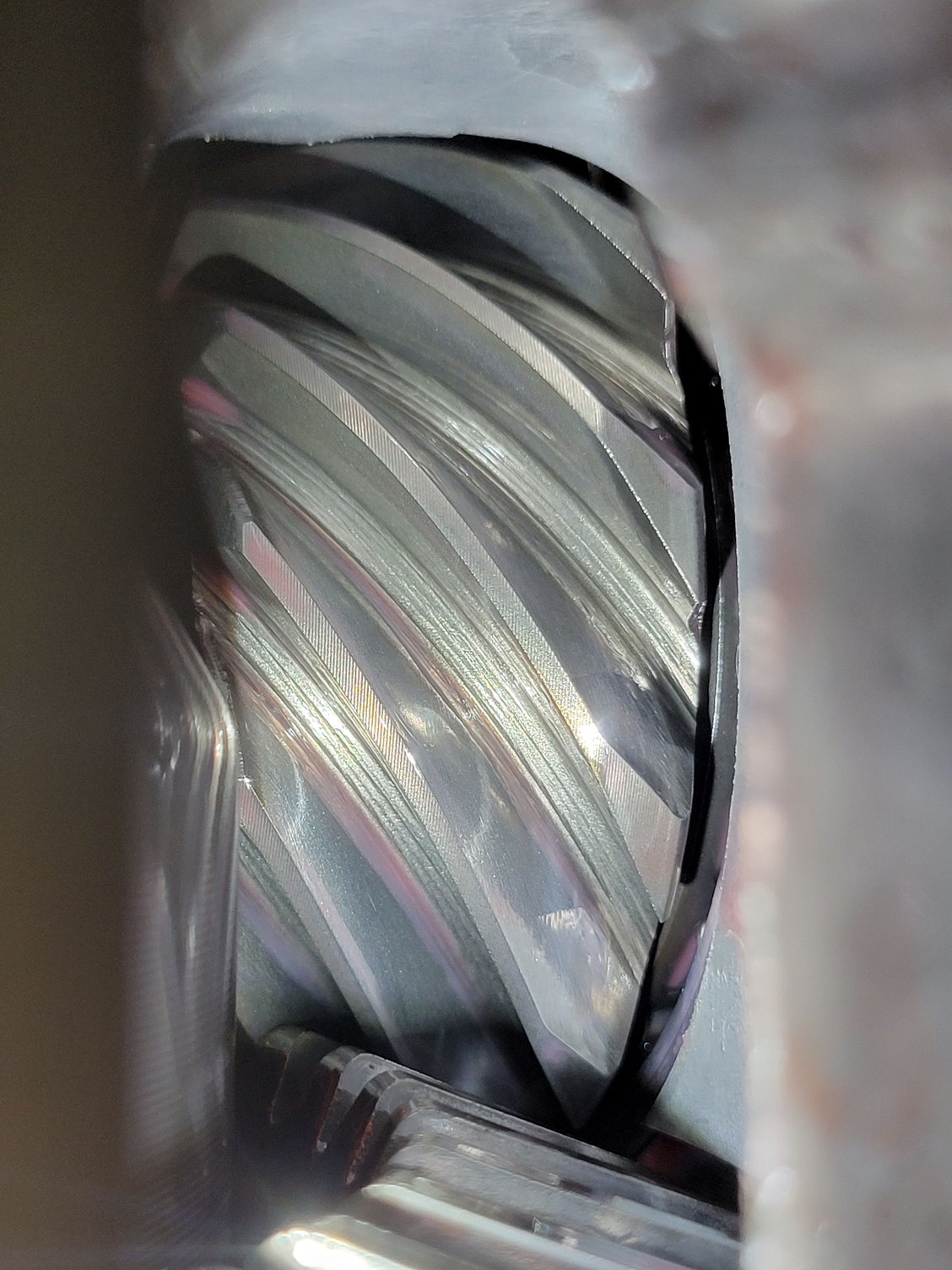

I'm not a gear expert but I'm not seeing anything that stands out to me on the tcase gears. I also drained the rear diff and there was just the glitter on the drain plug and the fluid was looking brand new.
So far I have not found any definitive smoking gun from any of the gear boxes. The carrier bearing looks alright to me, debating on replacing it and the bushings while im here. The axles and driveshaft are all tight and the wheel bearings dont have any play in them from what I can tell.
