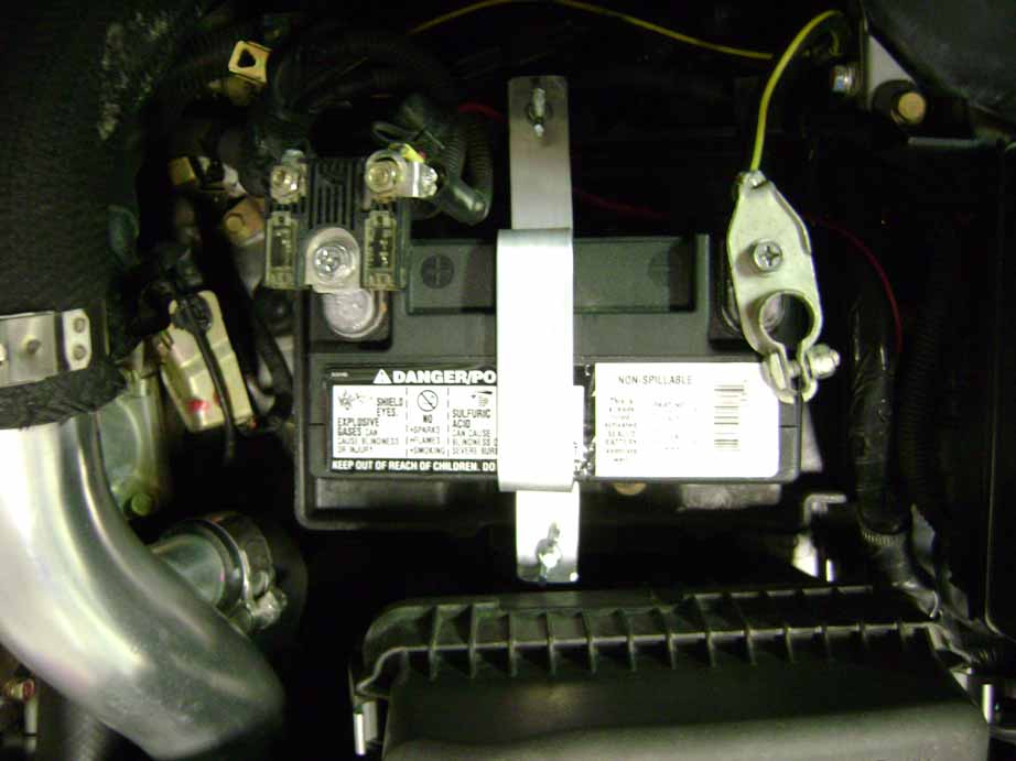

1. Go to Advance Autoparts and get the motorcycle/ATV battery with a part number ETX14 on the box ($80). You will have to browse the batteries yourself, because the ETX14 number is not in their computer system. This battery is the same re-badged mini battery many companies charge 2-3x.
2. Pick up some hardware and aluminum bar at Home depot/Lowes.
Figure out how you want the battery situated. This battery is sealed and can be layed down. I opted to keep the same configuration as the stock battery so it could be returned to stock with no holes/missing parts.
EDIT: I did have to drill a small hole in the NEG cable to the car because this battery has bolt connectors instead of posts.

thanks! i've been reading around and i'm planning on doing that....the dude on here selling the trays also mentioned you can buy the posts for those so maybe i wouldn't have to do any drilling.
