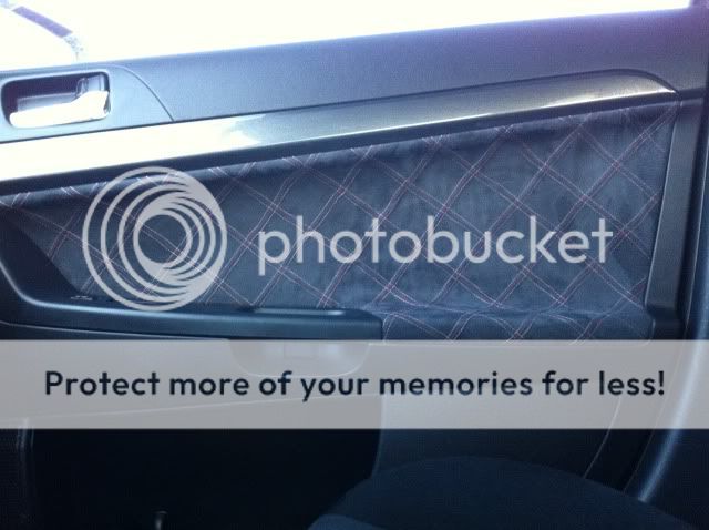

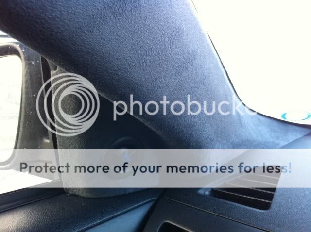

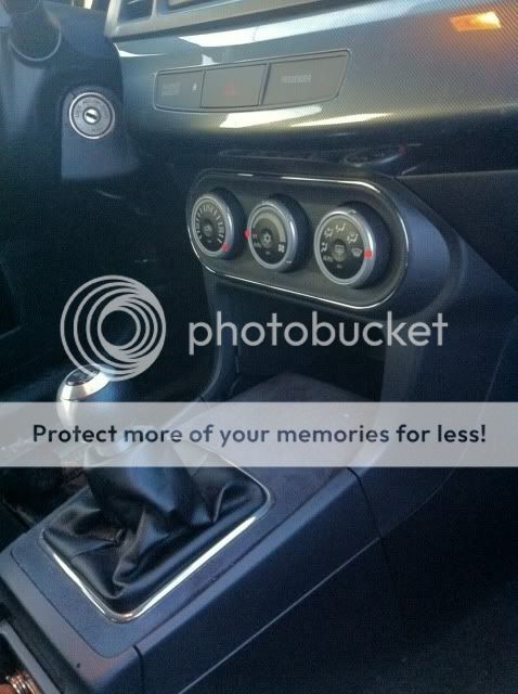

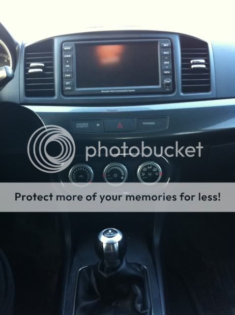

I've been working on my interior for a little while. jumped the gun to purchase the chrome HVAC surround because the stock look was just plain. And I really did not want to purchase the entire 2010 kit from mitsubishiparts. The HVAC was only 80$ ish.
Installed suede last week end, and I think I'm done with the suede. Only left is to finish the HVAC with some fiberglass. let me know what you guys think. I was planning on getting my seats upholstered as well

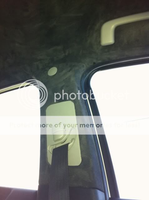

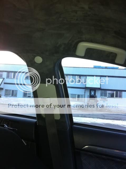

Looks good ... mind me asking how you remove the B-pillars? Been searching for a how-to on those for a while now.

I'm not sure exactly who to call in Toronto, all it takes is yellow pages I did the entire work myself and I encourage people to do their own, its just that much more fun, unless you don't have an entire week end yourself. the cost was a little over 100$
To remove the be piller and install suede you NEED 3M supper 77 glue (canadian tire), suede from fabric land or any place that sells it. I purchased double sided suede, its more durable. And obviously this is NOT real suede or it would really cost you an arm and a leg. and a really sharp blade.
1. - you got to pop that circular piece on the top, There is a 10mm bolt.
2. - the bottom of the b pillar pry's off and there is 2 bolts holding it down.
3. - lay your your piece and spray it with super 77 and work your magic.
