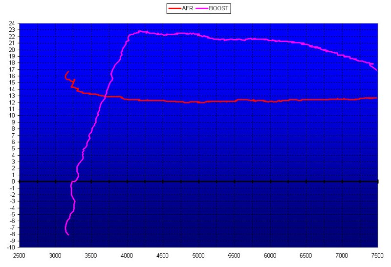

I installed a ceramic coated header and my AFRs leaned out. I guess my 93 oct custom tune went out the door...

I used Shiv's methanol map thread tutorial to richen the map, added 4% fuel from 6k to red line and 3% from 4k to 5.5k.
How does it look?

Looks good man. 11.5:1 at redline right?

right on 11.5 from 6700 to 7500 in third, fourth goes to 11.1~10.9

Shiv, you think I can get away adding .3 deg timing to my map since I added 4% to MAF ?
More than likely, yes. You could probably add as much as 1.0 degree but a good dyno (or even road dyno) would be necessary to ensure no knock retard.

I'm splitting hairs here, but what would be a target AFR at peak torque (5k ) 11.8 or 11.5?
