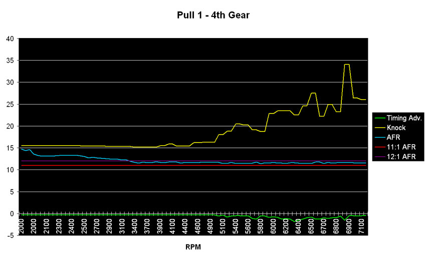

Got the XEDE and SMART installed and running today, thought i'd post a graph to see if anyone has any comments.
Completely stock 05 MR, and i used the baseline map off Vishnu's website to copy over all the values.
Does it look ok?

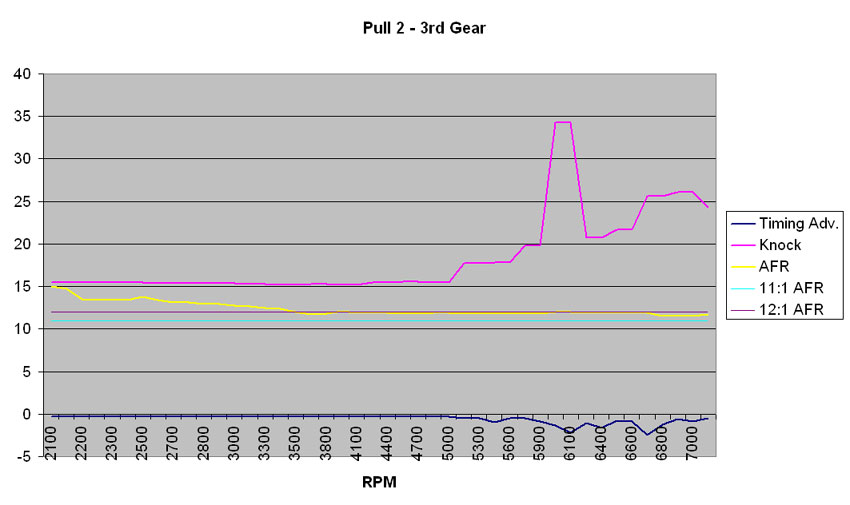

Here's my second one, it looks like the AFR was a little higher this run. I was also in 3rd gear instead of 4th.
Does this one look ok? the AFR is around 11.9 when it looks like its behind the 12:1 line.

Looks like a few obvious knock events, but you can also see where the timing was pulled immediatly afterwards, I do not know if that was the stock ECU of the SMART Xede though. Can you post the data tables? It is the far right tab under the third step of the graphing option, I just want to see it compared to mine.

Thats the Xede being proactive. Looks like small timing changes instead of the huge crazyness of the stocker it still might be good to give it two clicks of fuel right there.

Lastly.....I dont see smart being proactive at all......I see it as being reactive but not quite as strict as stock. Has anyone logged SMART pulling timing before a suspected knock event?
