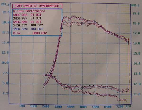

Guess what this is and how it is significant?

hint: it is oem and it makes gas leave the fuel tank

Low tapering boost. Stock 16G with a 9.8 hotside back in the day.
The run numbers are low, so I'd say you were a stage zero or one? Crappy 60'.

Modifications: Vishnu Stage 1. Full exhaust WITH cat, Xede, cam gears set at -5, full weight. STOCK FUEL PUMP.

No way that was with the stock fuel pump. Your motor would have had a catastrophic event .

Stage 1+ at altitude is when the stocker starts needing to be upgraded AFAIK. You were on stock cams at sea level, yes? OEM pump can handle that with ease IMO.

Sorry, when I say sea level, I mean not great altitude, like in CO or someplace where the air is more thin like 3500' plus where you could overrun the stock pump easier. Our track is at 480' here, and nowhere near of overrunning the stock pump with a stage 1 car.

That's unpossible!1!!! Everyone knows the stock fuel pump shoots to 12.1+ AFR up top!
