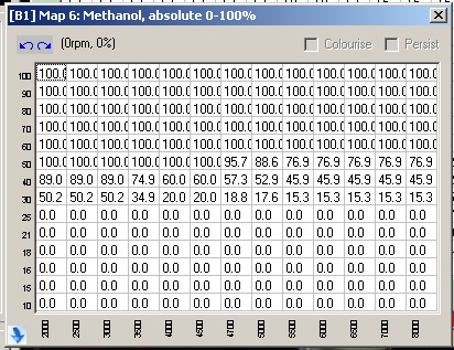

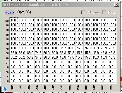

I fixed my transitional lean condition...
I fixed the problem I was having as described above...
Before:
After:
It was that simple. I was able to lower the lean run threshold to 600ms and still no fuel cut. I'm happy again...
- Steve
