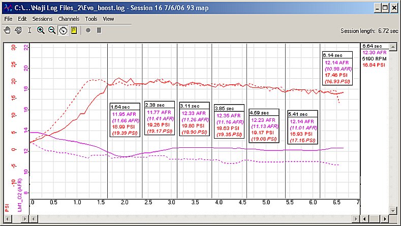

I do not think it is the boost. I overlayed one of my 91 octane runs and the one 93 run that I did. The dotted line is my 91 octane run and the numbers are in brackets.

Probably just your filter, put the stock one back in. The base map your running was set using the oem filter. I know your afr's were good on 91 octane, but just give it a try it only takes a minute. A few years ago Shiv tuned my car in Portland when I made the mistake of using a Ralliart filter and not bringing my stock one with. He had a difficult time adjusting everything for it I remember. Next time around with the oem filter, I had much better luck.

My back to back testing on the stock filter vs hks drop in also shows the the AFR leans out with the drop in.
