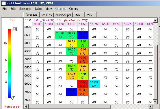

OK, I swapped to the stock panel filter, disconnected the battery for a while to reset the ECU and did two more logs.
At least on my car the, swapping to a stock filter from a K&N did not make much of a difference. The maps are still lean. Here are the two logs and the table that sums up the two logs. Most of the data points ar in the 12+ AFR. The maps are lean regardless of the panel filter.
First log
Second log
Sum of both logs
I am going to load the modified map where I added 4% to the fuel table than I will do another log and post the results.
As things stand the off-the-shelf 93 octane map runs lean on my car. The 91 octane map should be the same as far as the AFR.
Attached Thumbnails Isn't That Lean?-afr_shiv_3.jpg   Isn't That Lean?-afr_shiv_4.jpg   Isn't That Lean?-afr_shiv_5.jpg

OK, here is what I did. I kept the stock filter since it did not make much of a difference. I added 4% fuel to the fuel table of the map. I zeroed out load points 15 and 20 since they became positive after I added 4%. I believe these loads are for cruising and will not cause harm or have any virtue.
I went out and did a couple of logs. Here they are.
Log one +4% fuel
Log two +4% fuel
Sum of both logs
I am happy to say that this Xede stuff works. This is my FIRST ever attempt at tuning and I like it
Should I keep the maps like this or should I add more fuel? This is on 93 octane mix that I create by mixing about 3.5 gallons of 100 octane and 9.5-10 gallons of 91 octane.
I am also thinking of adding more boost up top. I do not like the way the boost tapers below 17. I can live with a taper to 17.5, but below that is too much taper IMO.
What is the percentage offset to add 1 psi of boost?
Attached Thumbnails Isn't That Lean?-afr_shiv_6.jpg   Isn't That Lean?-afr_shiv_7.jpg   Isn't That Lean?-afr_shiv_8.jpg   Isn't That Lean?-boost_shiv_1.jpg

Those logs looks alot better. The first log in this series looks the best. I feel most secure running 11.2.
Basically I don't believe bringing the boost table above
100 does much good. (not sure)
According to the link below they have an inline bleeder that
raises the boost by 3 or 4 psi.
Here's a sticky from Shiv himself.
https://www.evolutionm.net/forums/sh...d.php?t=135901
I'm new to tuning myself and feel the Xede is good to learn with, because
it's not like flashing the ECU over and over.
I bought the tactrix ECU + table, so I can remove the revlimit and other un-desireable features in the factory program.
Questions: Where is your wideband O2 sensor installed ?
What BOV are you running ?

So you think 11.4-11.5 is still too lean on 93 octane gas.
The boost tables on Shiv's maps are not set to 100% on the high end. I think setting them to 100% will do the trick of reducing the taper to 17 only. On my 91 octane custom map the table is at 100% from 6000 rpm to cutoff.
I like the Xede because I can keep a virgin ECU and the dealer cannot detect it if I remove it.
I installed my O2 sensor in the middle of the downpipe about 18-20 inches from the O2 housing. But that is NOT the ideal position. Place yours right at the end of the downpipe before the cat in the 2-3 o'clock position. that is what Shiv does.
I am running a JDM DV. It is the same one for the EVO IX.

11.4-11.5 is probably ok, I just don't want you to hurt your motor.
Without monitor EGT or knock I would stay on the safe side towards 11.2.
Especially in this heat. That's just my opinion and what I would do if it was
my car.
Your setup is very similar to mine and I bet my car is on the lean side.

I will add 1-2% more of fuel and that should bring it down more. I am also logging timing with my pocket logger and did not notice any serious timing pull to indicate knock. This was my last run:

If you are using off-the-shelf maps, then more than likely you are running lean.

You can add more fuel or run a couple more gallons of 100.
Either way should give you a margin of safety.
