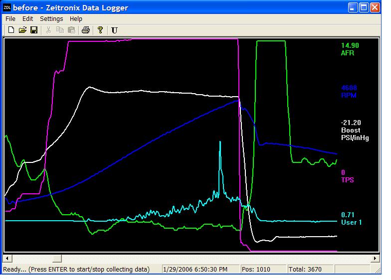

here is some supposed knock. the noise floor was from .75 to 1.30 volts, with the spike going to 3.00 volts

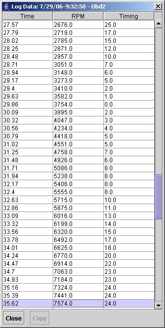

This is my latest version of the 93 octane map that came from Shiv's website. I added 3% fuel (rather than 4% in the previous map) and backed off the timing, just like Klaus said. The timing log has a 1* pull in one place only. According to Dustin, that is very ok. But I am still getting 24* advance deep deep into redline. Maybe I just should not push so deep into redline.
The boost peaked at 22.44 psi even though it is summer is around 18 psi by redline. There were no spikes in the knock voltage and a max of 1.20 volts registered at 7200 rpm. I did the pull on the same ramp at around the same time.
The car fellt great during the pull. I think that is the map that I will keep. I will do some more logs on this maps to see if it is consistent.
AFR, RPM, Boost and knock voltage.
Timing

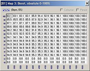

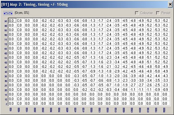

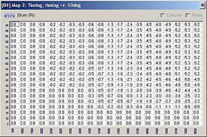

Here is the map in a zip file. If you have Xmap you should be able to open it. No I have not tried logging on a flat surface. I know it should be a flat surface, but there is not a place next to me where I can do that. But you are right I should try and find a flat sruface to log at. Damned urban area.
I run a totally stock ECU and xede. Check the map and comment on it. I would appreciate your input.

Here they are. PM your impressions. I would really like to know what I should do to reduce 7-7.5k timing below 24. I want it to be at 22.
