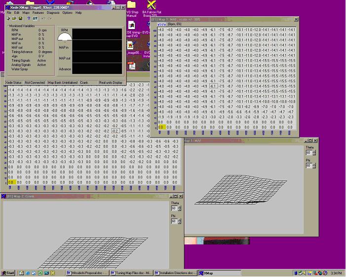

What does the actually tuning interface on a laptop look like? Any pictures, and also, how confusing is using the XEDE?? I am hoping to get one during the next Dyno4mance Dyno day in October.

If you picture a digital equalizer, that is what our tuning interface looks like. Just make the curve look pretty and you'll make gobs of power....

There are a few screenshots here (not the main screen though ) ... http://www.vishnutuning.com/files/ev..._Map_Files.doc
You could also try www.chiptorque.com.au and see if they have any screenshots of the XMap software.
l8r)
Old Sep 16, 2004 | 04:13 PM
ez76's Avatar
Posts: 1,332
From: bay area
This file has screen shots and instructions:
e.g.

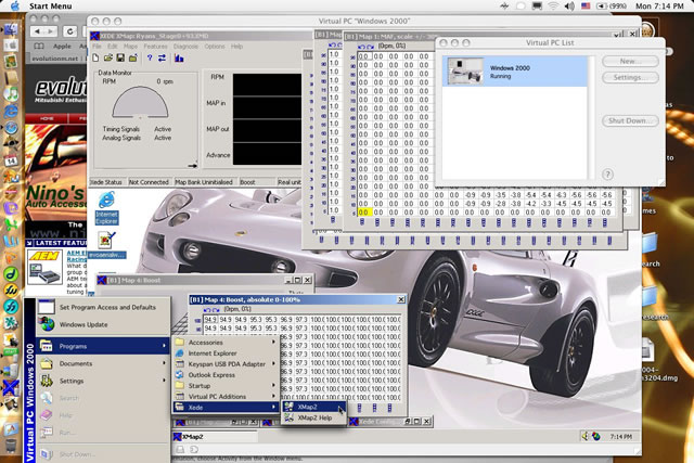

Does any of this stuff work on a mac by any chance?
Old Sep 16, 2004 | 08:28 PM
n00dle's Avatar
Posts: 788
With VirtualPC.
https://www.evolutionm.net/forums/sh...light=xede+mac
I also run it on a mac. Its very important to get a good usb to serial adapter though. I run a keyspan. It was a little more expensive but the cheap targus one didn't work at all.
