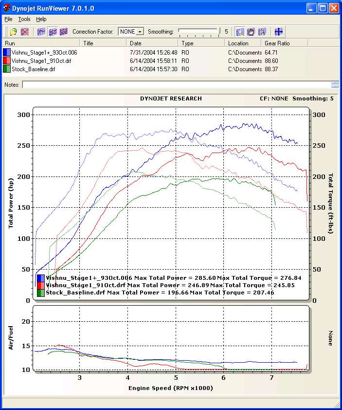

Originally Posted by johnnysixer
how much of a power increase are you getting out of the cam upgrade?
Here's a combo of my 3 dyno sessions... What you're basically looking at is stock vs Vishnu stage 1 vs Vishnu stage 1+. However, keep in mind that the Stage 1 dyno pull was done on 91 Octane and in CO, whereas the Stage 1+ (272 cams) pull was done in Chicago with 93 Octane.
Going by the ole butt dyno, however, there is noticeable improvement after 5000rpm until redline. Even with a stage 1 (stock cams) tuned to 93 Octane, the car would start to run out of steam past 6K or so. Now it pulls very hard past 7K, with peak torque at just below 5000rpm

Old Sep 19, 2004 | 09:35 PM
Ted B's Avatar
Posts: 6,334
Likes: 63
From: Birmingham, AL
Great graph - wow, what an increase in power.
Question: Was this Stage 1+ run done with the 272 cams timed as you indicated above (-4/-1)?
Yep.

Old Sep 20, 2004 | 05:49 AM
Ted B's Avatar
Posts: 6,334
Likes: 63
If this is the case, then it is significant where cam timing is concerned. I don't have the stock cam timing events, but here are the overlap settings (at 1mm) for HKS cam combinations:
HKS 264 set (9 deg)
HKS 264/272 (13 deg)
HKS 272 set (17)
HKS 272 set at -4/-1 (14 deg)
So basically, with the above cam timing, the 272 gives roughly the same overlap (one degree more) as the 272/264 combination. This setting must be significant, as even as low as 2000rpm, it looks to give some 30 ft/lbs greater than the stock configuration, and this figure jumps to an 80 ft/lb difference as low as 3000rpm.
This leaves me with little doubt that the -4/-1 setting is THE ticket to running the HKS 272 cam set on the street.
